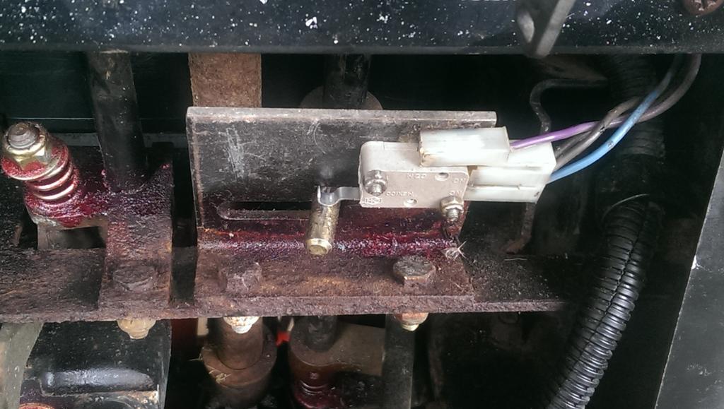

WVHillbilly520H 10,378 #7 Posted February 27, 2019 The first used one I bought had the same problem, it was the neutral safety switch under the steering wheel...the actuator tang had corroded and broken off technically the switch was "working" just not being "made" pics before and after...good luck Jeff. Share this post Link to post Share on other sites
