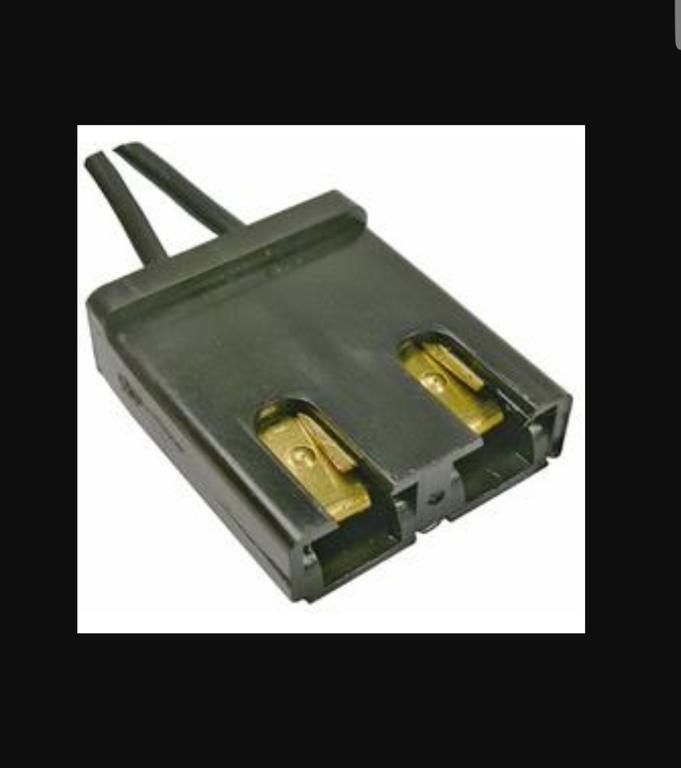

The Wheel Horse Lady 5 #1 Posted February 25, 2019 (edited) Hello all. Does anybody have a source for the plastic connector and terminals that fit on the clutch pedal safety switch part number 101845? It looks like the picture I have attached. I'm making my own wiring harness' and would like to be able to incorporate this connector into the harness that way I won't have any splices in it. Thanks, The Wheel Horse Lady Edited February 25, 2019 by The Wheel Horse Lady 1 Share this post Link to post Share on other sites
classiccat 548 #2 Posted February 25, 2019 I was looking for the same thing. With a little persuasion, I was able to fit a regular spade terminals over the individual studs and punch a little dimple to hold it in place. it's fairly secure. If there's a second source for this connector, that would be solid! 1 Share this post Link to post Share on other sites
The Tuul Crib 7,340 #3 Posted February 25, 2019 Any single connector should work if you can't find the double. I'm not sure on any part numbers to 1 Share this post Link to post Share on other sites
The Wheel Horse Lady 5 #4 Posted February 25, 2019 (edited) Thanks guys. Yes I know a single terminal will work on each post of the switch....but I'm looking for the double terminal plastic connector. Thanks. Edited February 25, 2019 by The Wheel Horse Lady 1 Share this post Link to post Share on other sites
gwest_ca-(File Mod) 11,990 #5 Posted February 25, 2019 If you have the original connector you can release the terminals and insert new ones. The original WH number was 106024 but no longer available from Toro. Found it here http://terminalsupplyco.com/Store/Default.aspx?CATDRILL=DEL010&PCAT=54228#Categories Part number 2973407 about half way down the page. This same style of switch was used by GM and I believe Chrysler or Jeep in the past so that should be another source. Garry 2 Share this post Link to post Share on other sites
cafoose 3,578 #6 Posted February 25, 2019 Check this out: https://www.amazon.com/Automotive-Connectors-FEMALE-BLACK-piece/dp/B00HKTMXQS/ref=sr_1_1?ie=UTF8&qid=1551119637&sr=8-1&keywords=2973407+delphi 16-14 gauge: https://www.amazon.com/Delphi-2965867-Metri-Pack-Female-Terminal/dp/B06WGL18JT/ref=sr_1_3?ie=UTF8&qid=1551119546&sr=8-3&keywords=packard+56+series+terminals 12 gauge: https://www.amazon.com/Packard-Female-Gauge-Terminals-2989877/dp/B00B460HHK/ref=sr_1_1?ie=UTF8&qid=1551119546&sr=8-1&keywords=packard+56+series+terminals 1 2 Share this post Link to post Share on other sites
classiccat 548 #7 Posted February 25, 2019 4 hours ago, cafoose said: Check this out: https://www.amazon.com/Automotive-Connectors-FEMALE-BLACK-piece/dp/B00HKTMXQS/ref=sr_1_1?ie=UTF8&qid=1551119637&sr=8-1&keywords=2973407+delphi 16-14 gauge: https://www.amazon.com/Delphi-2965867-Metri-Pack-Female-Terminal/dp/B06WGL18JT/ref=sr_1_3?ie=UTF8&qid=1551119546&sr=8-3&keywords=packard+56+series+terminals 12 gauge: https://www.amazon.com/Packard-Female-Gauge-Terminals-2989877/dp/B00B460HHK/ref=sr_1_1?ie=UTF8&qid=1551119546&sr=8-1&keywords=packard+56+series+terminals I believe this is the link on Mouser: https://www.mouser.com/ProductDetail/Aptiv-formerly-Delphi/02973407-B?qs=sGAEpiMZZMtL3B7sVozNt9lxIskJIpKm 1 Share this post Link to post Share on other sites
The Wheel Horse Lady 5 #8 Posted February 25, 2019 That looks like that's it! Thanks everybody!!!! I figured somebody had to be making them because like you said Garry, Jeep used that same style switch. 2 Share this post Link to post Share on other sites
