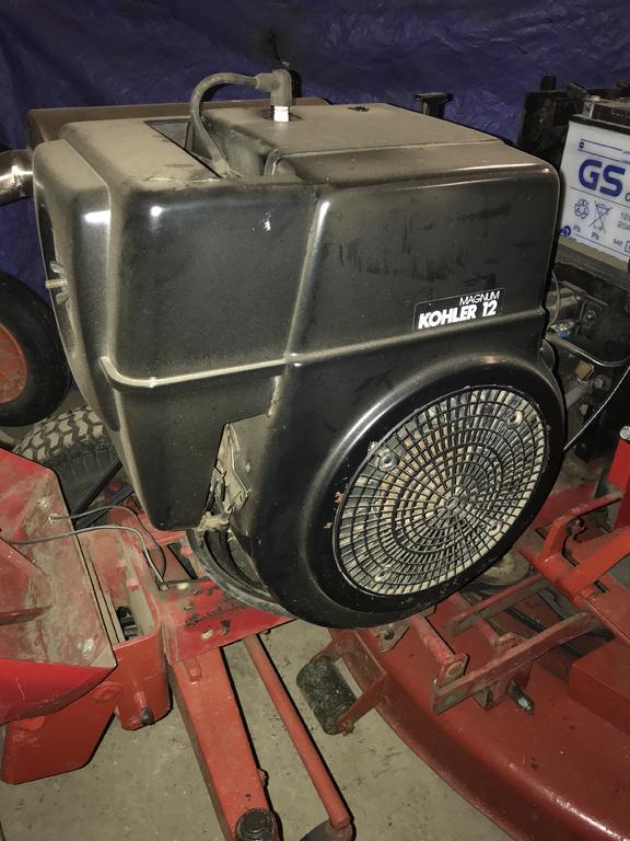

Lee1977 7,638 #26 Posted February 21, 2019 Witch engine do you have a Magnum or a K-Series. 1985 and 1986 had a K-series, and 1987 up had Magnums. Share this post Link to post Share on other sites

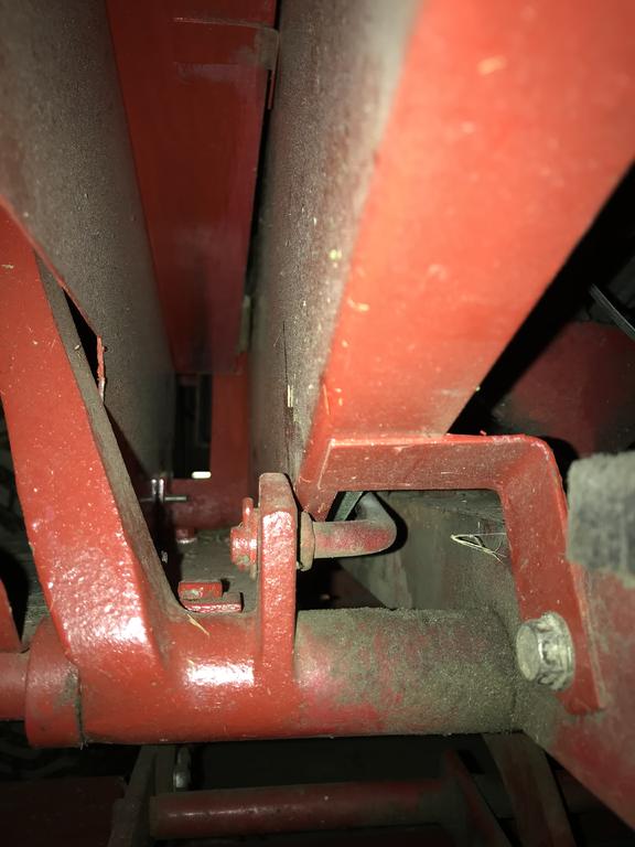

Kasweld 7 #28 Posted February 22, 2019 More pics of the extre wide guard Share this post Link to post Share on other sites

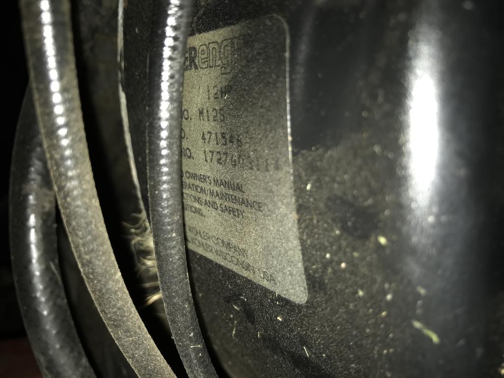

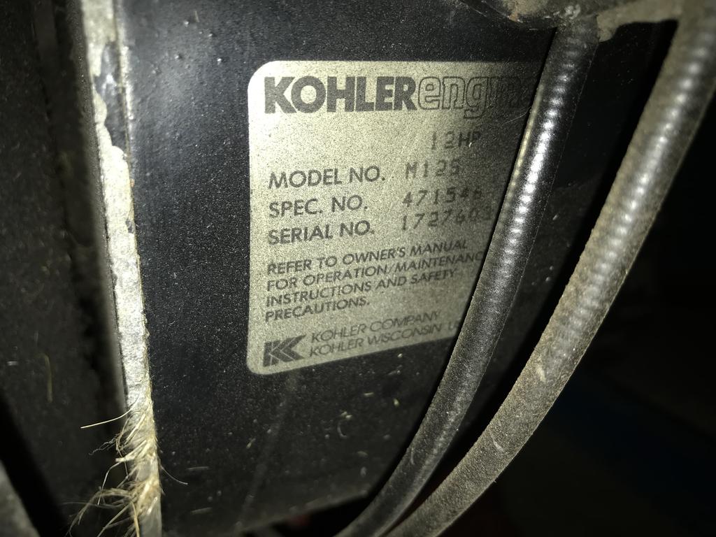

Kasweld 7 #30 Posted February 22, 2019 And here is the engine number Share this post Link to post Share on other sites
gwest_ca-(File Mod) 12,276 #31 Posted February 22, 2019 Kohler built your engine in 1987 so the tractor should be a 1988 model number E1-12K801. Click on the picture. Garry 1 Share this post Link to post Share on other sites
Ed Kennell 46,203 #32 Posted February 22, 2019 (edited) S/N 17------- is a 1987 built engine. Oops, Garry types faster than me. Edited February 22, 2019 by Ed Kennell 1 Share this post Link to post Share on other sites
Kasweld 7 #33 Posted February 22, 2019 Thanks that helps a lot 👍👍 Share this post Link to post Share on other sites
953 nut 66,586 #34 Posted February 22, 2019 You may want to remove the engine covers, looks like there is some grass accumulation there. That could lead to overheating. Share this post Link to post Share on other sites

Kasweld 7 #36 Posted February 22, 2019 1 hour ago, 953 nut said: You may want to remove the engine covers, looks like there is some grass accumulation there. That could lead to overheating. Will do, always give it a good service and clean out before new season thanks 1 Share this post Link to post Share on other sites
