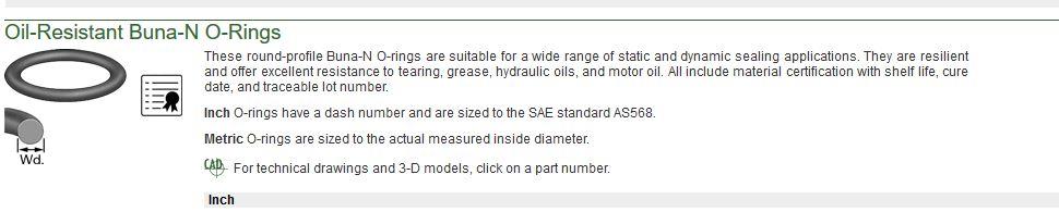

gt14rider 968 #1 Posted February 20, 2019 Hi all, restoring my 1970 GT14, I'm working on the transmission 90-2062, read pfrederi (sunstrand o ring) write up. Thanks for the dash # conversion. Anyway, went on line and there are a lot of o ring materials, silicone, viton, epdm, buna n which is the best one to use? Any help would be greatly appreciated. Share this post Link to post Share on other sites

pfrederi 19,089 #4 Posted February 20, 2019 Viton is probably best but more expensive. i do not have any issues with Buna-n Share this post Link to post Share on other sites
