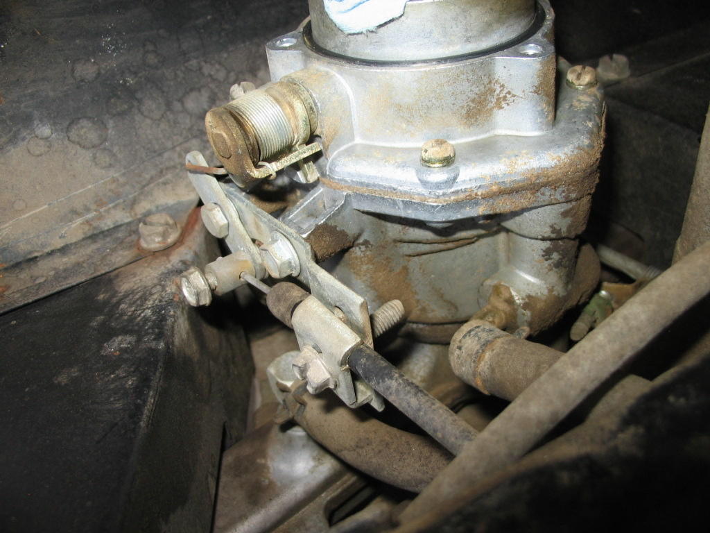

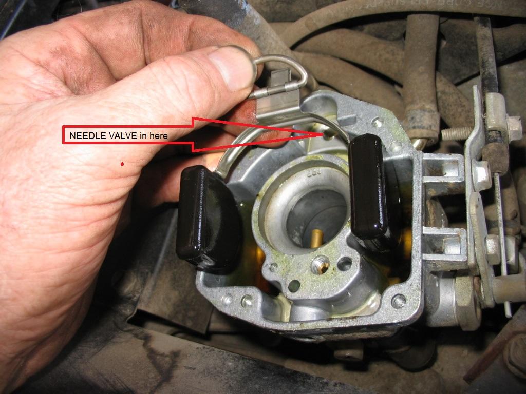

daveoman1966 3,881 #7 Posted February 20, 2019 Take the top off of carb and THOROUGHLY clean it out with carb cleaner and air blast. Caution on this needle valve.. Befor you take the top off, get a few pics of how all the linkages and such fit together. 1 1 Share this post Link to post Share on other sites

Reel Mower Freak 125 #10 Posted February 20, 2019 9 hours ago, daveoman1966 said: Take the top off of carb and THOROUGHLY clean it out with carb cleaner and air blast. Caution on this needle valve.. Befor you take the top off, get a few pics of how all the linkages and such fit together. When reassembling the carb, how does the needle valve go back in? Great pics for those of us with surging issues. Thanks. Share this post Link to post Share on other sites
