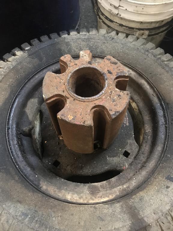

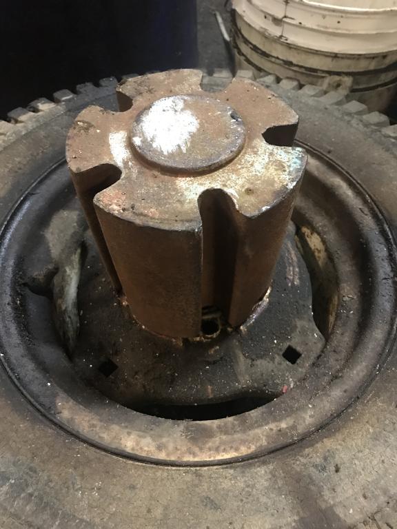

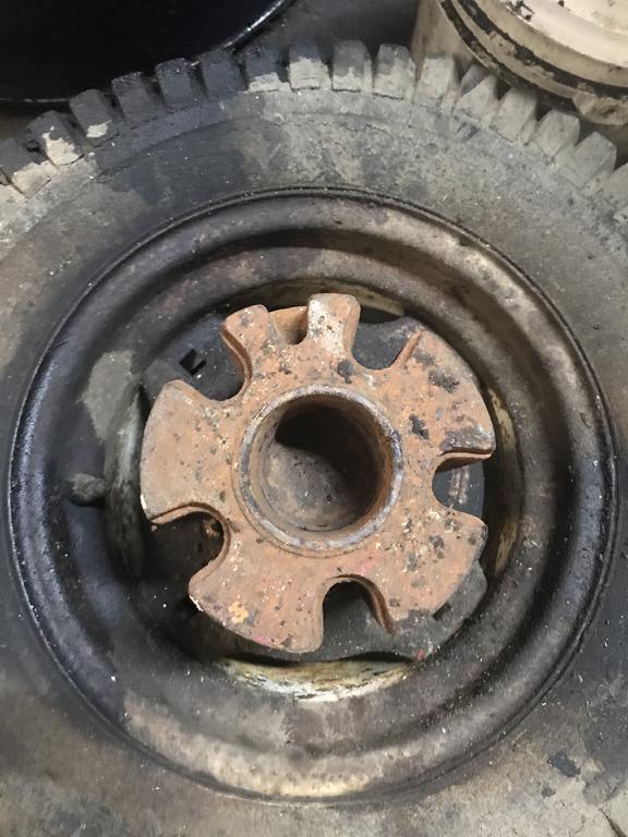

Wheelhorsenut#1 103 #1 Posted February 19, 2019 (edited) So I picked up a pair of dual wheel spacers the other day and someone asked what brand they are and it got me wondering as well. So I was wondering if anyone could tell me anything about them. And they weigh about 25-30 lbs each. And they are 6” long. Edited February 19, 2019 by Wheelhorsenut#1 6 Share this post Link to post Share on other sites
WHX?? 55,224 #2 Posted February 19, 2019 Interesting indeed. Spacers with weight built in. Must be other brands and appears to be self centering? Looks like you would need long 7/16 lugs to mount them up??? Share this post Link to post Share on other sites
Wheelhorsenut#1 103 #3 Posted February 19, 2019 Yeah something like that Share this post Link to post Share on other sites
JoeM 9,646 #4 Posted February 19, 2019 NOW THAT IS A SPACER! 2 1 Share this post Link to post Share on other sites

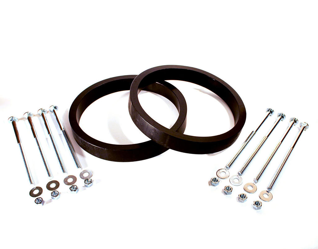

bc.gold 3,406 #5 Posted February 20, 2019 (edited) I could be wrong in my thinking but I really think those extra long wheel studs are going to be a huge problem keeping them snugged up, personally I would go with something like the one below. I know your not traveling at highway speeds but I'm willing to bet that 90 percent of wheel that have some loose to highway trucks and trailers were Dayton, the most horrible wheel rim in the world. Improperly tightened they have been known to spin on the drivers. The DOT made them illegal to use on mobile home axles for a reason. Edited February 20, 2019 by bcgold 1 Share this post Link to post Share on other sites

diesel cowboy 263 #13 Posted February 22, 2019 Pretty sure those are for a Panzer. Don't think I've ever seen a set for sale before without a tractor attached to them. They look like one of the sets shown here: https://gardentractortalk.com/forums/topic/59867-dually-conversion/ Share this post Link to post Share on other sites
WHX?? 55,224 #14 Posted February 22, 2019 (edited) Think you nailed it Diesel.. thanks.. Edited February 22, 2019 by WHX22 Share this post Link to post Share on other sites
