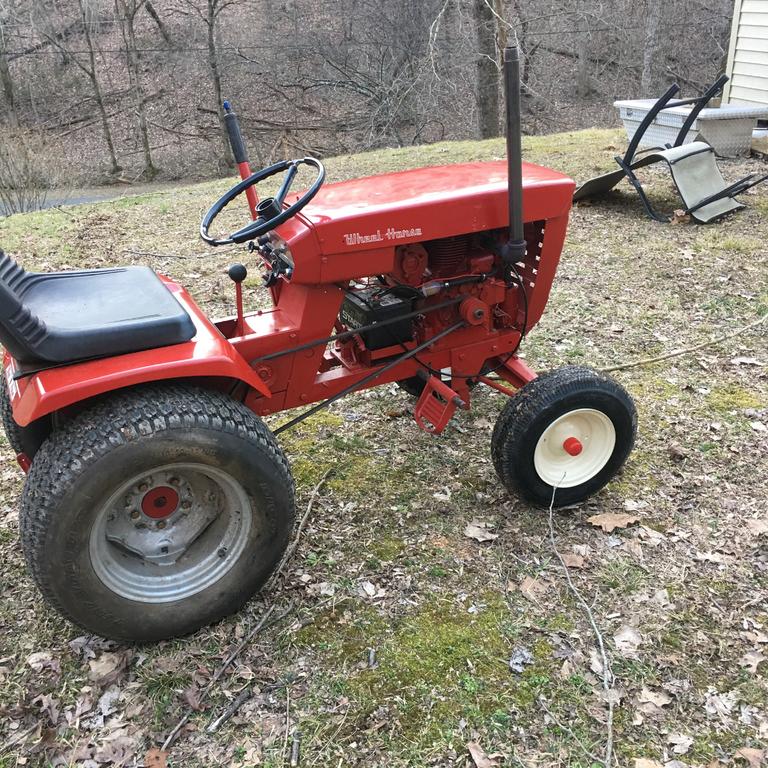

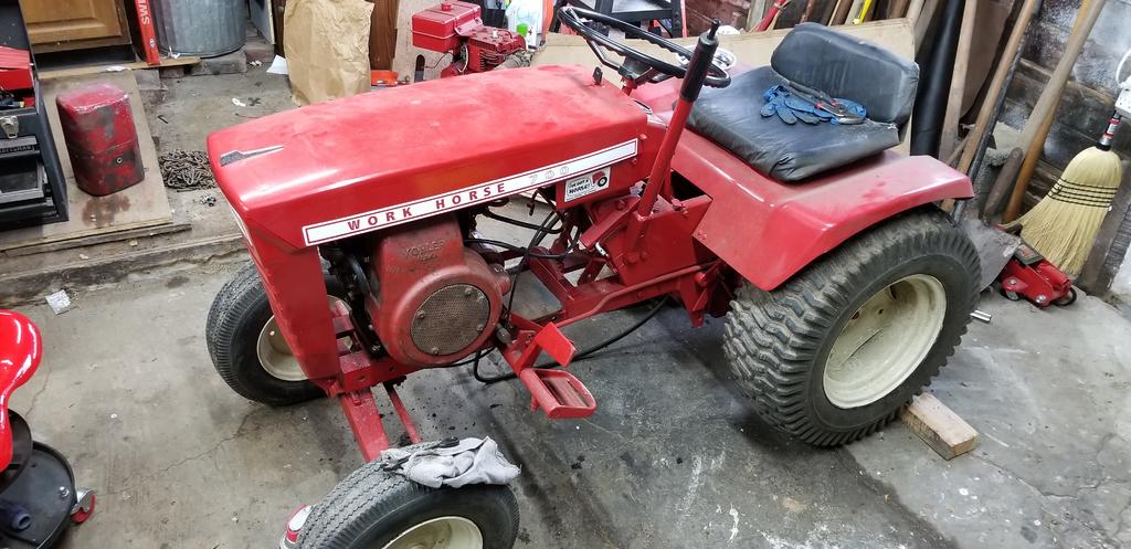

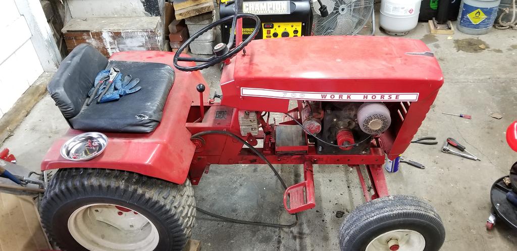

Mike'sHorseBarn 3,417 #1 Posted February 18, 2019 I've been wanting to do this for years and finally this project got closer to the top of the list! This 700 belonged to my grandfather and the 7hp tecumseh engine in it never ran right and I got so sick of messing with it that I put it in the shed and there it sat for probably 10 years or so. Got this 8hp kohler about a week ago and started working on it today. Didn't get it all finished but its moving right along. The Kohler needed a little attention that kept me from getting it totally finished up in one day. A regular garden tractor battery won't fit, but I think I'll just use an ATV battery. 3 Share this post Link to post Share on other sites

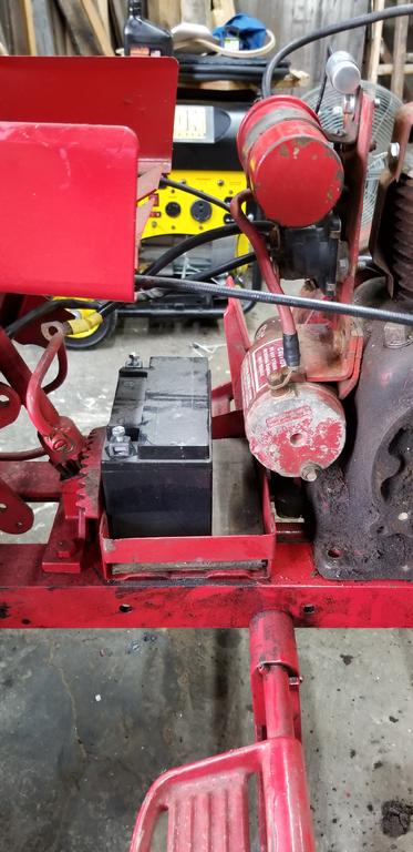

WHNJ701 4,168 #3 Posted February 18, 2019 I have been using these, this came out of a booster box. 7"x3"x7" 1 Share this post Link to post Share on other sites
Mike'sHorseBarn 3,417 #4 Posted February 19, 2019 Been looking into atv batteries and they are darn expensive! Share this post Link to post Share on other sites

Shynon 7,533 #7 Posted February 19, 2019 I used a small motorcycle battery on a lawn ranger I had with an 8hp kohler. About $50 at Fleet Farm Share this post Link to post Share on other sites
Mike'sHorseBarn 3,417 #8 Posted February 19, 2019 1 hour ago, Shynon said: I used a small motorcycle battery on a lawn ranger I had with an 8hp kohler. About $50 at Fleet Farm What size though? I'm not familiar with all the atv battery classes and they don't all give you the cranking amps. Share this post Link to post Share on other sites

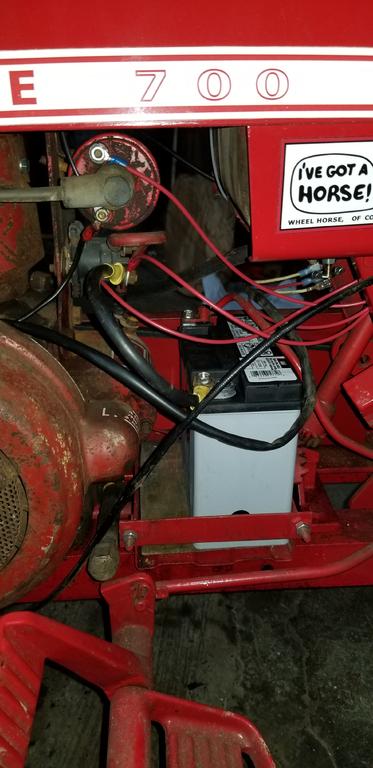

Mike'sHorseBarn 3,417 #10 Posted February 26, 2019 Got it all swapped over finally! Used a motorcycle battery (not cheap by the way) and she runs pretty good! 20190225_182922.mp4 2 Share this post Link to post Share on other sites
