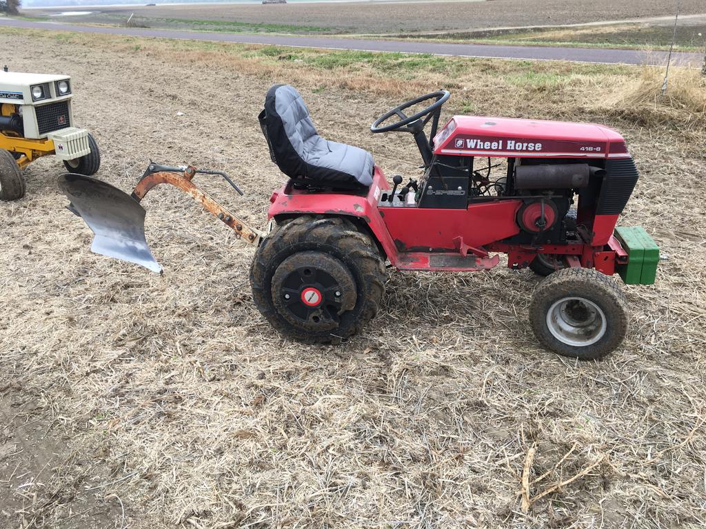

T-Mo-(Moderator) 4,690 #5 Posted February 15, 2019 Here are Sears 55 lb wheel weights that I put on both a 702 and a 416-8. If the rims are shallow, the weights may stick out a bit. If the rims are deeper, then the weights will still fit, but you will need longer bolts. Either way, they will fit. BTW, the 702 has narrow 6 in width rims and my 416-8 has 8.5 inch width rims. A 520 should have 10.5 inch wide rims, so longer bolts will be needed. 4 1 Share this post Link to post Share on other sites

WHX?? 53,357 #13 Posted February 16, 2019 (edited) 8 hours ago, T-Mo said: Here are Sears 55 lb wheel weights that I put on both a 702 and a 416-8. If the rims are shallow, the weights may stick out a bit. If the rims are deeper, then the weights will still fit, but you will need longer bolts. Either way, they will fit. BTW, the 702 has narrow 6 in width rims and my 416-8 has 8.5 inch width rims. A 520 should have 10.5 inch wide rims, so longer bolts will be needed. What's the weight on those Sears ones Terry? They look beefy... Just passed up a set like those on CL just because I found a set of the plastic WH ones on CL. BTW you do know I have a plow day?? We would even let you run the cub! Never mind just re re-read and saw the 55...Don't think the WH ones are that much tho? Edited February 16, 2019 by WHX21 Share this post Link to post Share on other sites
T-Mo-(Moderator) 4,690 #14 Posted February 16, 2019 7 hours ago, WHX21 said: What's the weight on those Sears ones Terry? They look beefy... Just passed up a set like those on CL just because I found a set of the plastic WH ones on CL. BTW you do know I have a plow day?? We would even let you run the cub! Never mind just re re-read and saw the 55...Don't think the WH ones are that much tho? I would love to come to one of your plow days, but distance is a real mood killer. I would love to bring my Cub, and if I get either the Cub Cadet 100 going, or one of my WH 953s, I would love to bring one of them also. 1 Share this post Link to post Share on other sites
