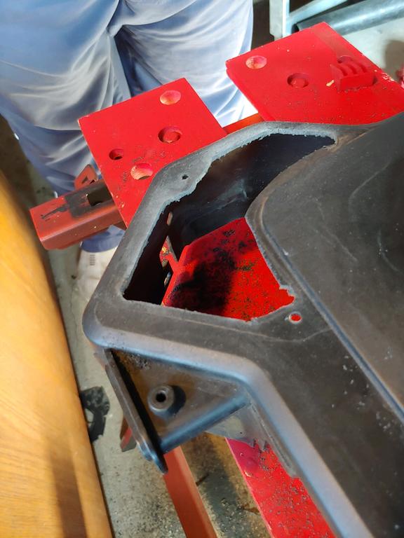

wh500special 2,275 #5 Posted February 10, 2019 (edited) 6 hours ago, lak1965 said: .... I cant seem to figure out how to remove the rear shroud to get at the coils. Does anyone know a way to do it without removing the engine? You have no choice but to remove the engine. It’s less work than it looks and you need to do it anyway so you can clean the cooling fins on the engine since it’s probably never been done. When you have it out, take the opportunity to install the Kohler kit that lets you access the cooling fins w/o removing the blower housing next time. It’s been mentioned in this forum before, so it should pop up in a search. Steve Edited February 10, 2019 by wh500special 1 Share this post Link to post Share on other sites

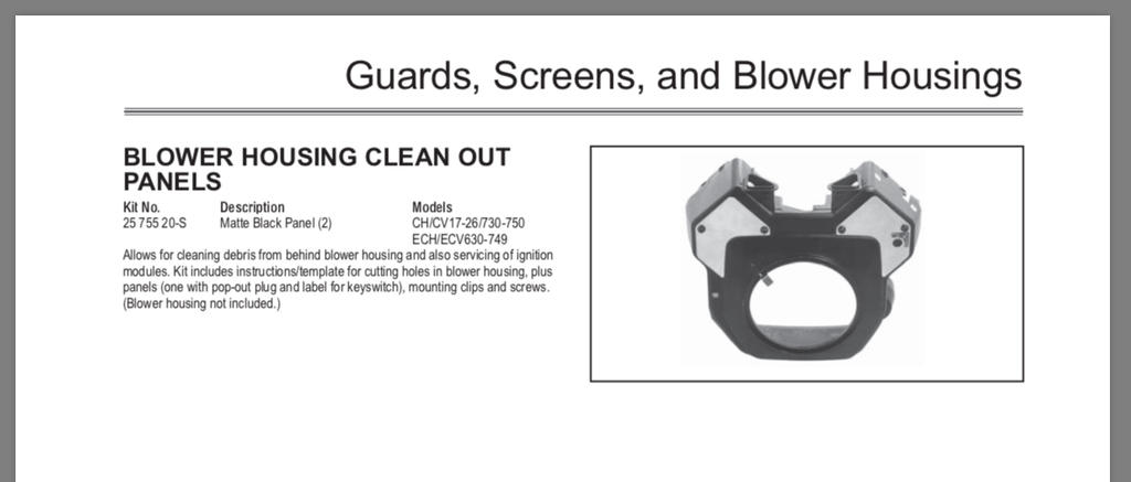

Kurt-NEPA 755 #6 Posted February 11, 2019 23 hours ago, wh500special said: When you have it out, take the opportunity to install the Kohler kit that lets you access the cooling fins w/o removing the blower housing next time. It’s been mentioned in this forum before, so it should pop up in a search. If there is a kit to allow access to clean the cooling fins, I am interested in the details. Pulling the engine to remove the shroud on a 5xi is a pain. But that is what I need to do this spring on my 522xi. Its running a bit hot. 2 Share this post Link to post Share on other sites
19richie66 17,645 #7 Posted February 11, 2019 Page 19 of this catalog.👍 http://www.kohlerengines.com/engines/onlinecatalog/pdf/parts_catalog.pdf 2 Share this post Link to post Share on other sites
Kurt-NEPA 755 #8 Posted February 11, 2019 32 minutes ago, 19richie66 said: Page 19 of this catalog.👍 http://www.kohlerengines.com/engines/onlinecatalog/pdf/parts_catalog.pdf Fantastic!!!!! I'll check that out. Thanks. 2 Share this post Link to post Share on other sites
Kurt-NEPA 755 #9 Posted February 11, 2019 3 minutes ago, Kurt-NEPA said: Fantastic!!!!! I'll check that out. Thanks. https://www.amazon.com/Kohler-25-755-20-S-Original-Equipment-Manufacturer/dp/B000P7PC1U 2 Share this post Link to post Share on other sites

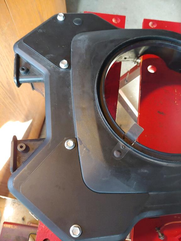

lak1965 51 #10 Posted February 12, 2019 (edited) Got the clean out panels ordered along with head gasket kits, might as well look at those heads while I'm at it. Would have been nice to have this thing running right, I have a 2 stage snow blower I bought for it for short money. Edited February 12, 2019 by lak1965 2 Share this post Link to post Share on other sites

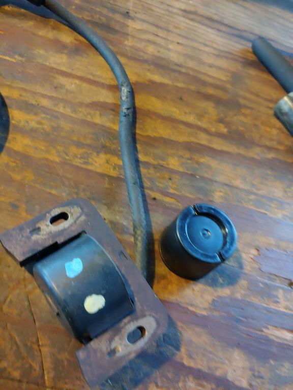

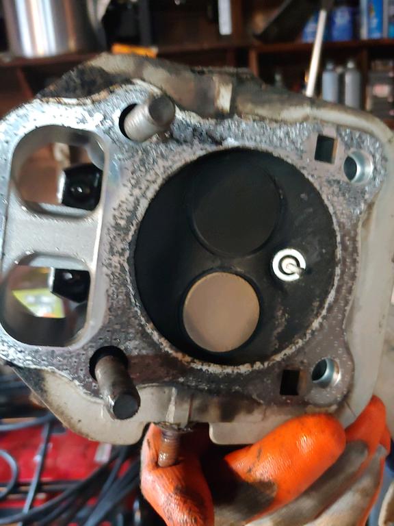

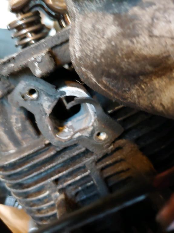

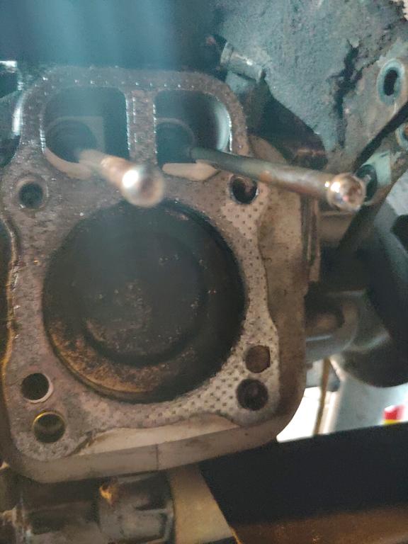

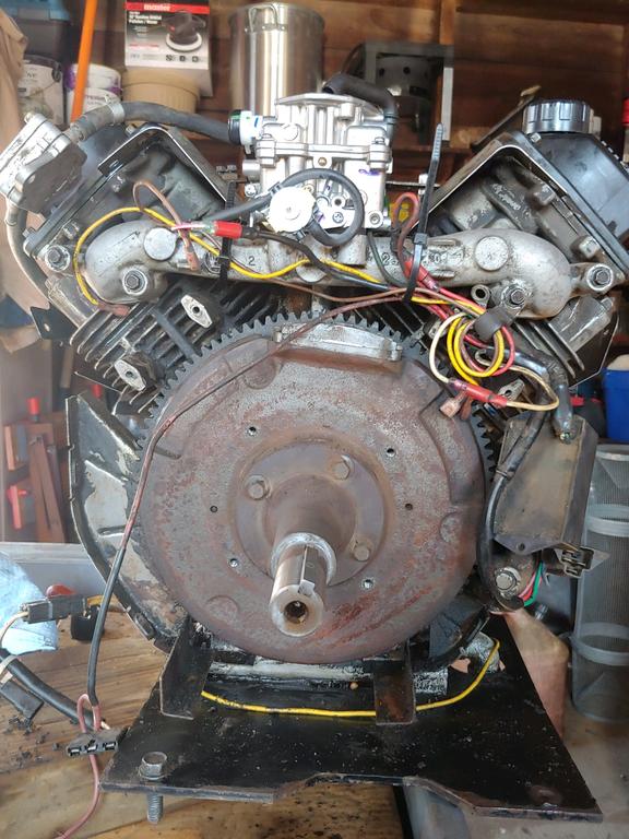

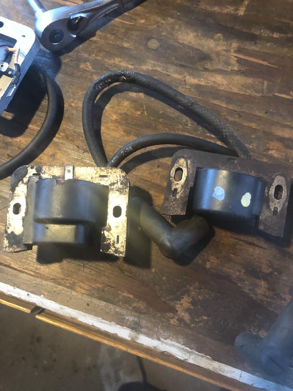

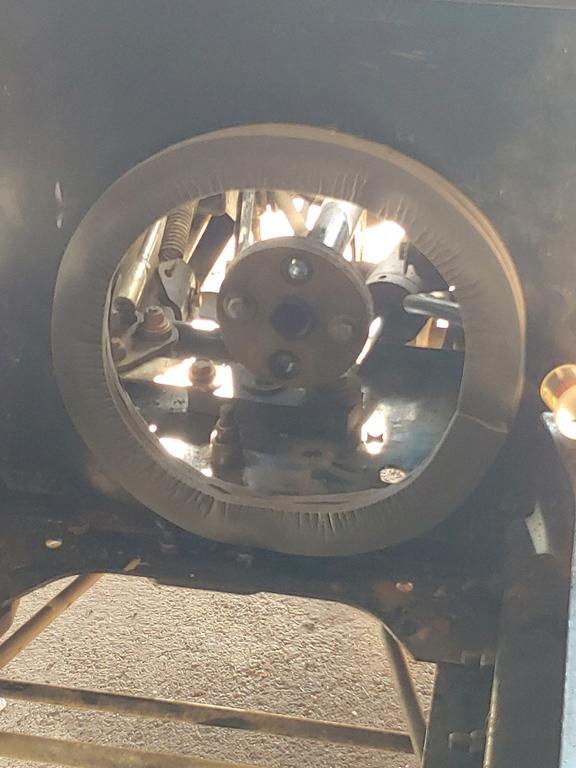

lak1965 51 #12 Posted February 17, 2019 (edited) It Appears that there are 2 different size coils in the beast. One of them, the small one, was not reading properly on the multimeter. It also has a melted coil wire someone taped over. One of the intake gaskets were torn and I think it was sucking air into one of the cylinders causing the backfiring . My brother an I also figured we would remove the heads and decarbon and inspect while the engine is out. Doesn't look too bad, some funky wiring problems that need tube fixed but a good going through and cleaning and I think will be like new. Access Panels More pics to come. Edited February 17, 2019 by lak1965 2 1 Share this post Link to post Share on other sites

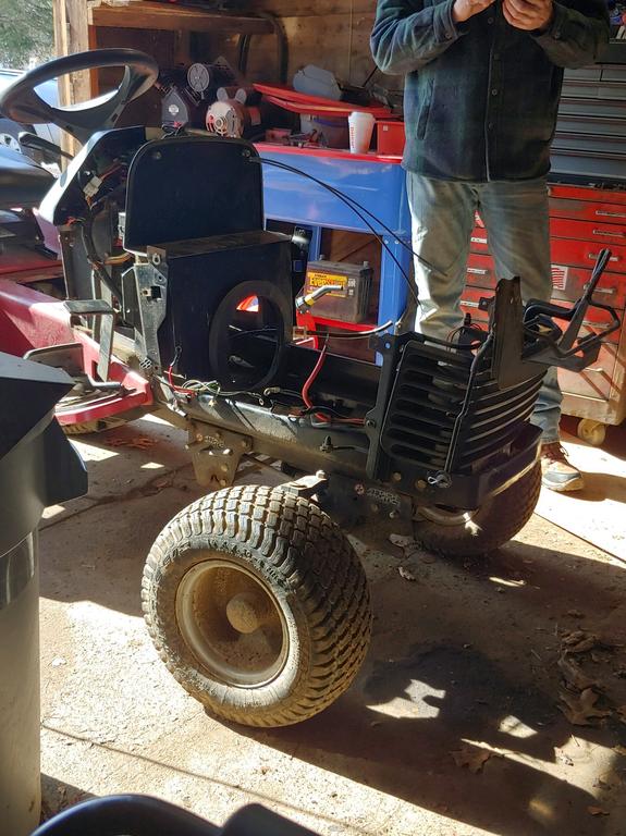

lak1965 51 #14 Posted February 17, 2019 The problem found! Access panels going on. Intake back on with intact gaskets also both heads decarboned and torqued to 30 foot pounds. Just about ready tout back in , tomorrows job. 3 1 Share this post Link to post Share on other sites

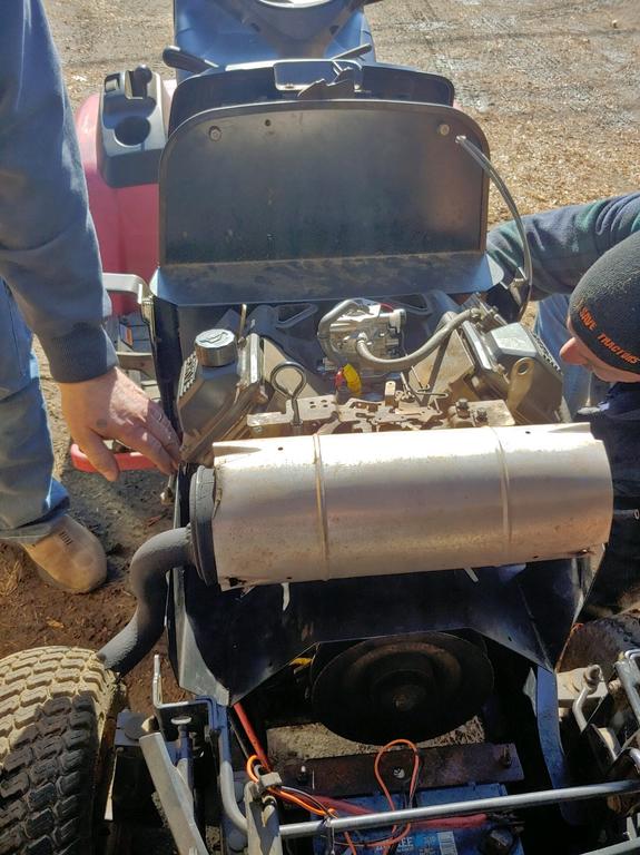

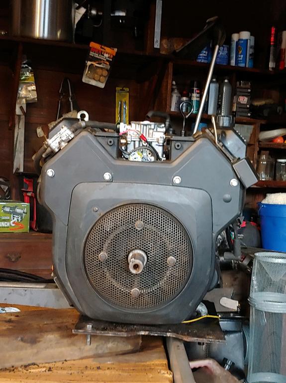

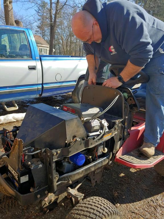

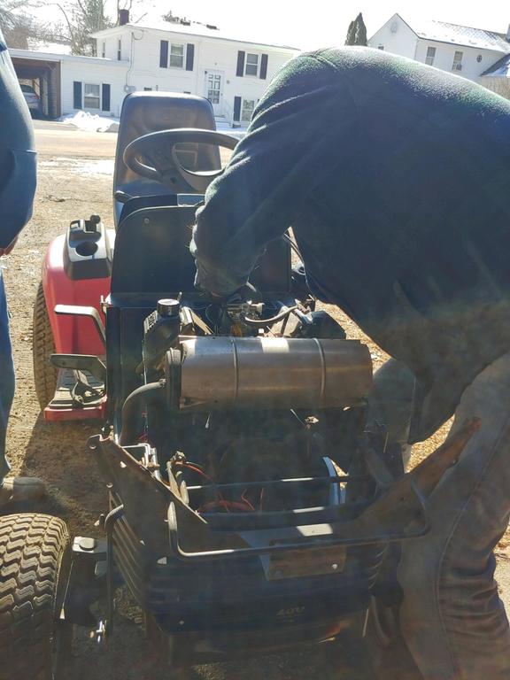

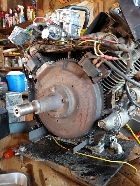

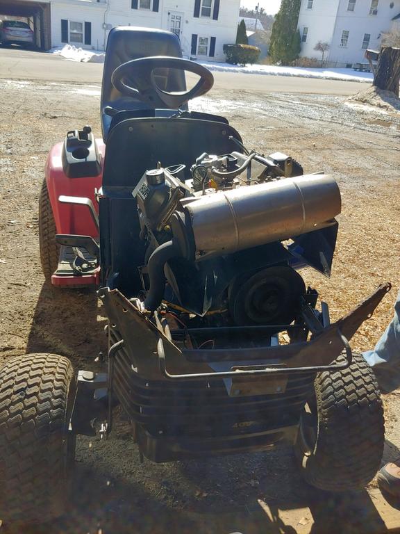

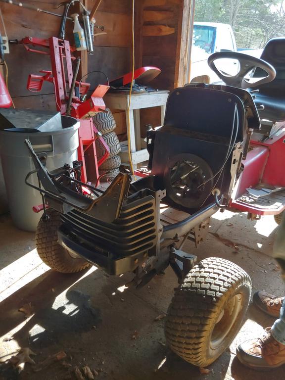

lak1965 51 #15 Posted February 22, 2019 (edited) Works like a champ now. Suspect that intake gasket and possibly head not torqued correctly causing problems. Here are some pics and videos for your viewing pleasure. Had Brian Miller come down to help get the engine back in. Balancing engine on rail while hooking wires back on. I put the muffler heat shield on backwards but it really didn't hurt anything. Also painted muffler with high temp paint. Mounting back to frame. Its alive, no backfiring. 0222191222.3gp We disconnected the steering mechanism that slows you down when you turn nut had to hook it back up. Couldn't get it go right without it. Thats me on the beast. 0222191243.3gp Thats it, now just need to find a front lens and bumper cover and I'm golden. Thanks everyone for your help and suggestions. Edited February 22, 2019 by lak1965 2 Share this post Link to post Share on other sites
