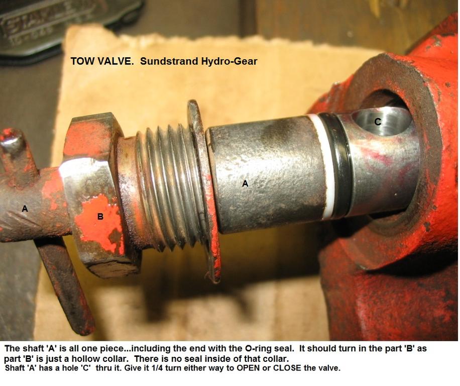

daveoman1966 3,880 #3 Posted February 9, 2019 Give this valve 1/4 turn... 3 2 Share this post Link to post Share on other sites

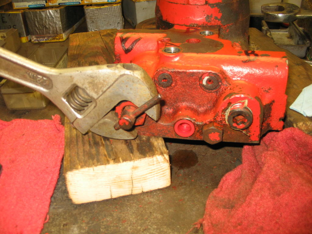

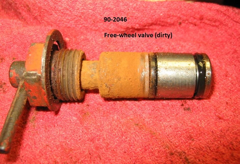

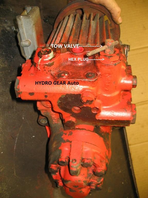

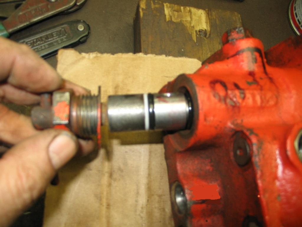

daveoman1966 3,880 #14 Posted February 17, 2019 That TOW VALVE removed looks like this. Use a crescent wrench to remove and clean it up. 1 Share this post Link to post Share on other sites

cazngz 19 #16 Posted February 17, 2019 4 minutes ago, daveoman1966 said: That TOW VALVE removed looks like this. Use a crescent wrench to remove and clean it up. That's some great photos and explanation. Becomes much easier to understand w/ photos. Thumbs up 1 Share this post Link to post Share on other sites
