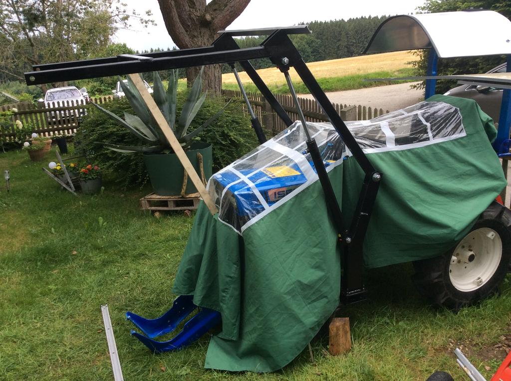

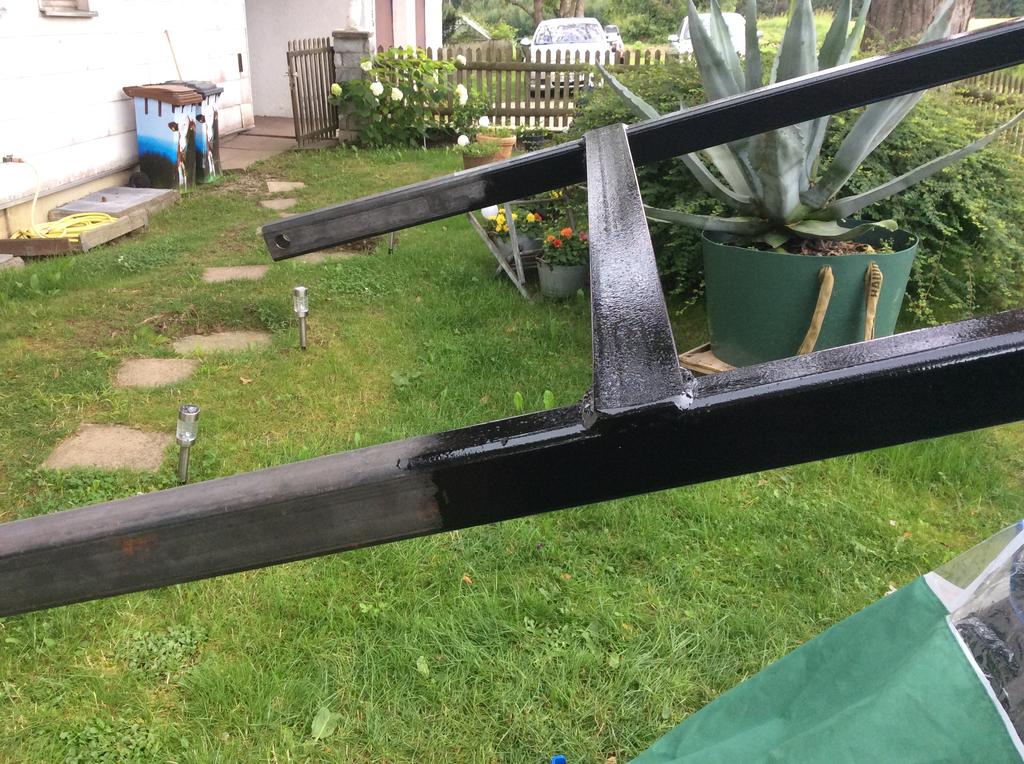

Tractorhead 9,217 #155 Posted July 27, 2019 Madness sings :“One step beyond“ - had that song today as Earworm, and after Coffeebreak, i looked at the Weather, hum so far nothing to see, just few smaller Clouds. ah, common, let‘s painted the Arms and while color dries that fast at 36deg, i mounted the Liftconsoles back on the Beast. Looks better than i expected, then i painted the Basearms partially, while i finished, i had a look at the Sky. oooops, some Deep dark Clouds has a hurry. maybe i had to hurry myself, bring the painted Arms in shed, (i had luck, kati is out) 😂 than i quick harvest my Dinner for today. Now they realy can be called Potatoes. It was just one Plant i harvest today, but ebit is more that the first ones. Dinner for today is clear, roasted Potatoes..😎 🧐 2 3 Share this post Link to post Share on other sites

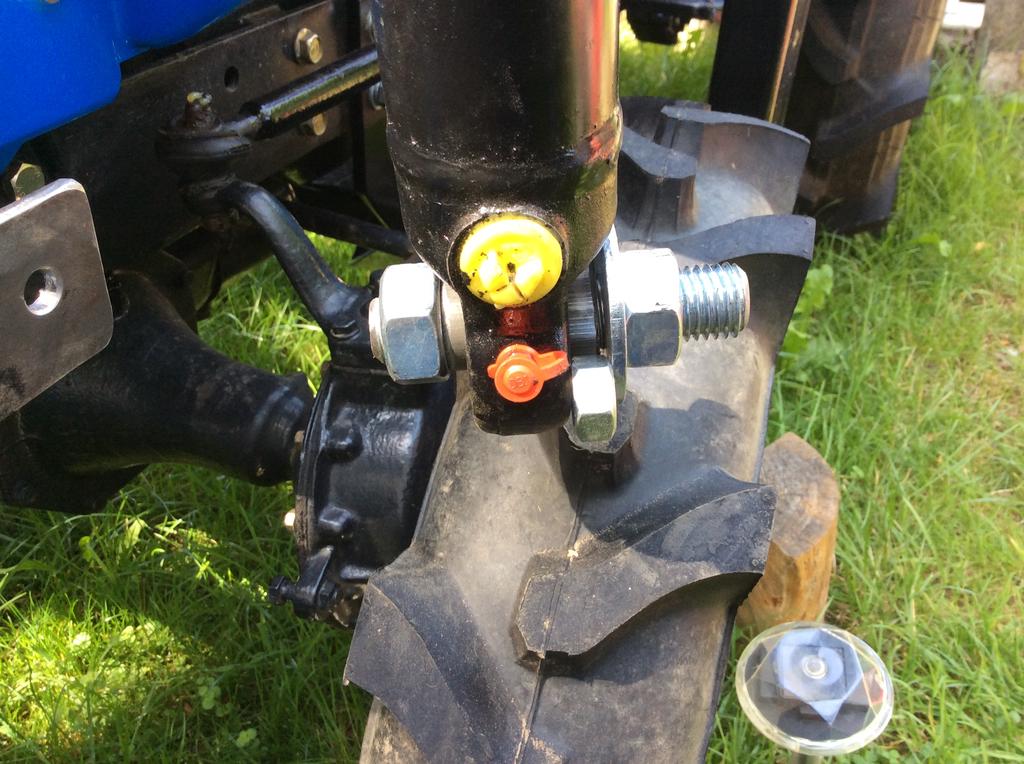

Tractorhead 9,217 #157 Posted July 27, 2019 Just a short ligh shower was occur, than it come heat again. Cool, time for Tinker. Because i’m soooooo curious, if all my Calculations until now are right, i do the first Test with real Things. few mm differences are ok, i just wanna know if things fit as i had Planed ahead or if i did bigger mistakes. Ok, i have one mistake found, the changed and ordered Hydrauliccylinder has the greasenipple on the opposite side than the first, i missed this item in my Order. Aaaaarggghh. 🙄 Next issue i see yesterday in the Nightworker Action, the 25mm drillbit was extremly soft, it seems it is not hardened, in that case unusable, I contact the Dealer and drill instead 20mm for now. Maybe i work with standoff’s we will see. Than the big moment reached, (Drum roll) Tadaaaaa. 😂 boah looks that Cool. And it Fits, even with missed Greasenippels (gladly enough space planed) 😎 I must Lift the arm to Grease, but i can Deal with, so the consequences are low. Then my urgendst Challenge, did i reached the 2,30? (Don‘t look at my fingernails, the chewed..) This was a 3Meter rod (thanks by Mercedes for that Giveaway) 👍👍 The Mark is at 2,35m - chacka. Buddy‘s i cannot bring in Words how glad i am, to Solve that. it‘s real high, so the Rollover Protector is definiteley a must. i‘m also real Proud of the changed Shape, because it will give a pretty Cool Housing if all is finished. The „Church roof“ will be changed later into a cabin, this idea was in background. a short impression from Driver Seat. 1 3 Share this post Link to post Share on other sites

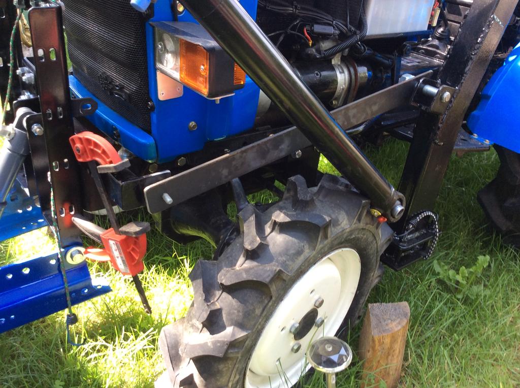

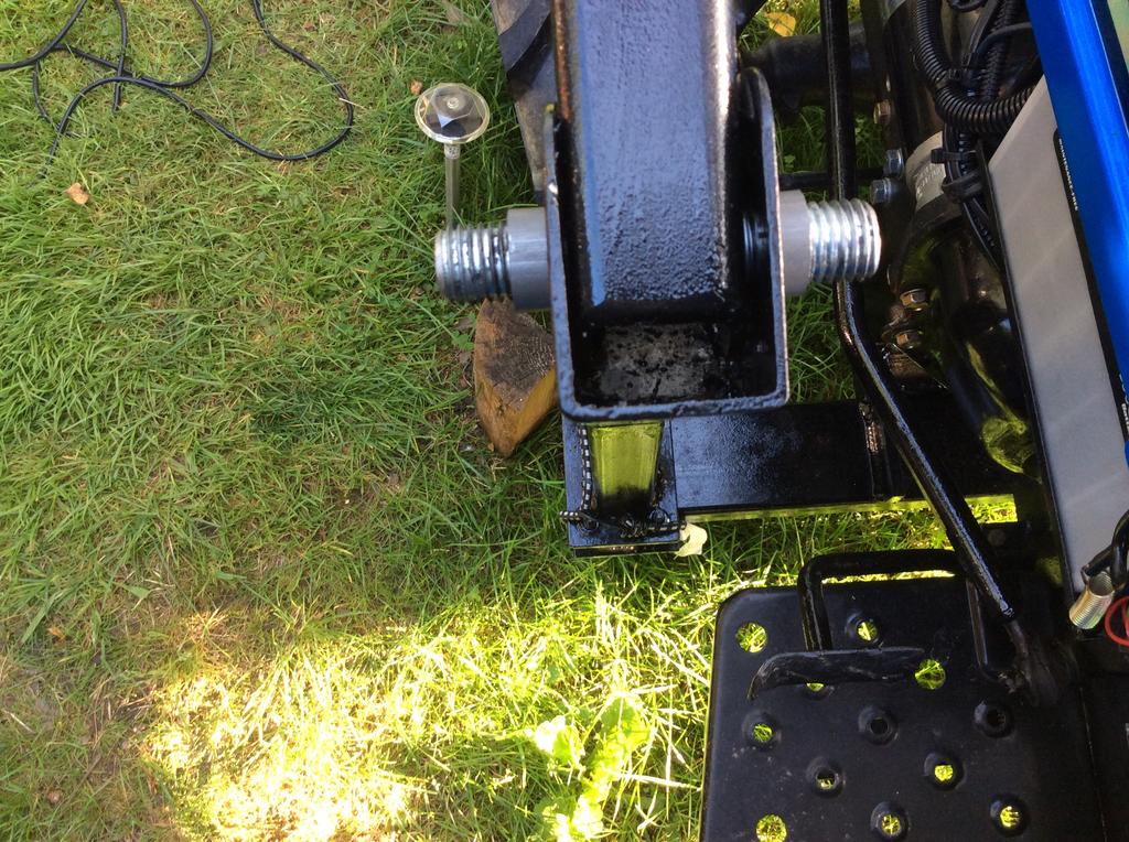

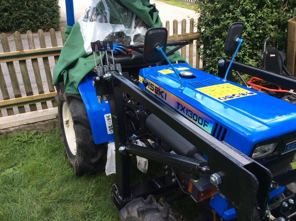

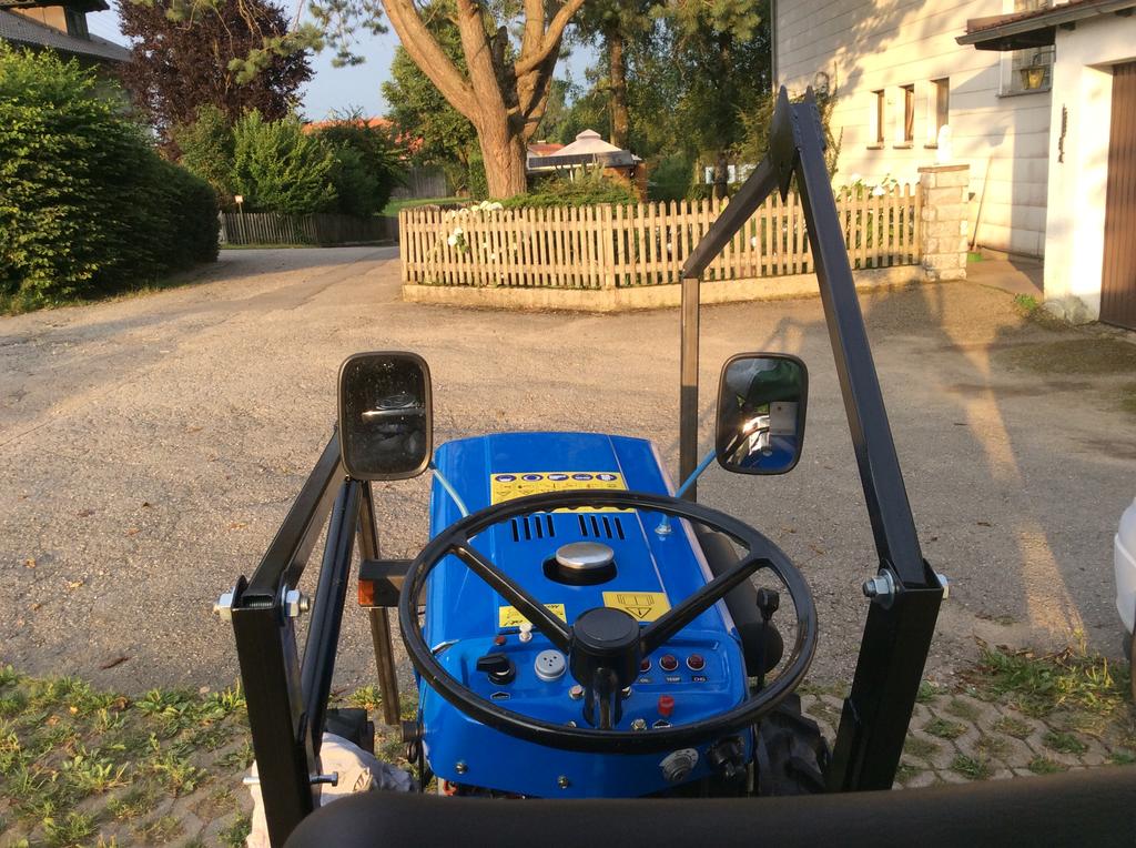

Tractorhead 9,217 #161 Posted July 30, 2019 A lot or Rumours in my Head. To come to other toughts, i still try to keep working a bit on my FEL. Firstly i drove the Beast into Frontyard, to have it closer to the Shed and test the Clearance. The curb has a measured height of 25cm, so i put 4WD in and it still climbs over. No scratch heared, the Clearance is fine. Than i parked an grinding both sides on Hydraulicmount same Way.. after finishing, i do second times Paintjob on FEL and look about some other issues and repair few paintscratches after Work. I decide, i will improove the upper joint and release the greasenipples, to be able to handle them even FEL is down. Additionally i prepare the Rearaxle support. A big mistake occurs by veryfing. i measured the Struts again after i planed and wonder why they differs but i cutted them ahead, but i didn’t imagine i just screwed the Liftarms both to inner side. So i forgot to add 40mm in length - Ouch, that hurts, all are allready cutted too short.🙄 But ok, so i have some material in spare.. 😂 Again measured the Struts for implementing on several points. yes, once again all +40mm more... let‘s do so. 😎 3 Share this post Link to post Share on other sites

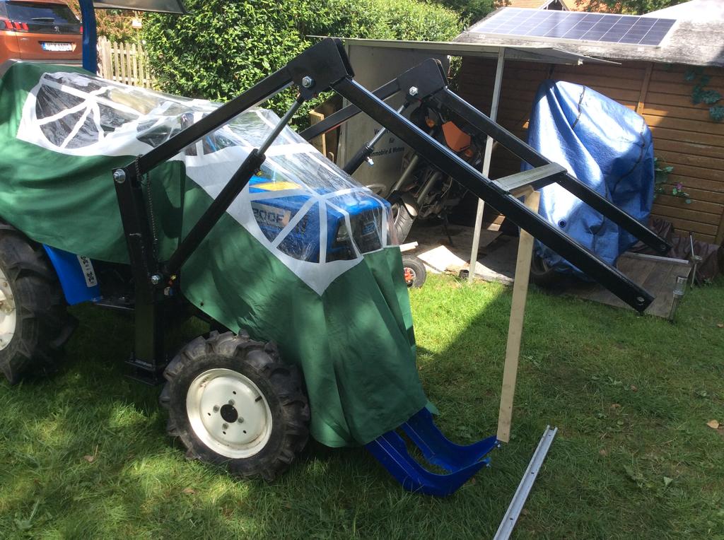

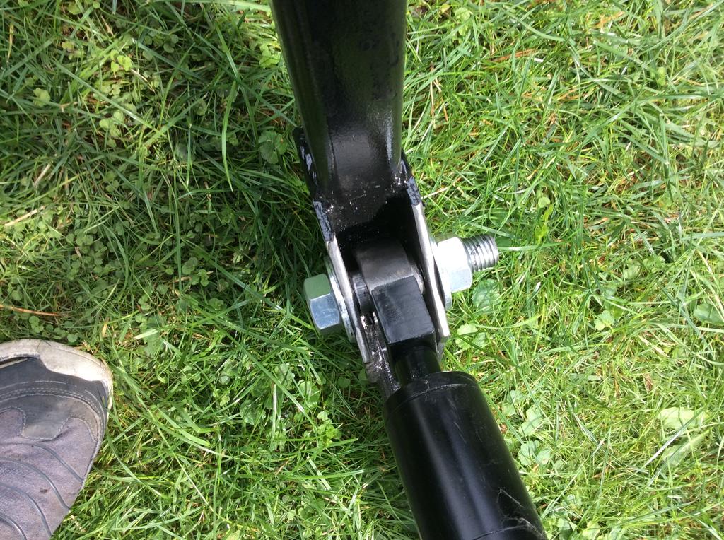

Tractorhead 9,217 #162 Posted August 2, 2019 (edited) Just few ministeps are possible. 🙄 The Weather can not be calculated, and it continousely begin to drip. Than i have quick to interrupt and wait what‘s happen. Firstly i started with the Serial Plate, what is now Lasered. All given Datas are confirmed by ISEKI Europe, than i started to align the FEL Arms and welded the Base Strut. Rain...🙄 After i have all put in shed, it seemed it stay‘s dry so far. Next Try, pull everything out, started the Welder, start the Flex, to cut a strut in Dimension i need, - you know it - again it begin to drip. This game was done 7 times, than i give up. grab fix the Flex and cleanup the Edges of the Base Strut, Than i cleaned the Arms completely with Steelbrush flex and painted them. So if i must now welding, i must first remove the Paint, but it‘s better than it all will be rusty. Think it looks pretty Cool. if Weather is more constant, i weld the Valveblock Mount and the remaining struts for more stability. At Least for today i drilled the Base hole for the Rearaxle Strut and paint it quickly, before next Rain comes. while finished, Rain is starting. i kept it outside, curious if a nice Pattern will occur... 😎 not a good Day for working outside. Edited August 2, 2019 by Tractorhead Added item 3 Share this post Link to post Share on other sites
Tractorhead 9,217 #163 Posted August 3, 2019 (edited) Weather seems good at 9:30, it was sunny by 18*C. So i started after a good Beakfast to dismount the Fork for adapting Works. Firstly i use Anglegrinder and rework the Distance for the Greasenippels, to Service them even if FEL is down. Cut it widely out and smoothened after with the Flapdisc. Than i recutted the Liftarm enforcement, to get closer with the Grinder in and smoothened the Weldings inside. After grinding i try, if the Hydraulics fit as it shall. 6mm thick Steel produces a lot of Steeldust while cutting. it was fairly that wide my Anglegrinder needs in Clearance, to go in and clean and smoothened the Welding seams. To keep Hydraulic cylinders in Place, i used a precision Tube with outside dia. 25mm and drilled 2 hole with 2mm and cut them in 38mm length. Than i pressed it in the Balljoint as an Distance for easy removing by a Quickdismount with an 20mm Bolt. Maybe i will use later the 20mm Screw’s we will see. If so, i drill a 5mm hole thru, and put a safety Splint after Nut. a short test how all fit‘s To get it a bit more smooth, i grinded the eye of the Cylinder also a bit on the Edges. Yap, it fit‘s like i expected. Then i feel a light breeze..... ok maybe 20 min. To left 🙄 so far for now... Coffeebreak😎 Edited August 3, 2019 by Tractorhead 1 2 Share this post Link to post Share on other sites
Tractorhead 9,217 #164 Posted August 3, 2019 After Coffeebreak i hoped the Paint dries quick so far. Yes, it seemed good enough, to handle it, so i mounted all together for a Second real movement Test. All ahead, if i‘m able to handle it allone without any Help or a second person. yes, it can be handled allone, Not the lightest Work, but it can be Attached allone. Now i‘m able to measure the final length of the Tubes, to connect the whole hydraulics together. Think i will use 4 Quick connectors, to attach or detach the Hydraulics for a fast change. Another measuring if alignment was given. yes. Boy. Look that cool with Cylinders in... can‘t wait for first Testrun when all is finally. 2 2 Share this post Link to post Share on other sites

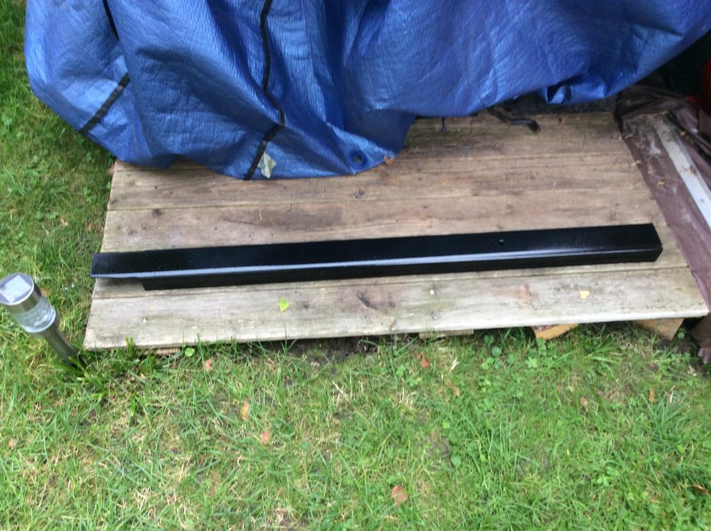

Tractorhead 9,217 #169 Posted August 8, 2019 Find few hours to do a bit today. Firstly i drilled 2 Holes in a Rect. Pipe. And mount if for Measurement. Looks good so far, than i use 2 pieces from the Cutted Steelparts and welded them on. Than i grind the edges round and clean the Steel from Rust. with a bit Paint i prepainted it, that i can mount it tomorrow. while no more work can be done for the Day, i go to the Potatoes and harvest Dinner. Hum is there no more inside ???? 🤔 aaaah, here they are.. 🤩 the first Plant and another one with follow result... Dinner is Safe, lets make some Potatoesalad today for Dinner. i love it! 2 2 Share this post Link to post Share on other sites

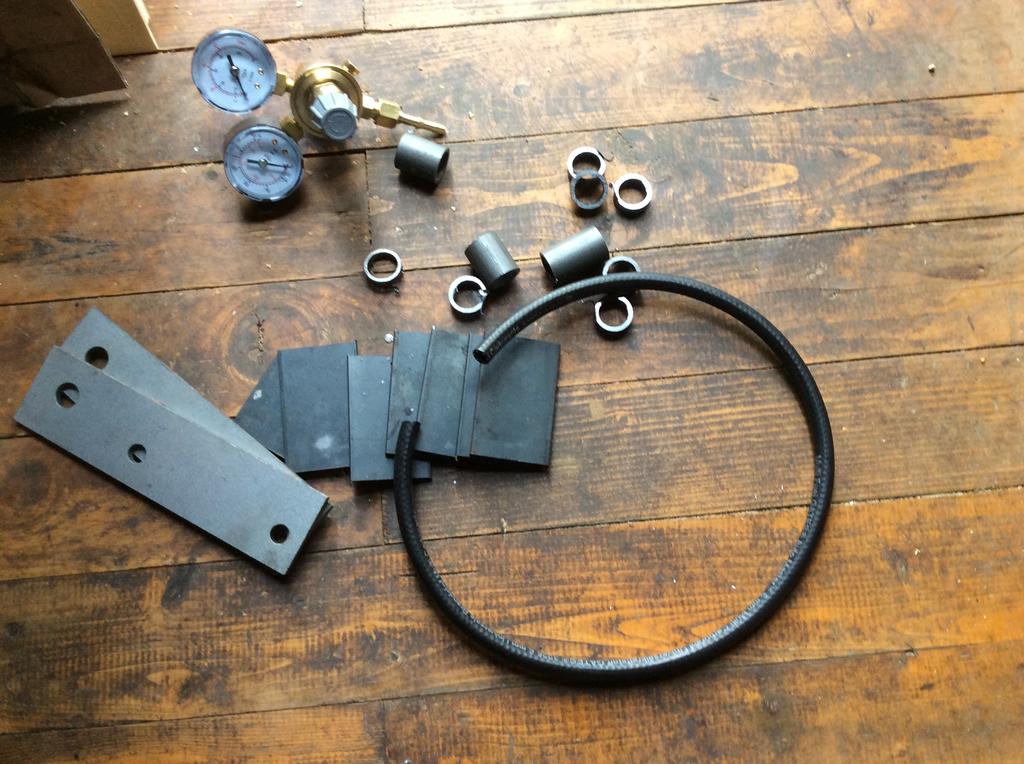

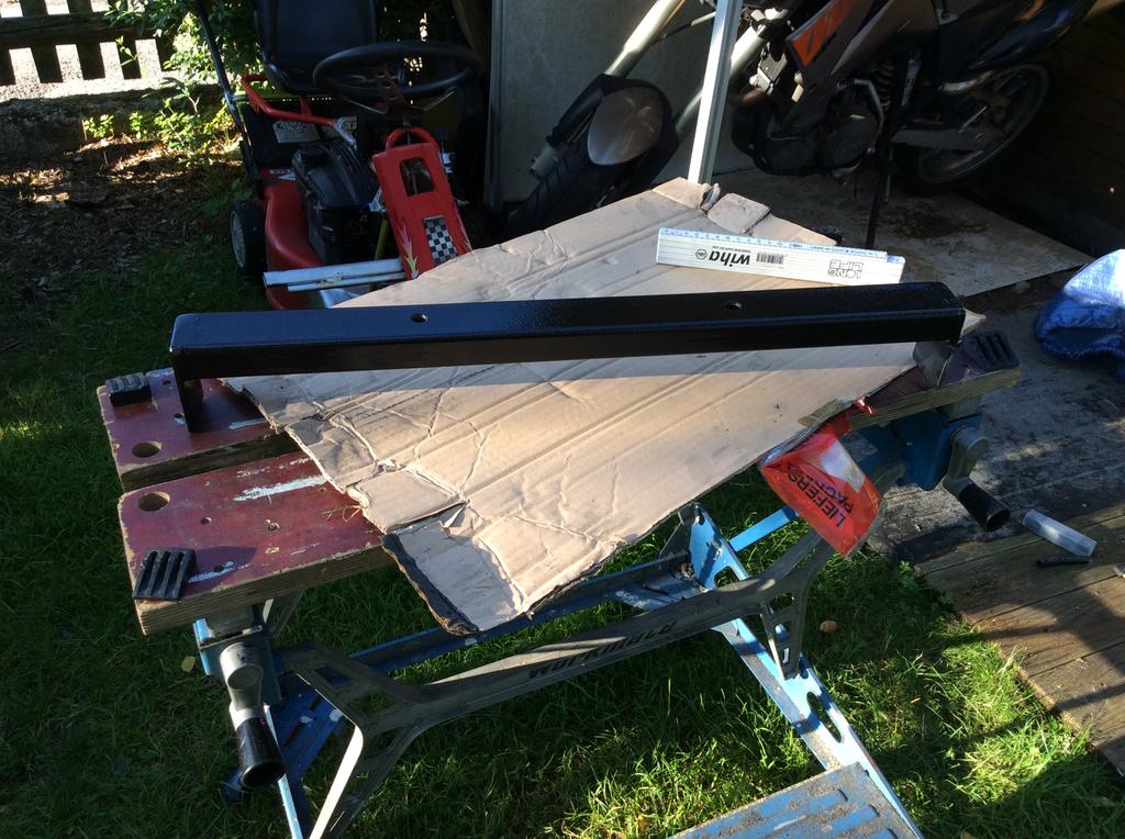

Tractorhead 9,217 #170 Posted August 9, 2019 Sooooo, noon work is done. working with an Earworm from Phill Collins - another Day in Paradise... I started with the FrontBar, drilled few Holes, than screwed in and later repaint. than some ordered Parts arrived... hear just DHL is here and lurking to the Fence. than i grinded few precutted pipes 4 cm and prepare for insert. After the inserts are setted, i cutted a 2meter Flat 50mm by 5mm in pieces of 64 cm. They result with few things are done with Anglegrinder and a Drill as Struts between Frontbar and Liftconsole. than i paint them and mount them. Looks good, than i grabbed my iPad and ordered the Tubes for the Hydraulics. I also added a Blast protection tube with the Tubes. I shortly decide to use Tubes, in case of moving of any other Position of the Valveblock. Additionally also ordered now 2 Hydraulic lifters, 32/20 with 400 mm range for the Front End. As Frontend i decide to build a „Euro mount“ quick changer for Quick exchange of Tools. At least i prepared the other precuttet pipes, and have a look if i would do this Way, with a bolt and Spring for quick dismount, or i leave it as it is. Maybe i welded them tomorrow, but weather forecast tells some Rain - we will see. Decision is not taken in the Moment. And Weatherforecast is actually more like reading Coffeeground. 2 Share this post Link to post Share on other sites

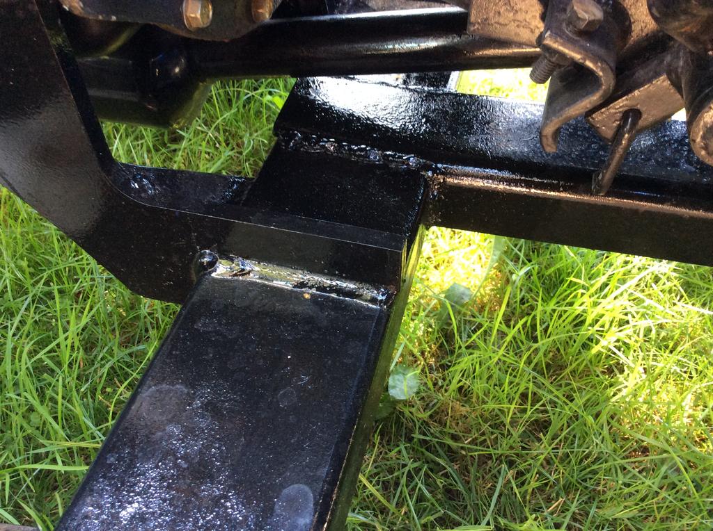

Tractorhead 9,217 #171 Posted August 9, 2019 Inserted the Backstrut to Gearbox, or better Rear Axle. Allready screwed to the Rear Axle. And in the Rear, it was long enough for a permanent Trailerhook, that releases the threepoint. Pretty nice Fit. 1 Share this post Link to post Share on other sites

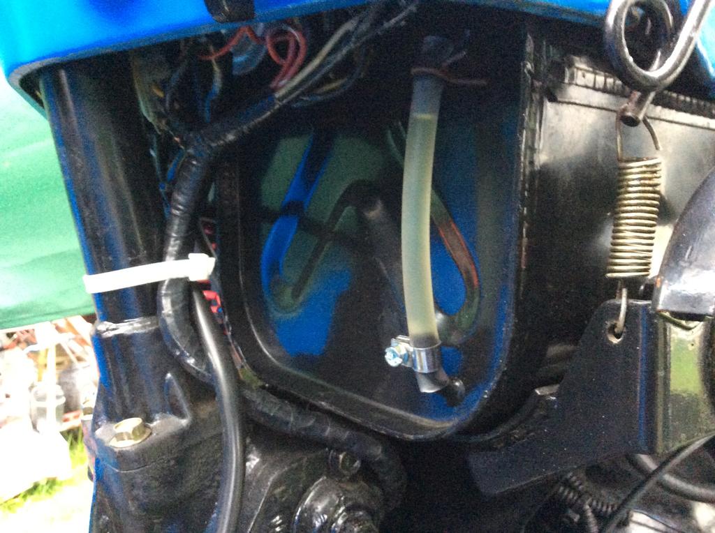

Tractorhead 9,217 #172 Posted August 10, 2019 Weather forecast is partially right. So i used the Rainfree hours to do Today some minor Work. Not only at The Beast. Firstly i begin with the draining Fuel and change the Fuel lines, because marten has biten and it drips if engine runs, it just sweat a bit if Tractor was off. After i did a closer inspection, i see a Gauge like „Old School“ . Boy, i love that and decide i will reactivate. Get a piece of clear Tube to exchange with the Black one. that was the Result.. after refilled it shows me the Fuel, what is in Tank. Pretty Cool. Than, while i drove yesterday in later noon, i missed a bit light on the Road, the car light is pretty weak. I thinkering someday‘s the light will be very Weak, so i ordered 2 Front lights ahead. The shine they shall bring to the road was nor really sharp.They where surely bright but not where i need them. in the Morning when they Wet, they look not too bad, but after mounting the new ones a significant difference was happen. They arrives yesterday and today i quickly changed them. What a difference. The right one is the 25 year old, the left one is a new one allready inserted. Because of the blind glass, the light will be diffus spreaded and thats the reason it felt to Weak. Then by th Test i found out, one of the Servos, the changed the bright wide hungs. Because im on the Way, i still reworked it and remount. Another urgently Issue Solved.let‘s have a Coffee 😎 2 1 Share this post Link to post Share on other sites

Tractorhead 9,217 #174 Posted August 11, 2019 After Dinner, i quickly decide to premount the Quick Connectors for Hydraulics. Now, where i measured the length, i mount them to quickly Attatch if Tubes are delivered. looks really sharp and handling is good. slow but steady it comes to the Final Stage. 2 2 Share this post Link to post Share on other sites

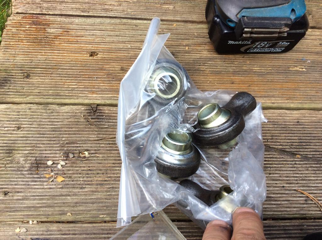

Tractorhead 9,217 #175 Posted August 14, 2019 Some Parts arrived. Tilt cylinders, Hydraulic Oil and Blastprotection tubes are arrived. still waiting for the Tubes, they are announced for Friday. hope for it. 1 2 Share this post Link to post Share on other sites
