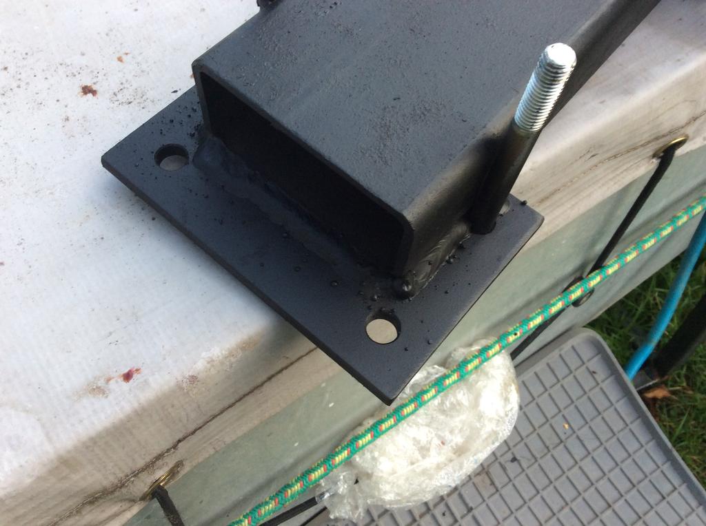

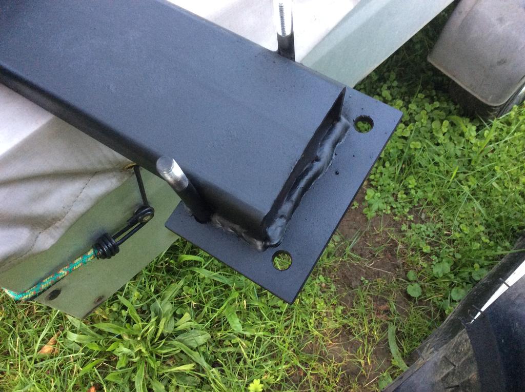

Tractorhead 9,218 #134 Posted July 12, 2019 (edited) Doing a bit Weldtraining for the FEL .weling here a bit.. Welding there a bit.. Make some improovement... Test between to see what Fit.... Looks good, but i‘m not satisfied, have to improve the stiffness. Later i gave all a little RattleCan Paint 8 for a nicer Look, didn’t grindin* too much, just if needed a bit to fit... Finally mount the Parts, to check, does they fit as i Measured and 3D before? yes, they did, another Step was done. The base Console was so far finished, next challenge will be the Mount to Rearaxle. rethinkin how it can be made Removable. Edited July 12, 2019 by Tractorhead 1 3 Share this post Link to post Share on other sites

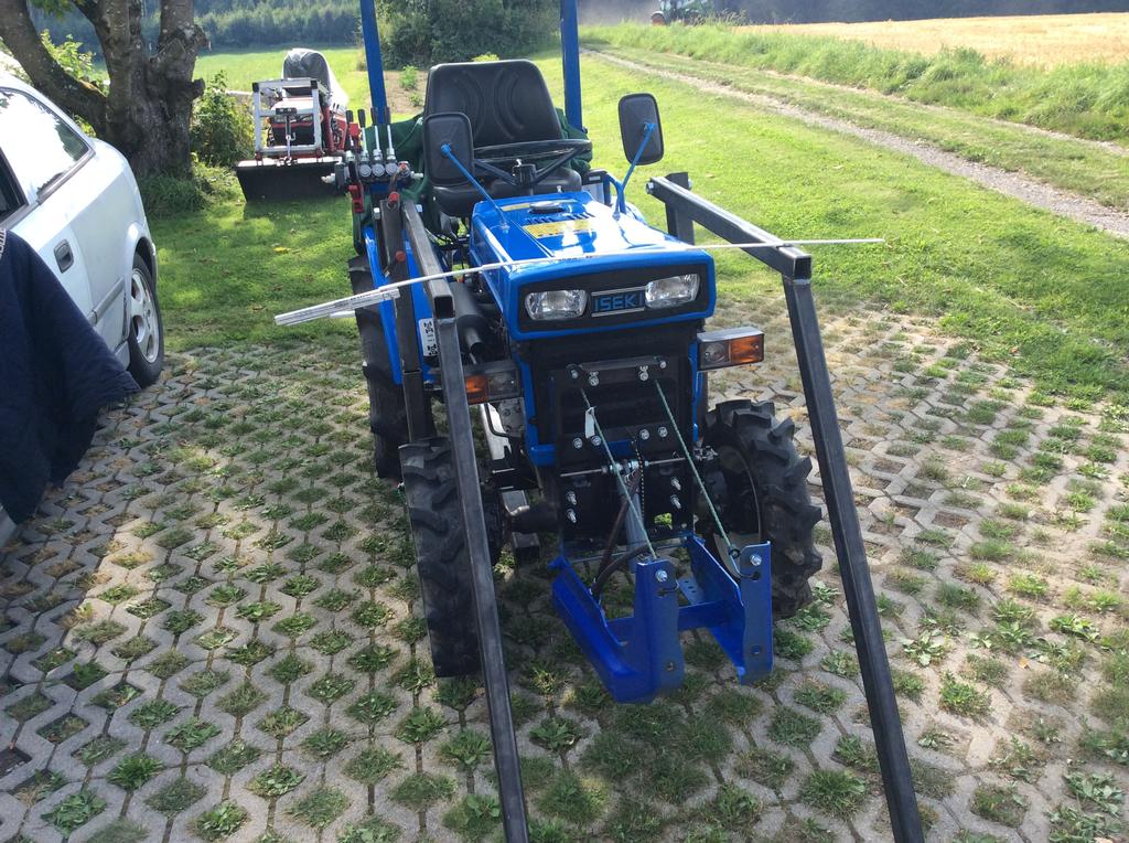

Tractorhead 9,218 #136 Posted July 13, 2019 Using a few minit‘s of gladly rainfree to take 2 Pics and even do few measurements ahead for the next Step. Don‘t forget it was a Prototype and i changed few issues while build. I set the Liftconsoles with an angle backwards, increased a 2 Port to a 4 Port Valveblock, found better cylinders with bit more length, added a Frontlifter and something addon’s more. I do a try where i before will mount the 2 Port Valveblock, to see if enough clearance is given, while the 4 Port Clerance looks very Close on my Drawings. I also hold the new doubleaction Liftcylinders in Place, to see ahead potentially troubles about clearance, because of Flashlights and something similar. While it was a Prototype, i also recalculate some Dimensions, to be sure all works as expected and planed and later Build. 500 Kilos of Liftcapacity shall be my Goal, but because of Dynamic‘s i calculate with 1,5 Tons to have enough spare. Used will be realistic mostly a maximum of 300 Kilos, but Shovel weight and other Attachments came on Top. That‘s my reason to calculate much higher. It make sense to plan it more ahead and work with templates to see, if the results like the drawings or space is less than needed. Measurement gives you surely an idea about a Planing, but to see things in natural it can causes sometimes surprises you didn‘t see ahead. Especially if space is good for all day using and a comfortable using. My personal issue was, a quick hop on hop off must be given, even in Winter with thicker cloths. Here i found the Valveblock was to close to my feet now, especially in Winter this will definiteley causes in ripped Cloths, what results in a lot of potential to hurt myself and even not enough clearance in case of an „Emergency jump“. Good that i double checked, because after bending its much to close, so i have to find another place for the Valveblock after bending the Liftconsoles but it must be comfortable using. Then i do some tests to see where i have enough clearance also with the Tubes and something others. I also plan more enhancements, but that is different Story. 3 1 Share this post Link to post Share on other sites

Tractorhead 9,218 #149 Posted July 25, 2019 Ha haaaaaa the new Drill bits arrived, From 14-25mm i was before just able to drill, if i could lean a Drillbit in the Office. now i have my own. After cutting with bit overlength, i make a testscenario with the real Steel how it looks. the Bolts for testing was M20 Threaded rod but will be changed later. they was just quick available while here. Think it looks pretty hot. On this Pic you can imagine how it will look later. In this Pic the Consoles are not cutted, but because Liftconsoles are 4mm thick Material, they will be cutted in the upper 10 cm, so that the liftarms will work into them as a closed system, so if an Armbolt rips, the load and the Arm is away of my Body and will be catched in the housing - Safety first. The cutted Steel will be later bent into the Pipe and welded as a Drain, so that Rain will be running outside the Consoles. Than i reinforce the consoles it with 2 welded Steelplates sideway‘s outside to increase the thickness of the Material and close it upper with a catch Plate. Between those upper Catchers i want to insert a pipe, to give them all more stiffness. As Axles for the Liftarms i planed 2 Steel Bolts 20mm from a Rearlift KAT2 with inserted bore 5mm for a Springclip for a quick dismounting. Also provided with a Grease nipple, to Service the Liftarms, but this comes maybe Later. Things are ordered but not arrived yet. The Hydraulic Cylinder will be just clipped in with same system for quick Service but in 25mm what id given by cylinders. 2 reinforced consoles made from 4mm Steel will catch the Weight in the Frontkink and be the Attachement with a 25mm hole for the hydrauliclift on each Arm. Same Material i reinforce the consoles where they bended and give them the second mountpoint for the Hydrauliclifts. they are also still in the Laser Company, because the are extreme busy actual and i got a more than fairly price, i have to be patient.....🙄 to be patient is not my real nature😎 The yet measured Liftheight is something about 2,35 m - 2,50m., the real liftheight depends if i cut finaly the Main Arms or not, if i cutted the Main Arms i be able to increase liftheight, but im not sure to do that because 2,35m on the Anglepoint is high enough, i found. Thinkering before to screw the Arms, but my calculation tells me, the Stability is very close to my Limit if the FEL shall diggin with full Force and i like it to have 5 times Spare for Safety. Again safety first, so the Arms will be welded. For the stiffness between the Both Arms together on the Fork i planed a traverse strut in lower front section about 45cm far from the End and also on the upper console. Also 2 added Traverse struts must be implemented from the consoles to the Frontmount bar on the Tractor, They are stiff enough for the Load to release the Consoles but screwed, that it can be exchanged in case of any need. Engine Swap or Turbo addon, or whatever - who knows... 😎 the Last section will be a screwed reinforce traverse struts to Rearaxle to release the Clutch, than connect the whole Hydraulics, Paint, new Roof. A long way to go. 2 1 Share this post Link to post Share on other sites
Tractorhead 9,218 #150 Posted July 26, 2019 Where to begin, hum started after Work the Welder and prewelded the both Liftarms. Because i still miss the Lasered Parts, i decided to keep them in full lenght. Than i do a quickmount, to see if i reach my Goal of, 2,30m. Make a long story short, yes, i will reach 2,38 liftheight max. On the Anglepoint. Than i try once outside once inside the Mountingpoints, for now it‘s to hot outside to work. While tomorrow Weatherforecast tells something below 36*C i decided to wait. completeley Wet i try to find a good position for the Steeringvalveblock. Think i found a good position, even i won some space. The valveblock can fully supported by the Front, so i just have to change 2 Connectors and i‘m done. a decent question at the Lasershop how long it maybe will takes after several Weeks ends up in an harsh „where not Witches...“ and he hangup the Phone, that was my second Carefully ask... i was a bit shocked about this. After that i think to myself if that shop is a Partner i want to deal with and thinkin to stop that contract. Anyway, Because i like to mount the Valveblock on the Left side, i think i found a real good place for. a lot of space, even to Clutchpedal, a quick in out is given. hope the Weather isn‘t too hot tomorrow, than i flex the Front blades down and weld them in the console to implement the Fork, than a few measurements and welding the base strut in. 2 1 Share this post Link to post Share on other sites
