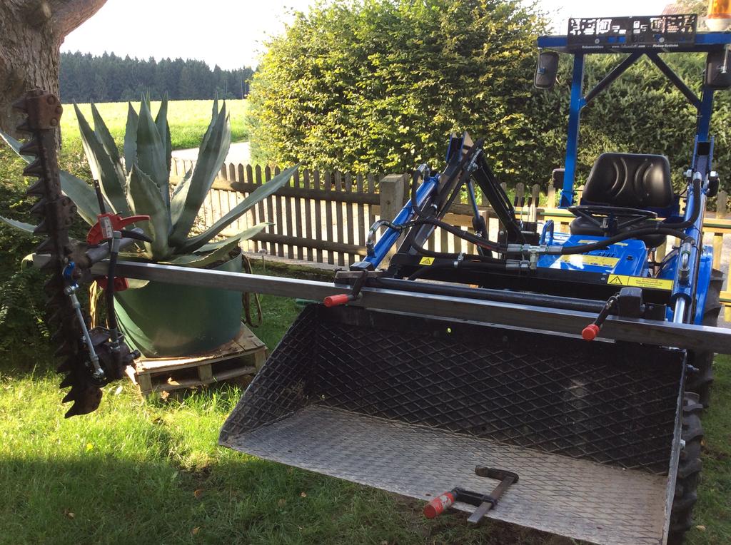

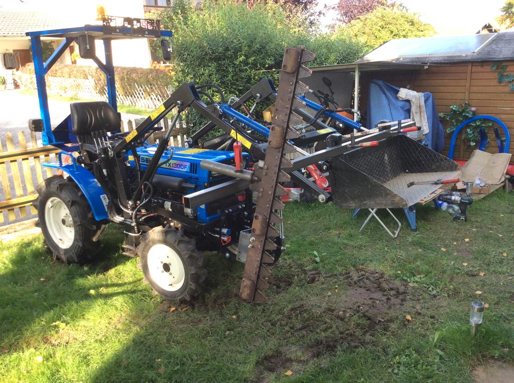

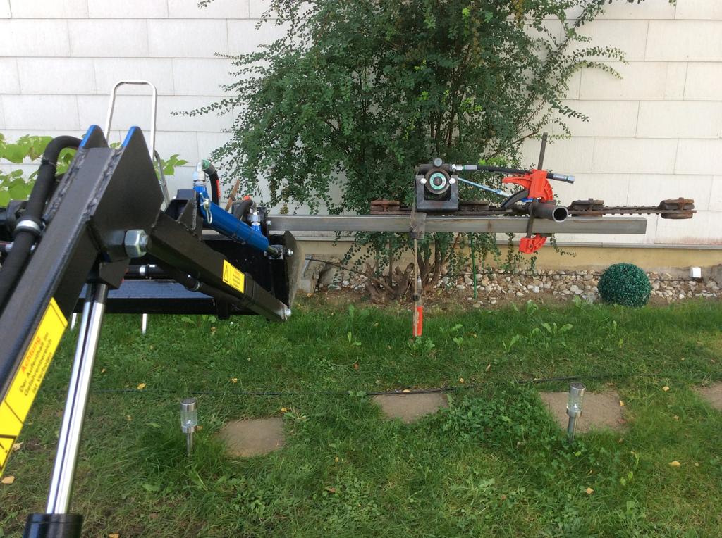

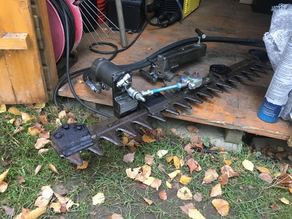

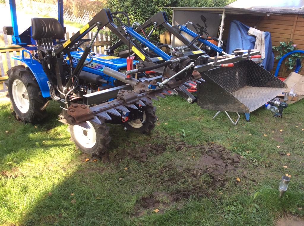

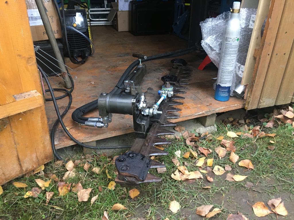

Stormin 9,988 #227 Posted September 14, 2019 I don't think you've got enough movement there, Stefan. The blade should cut fully both sides. Mine does. Share this post Link to post Share on other sites
Stormin 9,988 #228 Posted September 14, 2019 27 minutes ago, Tractorhead said: That looks positively lethal, Stefan. I like it! 1 1 Share this post Link to post Share on other sites
Tractorhead 9,218 #229 Posted September 14, 2019 Yap, that looks nicely Dangerous. Hehe but in right hands, this will develop a cool gadget. i‘m compared the Oilmotor and the possibly shift i can use. this Project will also be grown continousely like my Herd. I‘m unsure about Oilpumptest, because i firstly must adapt the Return pipe to a much Thicker diameter. no tube available in needed length. Share this post Link to post Share on other sites

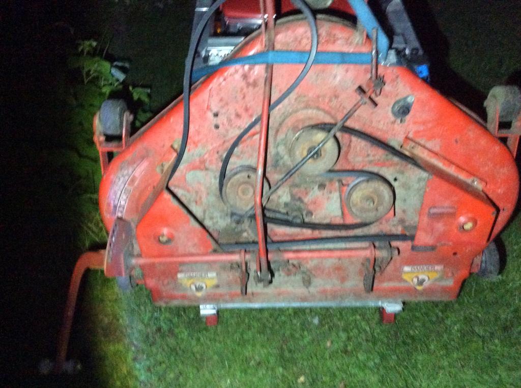

Tractorhead 9,218 #231 Posted September 17, 2019 Clicking today Mowerdeck off, to see below. As i told, here the new Clutch... and the Status of Mowerdeck... all looks well and pretty sharp. ok, order a new Belt.. 2 Share this post Link to post Share on other sites
Tractorhead 9,218 #232 Posted September 20, 2019 (edited) Yesterday the Belt arrives. firstly i try in a hurry to insert, and wonder Why it will not Fit. Firstly i doubt i‘m made a fail in measuring, but it was allway‘s a good idea, to take some Picts before you disassemble a thing. a simply Fail while wrong insert clears up, where was my mistake. at later night, i review my Picts and found one, where the Belt is shown. I insert it in right direction and the mower fits. i wonder a bit because of stiff spanner, so i get some Gease and bring it back to work. Maybe this was the reason, while the old belt Lasts that quick. However, i try the Mower firstly on slighter grass, later in higher grass. Yes, it works well again. After harvesting my last potatoes, i decide to clean up the Field, but i didn‘t want to do it manually. So i develop a Stupid idea, Why nor use the Wheelhorse, as long as Mowerdeck was out for Cleaning. That was the Rest i can keep for myself.... 😎 Because the neighbours ask for a Try. I‘m proud, they ask me, so it give me the feeling my harvested Result can not be Bad. i spend some and keep for us just 3,5 Kilos. The complete Harvest was now all together 28Kilo by inserted 5 Kilo. Anyway, Than i search for few Quickstraps and bound my Manual Tiller onto my FEL. So i can do the Job while having some Seattime on my beloved Horse. I wanna move the Beast, while it‘s prepared for Road Approval. Done as Sayed, i fiddeling it onto. and it looks funny, but i tryed it if this will work. i did a small Video, to show how it works, think i have to build a simple Leversystem, that i can mount it quickly and stiffer, but it does it‘s work better than i expected. i needs several passes, because our Soil iv very clayley. but after 5 Passes, i satisfied with the Result. 865C2EB0-9104-44E1-9241-0534B8D67221.MOV Edited September 20, 2019 by Tractorhead 2 1 Share this post Link to post Share on other sites

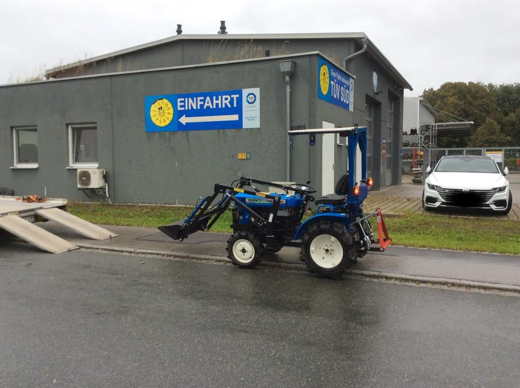

Tractorhead 9,218 #237 Posted September 23, 2019 Sounds interesting... 😂 so i know, the poor herd is in good hands. I GOT IT Yeeeeeehaaaaaaa! Road approval was a Success ! Yessssssss👍 I just have to bring them a Weight protocol for Paperworks, what i make after our Holiday. i asked them, and i was allowed, to take a Pict at Check Station. i just have to blank all Licenseplates on Pict. I‘ll be Proud of it. 1 Share this post Link to post Share on other sites
Stormin 9,988 #238 Posted September 23, 2019 2 hours ago, Tractorhead said: 2 hours ago, Tractorhead said: I GOT IT Yeeeeeehaaaaaaa! Road approval was a Success ! Yessssssss👍 I just have to bring them a Weight protocol for Paperworks, what i make after our Holiday. Well done, Stefan. Couldn't help but laugh at the test depot sign. 2 hours ago, Tractorhead said: 1 Share this post Link to post Share on other sites

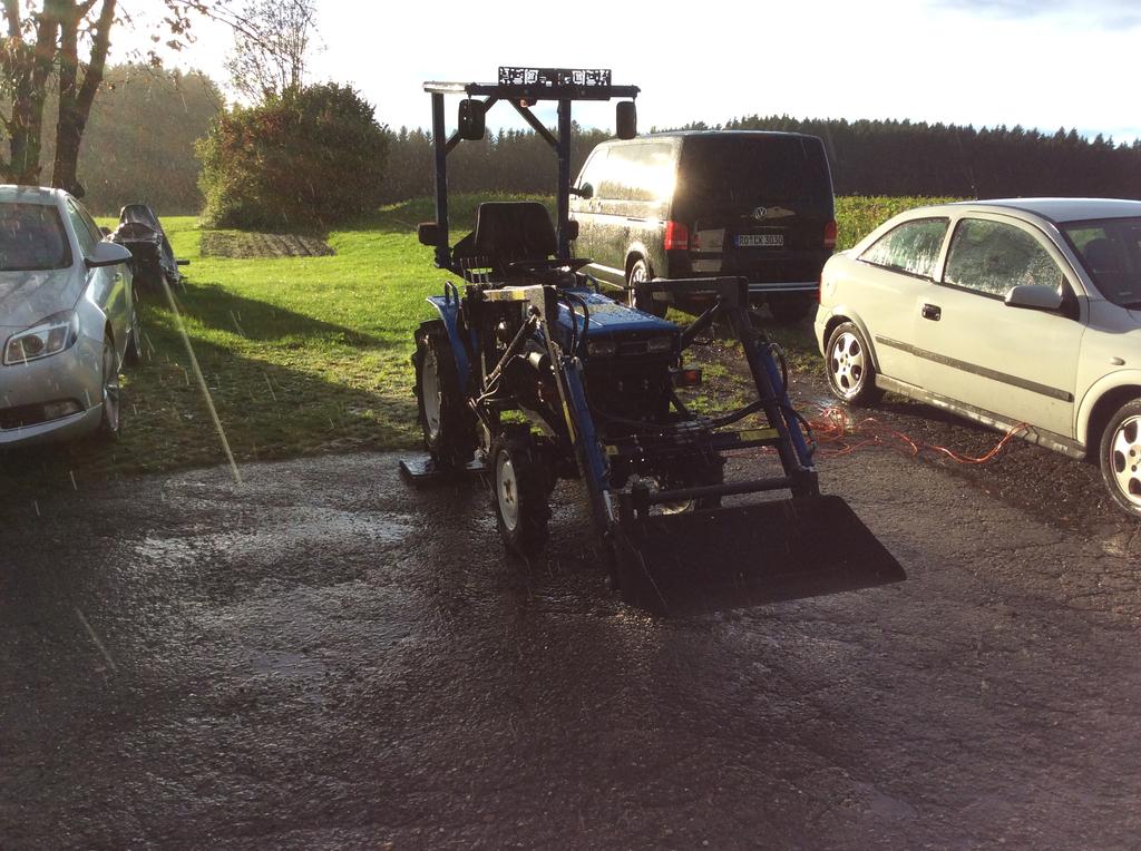

Tractorhead 9,218 #243 Posted October 23, 2019 (edited) Finally i made it.. Today after Doctor i went in registration office and.... Roadlegal - yeah, ok somebody will hate me, if i drove on the Road, 😂 but it was just a huge Goal for me, to solve that. 😎 it ain‘t easy looks bit better with it‘s own Lizence plate. Winter, you can come, i be prepared... even if a Policecar comes along... Edited October 23, 2019 by Tractorhead 3 Share this post Link to post Share on other sites
