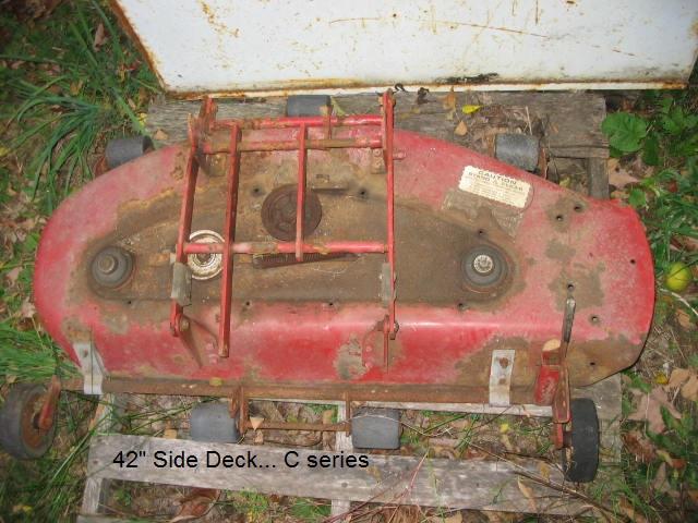

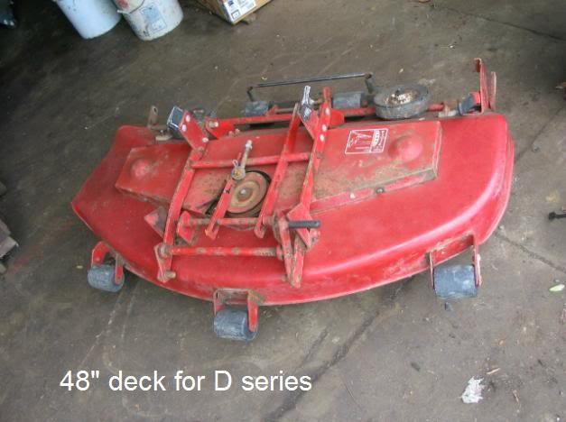

daveoman1966 3,882 #2 Posted February 1, 2019 (edited) It should fit, but you'll have to change-over some of the lift mounts from the 42" deck to the 48"... The 314-8 wants 48" deck model 78360...this is the lift hdwe for that 48" deck and is PROBABLY the same hdwe as on the 42" deck you have. If you don't have the required lift mounts, I do.....and can provide any that you may need. Pics of 42 & D-ser 48" decks too Edited February 1, 2019 by daveoman1966 1 Share this post Link to post Share on other sites
JoeM 9,646 #3 Posted February 1, 2019 (edited) I think I had to put on shorter stops and I may had to trim the front guides For sure the stops. Found some pictures of my son's 312-8 (vanguard 16 repowered) with a D160 deck. Ran good only change was shorter rubber stops. Edited February 10, 2019 by OILUJ52 Share this post Link to post Share on other sites
