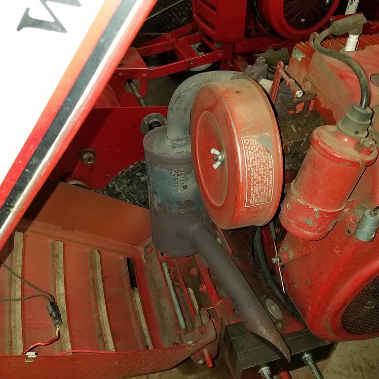

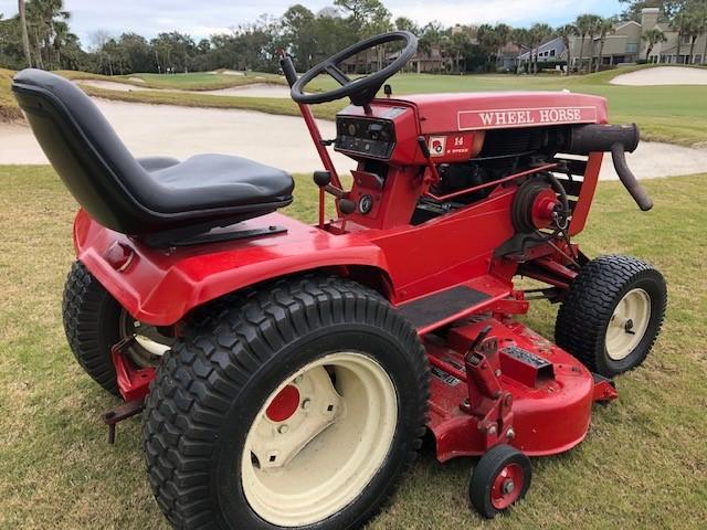

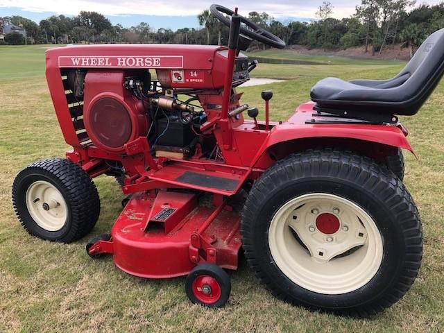

The904 14 #1 Posted January 29, 2019 Same story here. Been lurking on the sight. Grew up mowing camp on Lake Champlain with WH. Seems hard to locate one in Florida. Few months looking came home with this one yesterday. 1973-14hp (no name). model#10340 Looks like motor tag was K341S Serial #71106a maybe? Drive looks to be WH#5073-6 speed, low and high gear. 42" deck. Not a spot of rust on the machine is why I brought it home. Few questions... 1) What did I buy? Hard to gather some of the info on this unit-certainly not most popular one. 2) Will be mowing one acre 10 months a year very regularly with lots of leaves. Can I change deck to a side discharge to add a bagger to help pick up oak tree leaves? 3) Where is the best place to get parts? Would like to have a replacement set of belts/filter/blades on the shelf. 3) Besides cleaning carb, fluids, filters, any other tips for improving motor response to throttle? Do not seem to be able to engage blades in 3-high..the load wants to bog down motor.. Anyways, sorry to ramble. Eager to get ready for long growing season and figure out what we brought home to the garage. Thank you. 7 6 1 Share this post Link to post Share on other sites
SPINJIM 1,997 #3 Posted January 29, 2019 "You done good." The mid-70s were some of the best years for Wheel Horse, and '73 was the only year they just gave the models the No-Name horsepower designation. It's basically a Raider 14 or a C-140. I have a C-120 and a No-name 16, and they are almost bullet proof. Someone did some work on yours, probably to sell it. The wheels look good, and must have been repainted. The seat springs are on backwards; if you reverse them, you'll have a softer ride. The lever that lifts the deck has a stop on it, and someone replaced the adjustment knob with some kind of silver handle. The black knobs are readily available (Toro, etc.) and will give you more adjustability than that silver handle. If the engine bogs down, might want to check the deck spindles and lube the grease fittings to make sure the blades are spinning freely. Shouldn't bog down with that 14 horse unless you're in very deep grass or if your engine needs some tuning. Make sure the deck is level when cutting. Nice tractor. Good luck with it, and welcome to Red Square. Jim 7 Share this post Link to post Share on other sites
moe1965 774 #4 Posted January 29, 2019 Nice ride. Muffler doesn't look like it is on corectally or it may be the wrong one Share this post Link to post Share on other sites

Lee1977 7,764 #10 Posted January 29, 2019 (edited) Your deck needs to be adjusted. It looks to be way to low in the front. There is a adjust rod that attaches to the back of the lift bar that needs to be adjusted. The deck when setting on level concrete pad the front of the deck should only be 1/2" lower then the back. Check your deck spindle bearing to see if the turn free. Also the idler on the deck and the mule drive idlers in the front. Edited January 29, 2019 by Lee1977 1 Share this post Link to post Share on other sites

Tuneup 1,459 #16 Posted January 30, 2019 That is a beautiful machine and, considering the appearance of that deck, he likely went through the spindles. Turn the knob on the mule drive in front clockwise to release any belt tension on the deck pulley AND the mule drive pulleys. Check that they turn freely. You'll likely find the problem area. Start shopping for a proper muffler. Everything looks perfect EXCEPT for that thing. Even a basic pepper pot with galvanized will look better. I'm kinda vain about my Wheel Horses... Share this post Link to post Share on other sites
ericj 1,580 #17 Posted January 30, 2019 front wheels need to be swapped. Valve stems on horse are on the inside. looks real good, good luck with your new toy eric j Share this post Link to post Share on other sites
