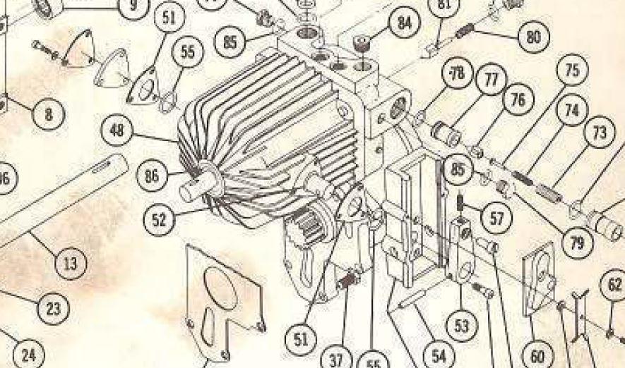

pfrederi 19,894 #2 Posted January 27, 2019 If it is red it is Dexron ATF (Buy the Dex/Merc ATF now available). Filter is Wix 51410 If fluid is tan/yellow it is 10w-30 motor oil do not mix them!! Electro/Chargers are one of my favorites I have 5. The leak is probably from #51/52/55 1 Share this post Link to post Share on other sites
cazngz 19 #3 Posted January 27, 2019 2 hours ago, pfrederi said: If it is red it is Dexron ATF (Buy the Dex/Merc ATF now available). Filter is Wix 51410 If fluid is tan/yellow it is 10w-30 motor oil do not mix them!! Electro/Chargers are one of my favorites I have 5. The leak is probably from #51/52/55 Very helpful... thank you It was my second oldest brother's tractor. He passed a few years ago and his daughter gave it to my oldest brother who is almost 82.. He has 13 garden tractors and can't keep up with all of them so he gave it to me his youngest brother ( I'm 73 ) So the WH has made it thru all three of us.. Just something special about that to me.. I'll end up giving it to my nieces son since my son isn't interested in this stuff.. 2 1 1 Share this post Link to post Share on other sites
