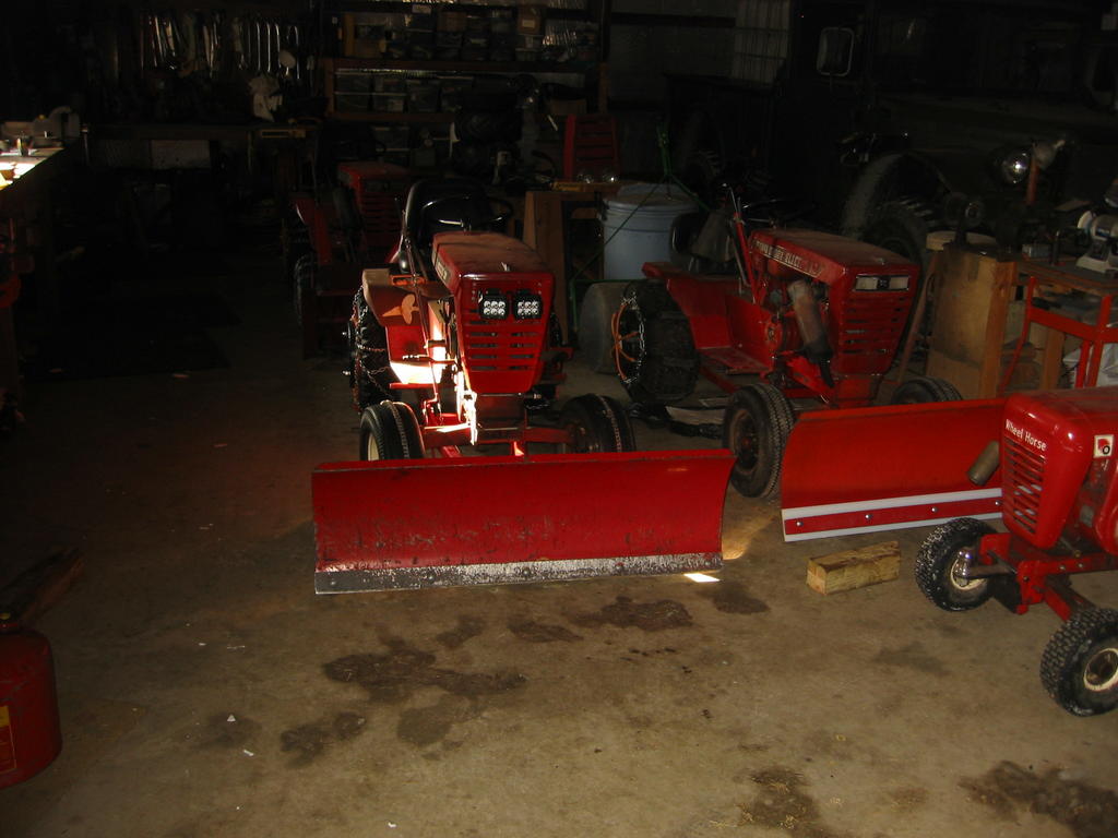

pfrederi 19,516 #17 Posted January 26, 2019 47 minutes ago, Ed Kennell said: Yes, the single stages tend to clog in the wet snow. One thing I have found, If you can keep the ground speed adjusted to keep the auger full there is less chance of clogging. The snow in the auger is actually pushing the snow up the chute and if the auger is empty, the snow left in the chute quickly freezes. This is one of the reasons I only use hydro tractors. No stopping and starting to change ground speed. I have a lot of WHs...I also have a lot of area to clear in the winter. i have used gear drives. Experience has taught me there is no better unit for snow removal than a hydro for both plowing and blowing. i used to use a 40hp Case DC3 to rearrange snow flakes.. now only Charger 12s and an Electro16 with a single stage short shoot. Even the slushy mess from last week end was handled by them with ease. It does not shoot the snow 30 ft in the air like the 2 stages but as long as it will move it beyond the driveway that is good enough for me, I am not trying to impress the neighbors. also I live on a hill that is windy. Blowing the snow high in the air is dumb idea for me. Ed is right the ability to fine tune the speed on a single stage eating snow is important and when it comes to plowing the quick reversals and high speed reverse of a hydro are a good thing. 3 Share this post Link to post Share on other sites
