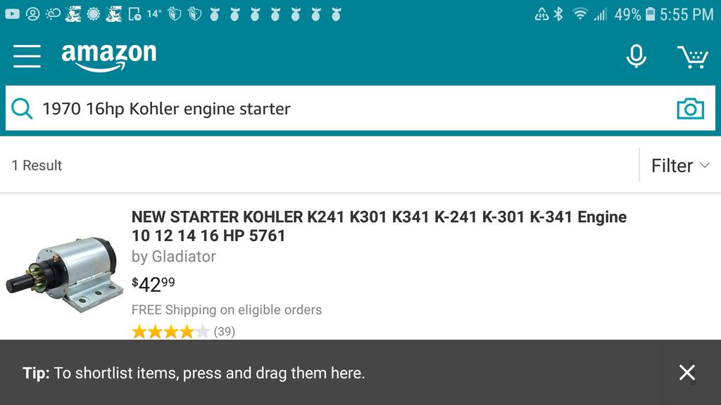

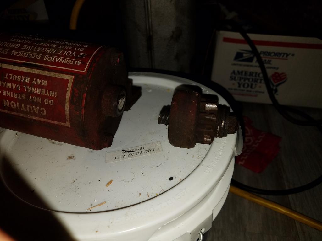

CrazyDetroit 7 #1 Posted January 25, 2019 (edited) I found this starter on Amazon will this starter work im concern about the end shaft. I would like to put factory back on short on cash..ty again.Im looking for starter information i see a few different brands on internet which on is best. C160 number on my starter is ...smh 12 a 201 American bosch. Factory orignal. 48 years not to bad for a starter life. It was so cold out shaft snapp off... second problem rear end freezes up will not shift until warmed up for 30 minutes showing oil on dip stick a little brown could this be water in rearend casing. Edited January 25, 2019 by CrazyDetroit Added pics Share this post Link to post Share on other sites

Ed Kennell 43,422 #3 Posted January 25, 2019 1 hour ago, CrazyDetroit said: which one is best. ...smh 12 a 201 American bosch. Factory orignal. 48 years not to bad for a starter life. I think you answered your own question. 2 Share this post Link to post Share on other sites
