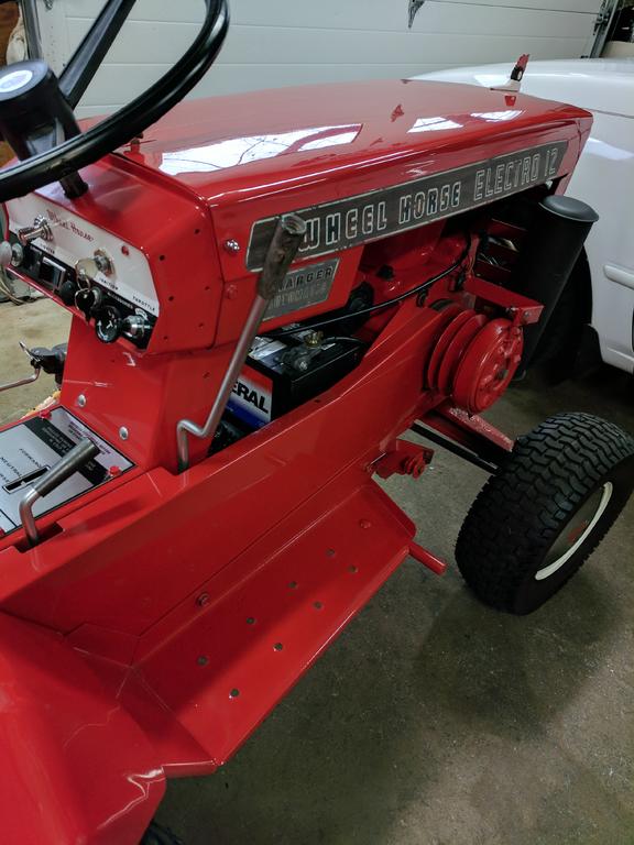

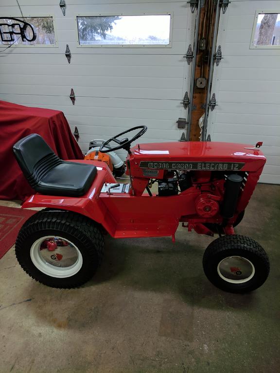

KC9KAS 4,746 #15 Posted January 23, 2019 @Eric S. Nice looking machine, and to Share this post Link to post Share on other sites
BHunter 1,701 #16 Posted January 23, 2019 Hi Eric, this is the fluid that is currently in that trans. It’s really good stuff. It is universal and synthetic. A small engine mechanic recommended it to me. 2 Share this post Link to post Share on other sites
WHX?? 55,192 #17 Posted January 24, 2019 That is one fine looking tractor Eric S & looks like someone from WHCC might have owned it. Anyone we know who might have restored it? Really a good good one. Thanks for sharing. Share this post Link to post Share on other sites
BHunter 1,701 #18 Posted January 24, 2019 39 minutes ago, WHX21 said: That is one fine looking tractor Eric S & looks like someone from WHCC might have owned it. Anyone we know who might have restored it? Really a good good one. Thanks for sharing. I did 1 1 Share this post Link to post Share on other sites
WHX?? 55,192 #19 Posted January 24, 2019 14 hours ago, BHunter said: I did I just checked your profile Mr. Hunter... says your an auto body instructor! No wonder the paint shines like a baby's bottom.... absolutely beautiful job! Share this post Link to post Share on other sites
BHunter 1,701 #20 Posted January 24, 2019 21 minutes ago, WHX21 said: I just checked your profile Mr. Hunter... says your an auto body instructor! No wonder the paint shines like a baby's bottom.... absolutely beautiful job! Haha. Thank you. That is rustoleum paint too. Imagine if it was automotive paint ,it would look even better. I left the the original decals on it and stripped the paint off around them. My plan was to buy the decals at the big show and repaint it again. The restoration photos are posted in my content from 2017. Share this post Link to post Share on other sites
