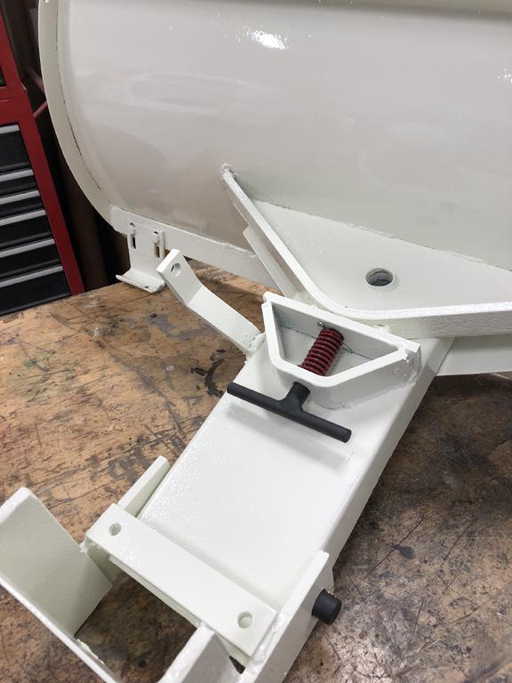

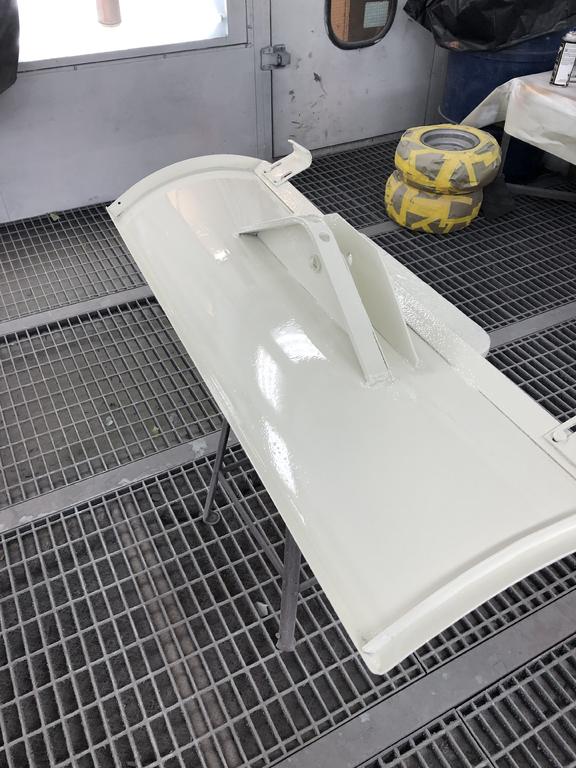

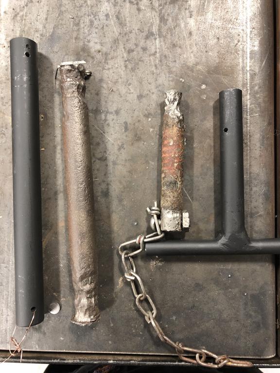

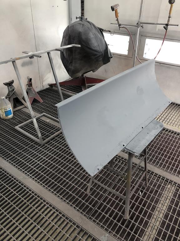

BHunter 1,701 #1 Posted January 22, 2019 I just put a lot of hours in this blade. I removed all the pieces , sand blasted, then applied epoxy primer and paint. Then I bought some round stock and replaced the extremely worn out pins. It was worth all the work. It’s good for another 60 yrs now. 1 10 1 Share this post Link to post Share on other sites
Pullstart 68,880 #2 Posted January 22, 2019 Great work! Yeah those pins look a little bit shot. 1 Share this post Link to post Share on other sites
BHunter 1,701 #3 Posted January 22, 2019 1 minute ago, pullstart said: Great work! Yeah those pins look a little bit shot. Thanks. Yes they were. There was a lot of extra movement in the brackets. 1 Share this post Link to post Share on other sites

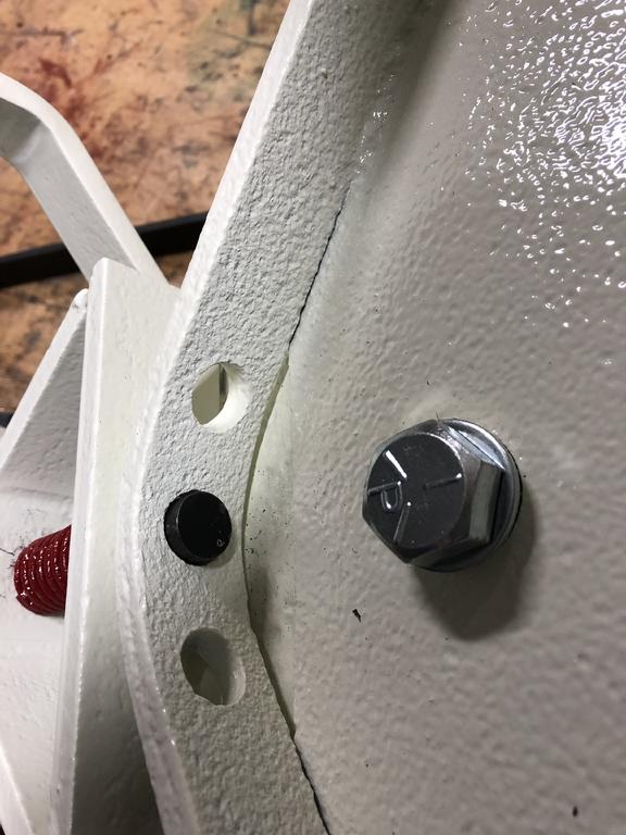

ebinmaine 77,327 #4 Posted January 22, 2019 Looks fantastic sir. Did you do anything with the holes that those pins went into or were they okay? Share this post Link to post Share on other sites
BHunter 1,701 #5 Posted January 22, 2019 13 minutes ago, ebinmaine said: Looks fantastic sir. Did you do anything with the holes that those pins went into or were they okay? Thank you. The holes were ok. I thought I was going to have to weld them up but the new pins fit good. 1 1 Share this post Link to post Share on other sites
BHunter 1,701 #6 Posted January 22, 2019 19 minutes ago, ebinmaine said: Looks fantastic sir. Did you do anything with the holes that those pins went into or were they okay? Snug fit. Looks like texture paint but it’s rust pits. It must have spent its entire life outside. 4 Share this post Link to post Share on other sites
