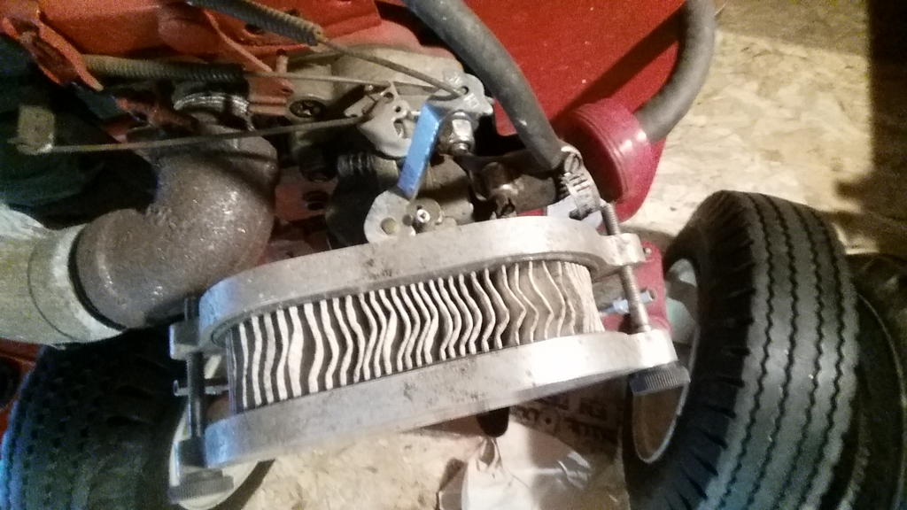

roadapples 6,987 #28 Posted January 22, 2019 5 hours ago, 953 nut said: Sorry for that small picture of the 312 air cleaner base, don't know how that happened. Seems to me this would be the way to go, unless you need it today or just like a challenge.... 2 Share this post Link to post Share on other sites
Pullstart 71,332 #29 Posted January 22, 2019 Just now, roadapples said: Seems to me this would be the way to go, unless you need it today or just like a challenge.... I do like a challenge, but I also know how to appreciate fine engineering and when not to reinvent the wheel. But I don’t know which way I’ll go yet 1 1 Share this post Link to post Share on other sites

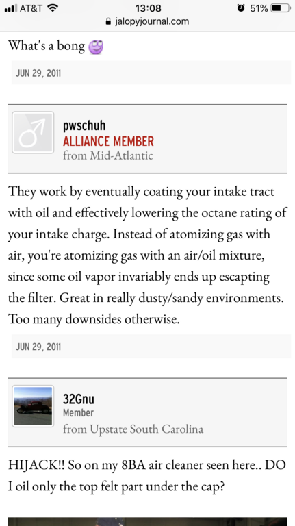

LengerichKA88 1,885 #32 Posted January 22, 2019 7 minutes ago, pullstart said: If you can manage to read through all the sarcasm English is actually my second language, most of those posts were written in my native tongue. This did stick out to me though, especially after a post above it mentioned specifically updraft carbs. I would think with front/side facing this would be a legitimate concern. Share this post Link to post Share on other sites
Pullstart 71,332 #33 Posted January 22, 2019 I agree Kyle, that is a strong negative. I liked that they work better on governed/fixed rpm engines than cars because you need a high velocity for them to work properly. my thoughts were to go from the oil bath mounted vertically next to the carb, down, U turn up, then 90 into the carb. I might even get lucky and be able to piece something together with 1” black pipe or copper/brass. 2 Share this post Link to post Share on other sites

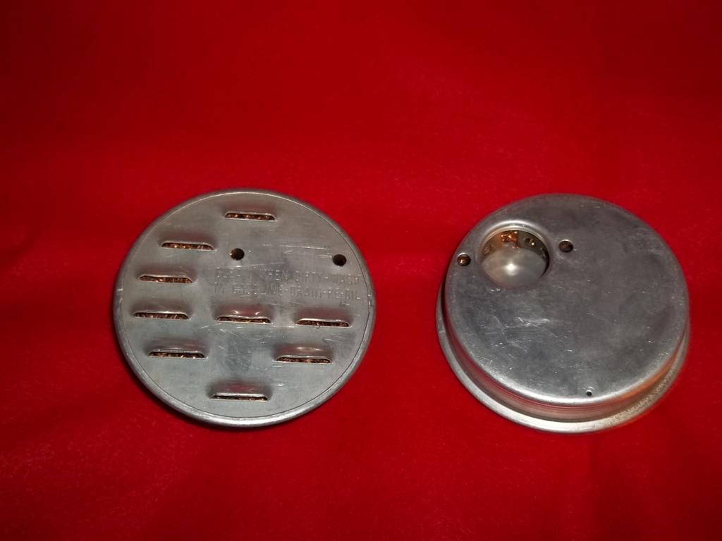

953 nut 69,572 #42 Posted January 22, 2019 (edited) Just to confuse this a little more I have some of these I could send you, they are NOS Kohler. Edited January 22, 2019 by 953 nut 1 1 Share this post Link to post Share on other sites
LengerichKA88 1,885 #43 Posted January 22, 2019 12 minutes ago, 953 nut said: Just to confuse this a little more I have some of these I could send you, they are NOS Kohler. It worked... what is it? 1 Share this post Link to post Share on other sites
bc.gold 3,406 #44 Posted January 22, 2019 The Motocross boys have it figured out, oiling the foam filter, which is what I do with my Briggs powered Deere. 1 Share this post Link to post Share on other sites
953 nut 69,572 #45 Posted January 23, 2019 4 hours ago, KyleLengerich said: It worked... what is it? They are a Kohler air cleaner, part # 210449. I got them with a batch of NOS Kohler parts. Share this post Link to post Share on other sites

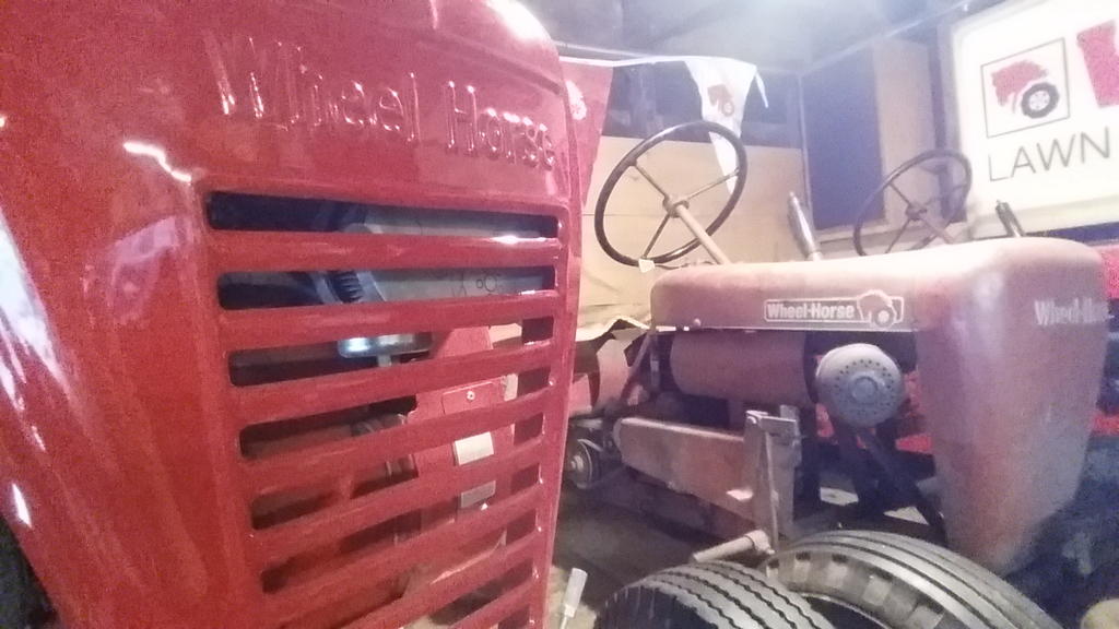

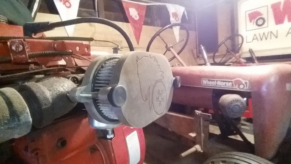

WHGuy413 2,859 #47 Posted January 27, 2019 Finally was in the garage for a short time today. After being sick a few days this week I got busy being dad. Kiddos had stuff to do and by the time we finally got all settled I was beat. Here you go. This is what my custom air filter looks like. I didn't see any problems using it. We musta just got the right size off the bat. Dad milled it out of aluminum and then added the horse logo. This is on my tecumseh h60 on my 603. 2 2 Share this post Link to post Share on other sites
