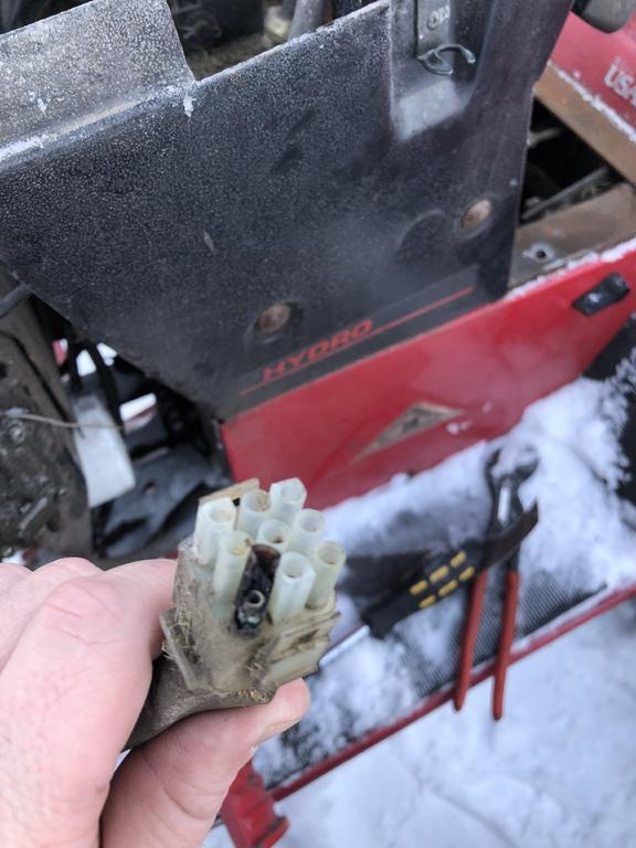

NRhode 3 #7 Posted January 21, 2019 1 hour ago, richmondred01 said: When you redid your fuse box did you make sure that the 30 amp and 25 amp were linked together? I did, sense then I’ve had it running for a little over two months Until yesterday 52 minutes ago, lynnmor said: Yes, replace the fuse block as said above. The other big issue with these tractors is the white 9 pin plug that connects the chassis to the engine, they often make a poor connection, get hot and fail. With these two items repaired as needed, the ignition switch can fail just like any tractor and safety switches can also be a pain. So to recap I need to replace the fuse block and go through it and clean the ground connections and check the 9 pin plug. For the 9 pin plug is the known issue with corrosion as well? 1 Share this post Link to post Share on other sites
richmondred01 2,333 #8 Posted January 21, 2019 Yes the 9 pin causes isssues. Be careful pulling apart. Also start off easy and check all the safety switches. 1 Share this post Link to post Share on other sites
squonk 45,407 #9 Posted January 21, 2019 My 520 had the same problem. I had to get rid of that 9 pin connector and put a better connector away from the exhaust heat. 2 Share this post Link to post Share on other sites
richmondred01 2,333 #10 Posted January 21, 2019 I did the same as squonk on two of my 520’s. If you decide to do that take your time to affirm the wires are matched. The connectors are called molex connector. Share this post Link to post Share on other sites

NRhode 3 #12 Posted January 21, 2019 7 hours ago, richmondred01 said: Yes the 9 pin causes isssues. Be careful pulling apart. Also start off easy and check all the safety switches. 7 hours ago, squonk said: My 520 had the same problem. I had to get rid of that 9 pin connector and put a better connector away from the exhaust heat. Well I’d say this would be the problem eh boys? 1 1 Share this post Link to post Share on other sites
953 nut 63,986 #13 Posted January 21, 2019 5 minutes ago, NRhode said: I’d say this would be the problem Share this post Link to post Share on other sites
richmondred01 2,333 #14 Posted January 21, 2019 Yep. There it is. Share this post Link to post Share on other sites

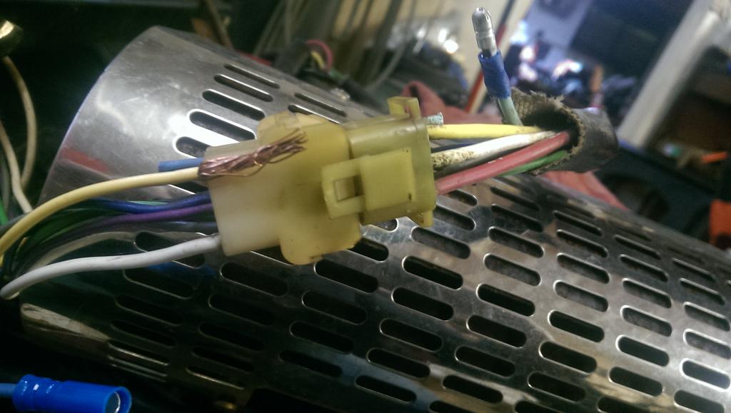

WVHillbilly520H 10,378 #15 Posted January 21, 2019 9 minutes ago, NRhode said: Well I’d say this would be the problem eh boys? I just followed the correct wiring diagrams and cut the Molex 9pin out and replaced with "bullet" connectors (heat shrink tubing and dielectric grease is your friend) and all will be good again. Share this post Link to post Share on other sites
squonk 45,407 #16 Posted January 21, 2019 I cut the wires way back and extended new wires to the other side of the tractor to get it away from the exhaust.I put the new non Molex connector on the other side. Share this post Link to post Share on other sites
