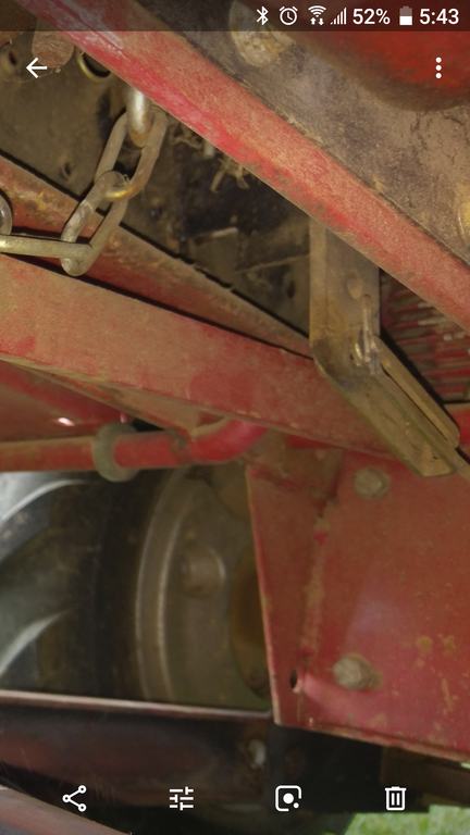

oe espo 32 #1 Posted January 20, 2019 Anyone know the phone number for the wizard to help me find a magic spell to put the hairpin in the flag. "connect lift rod stud to top hole in tractors lift arm and secure with a hairpin cotter" Manual sounds likes its doable without an adult, a child and a wizard 😤 2 Share this post Link to post Share on other sites

WVHillbilly520H 10,377 #4 Posted January 21, 2019 41 minutes ago, oe espo said: Anyone know the phone number for the wizard to help me find a magic spell to put the hairpin in the flag. "connect lift rod stud to top hole in tractors lift arm and secure with a hairpin cotter" Manual sounds likes its doable without an adult, a child and a wizard 😤 Looking at my picture the flag pin goes in the hole above the rear lift cable clevis, once the flag pin is through the rockshaft then secure it with said hair pin cotter. 1 Share this post Link to post Share on other sites
