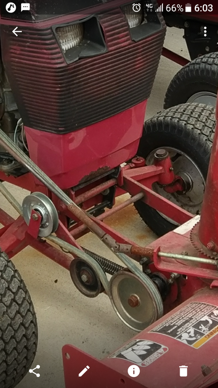

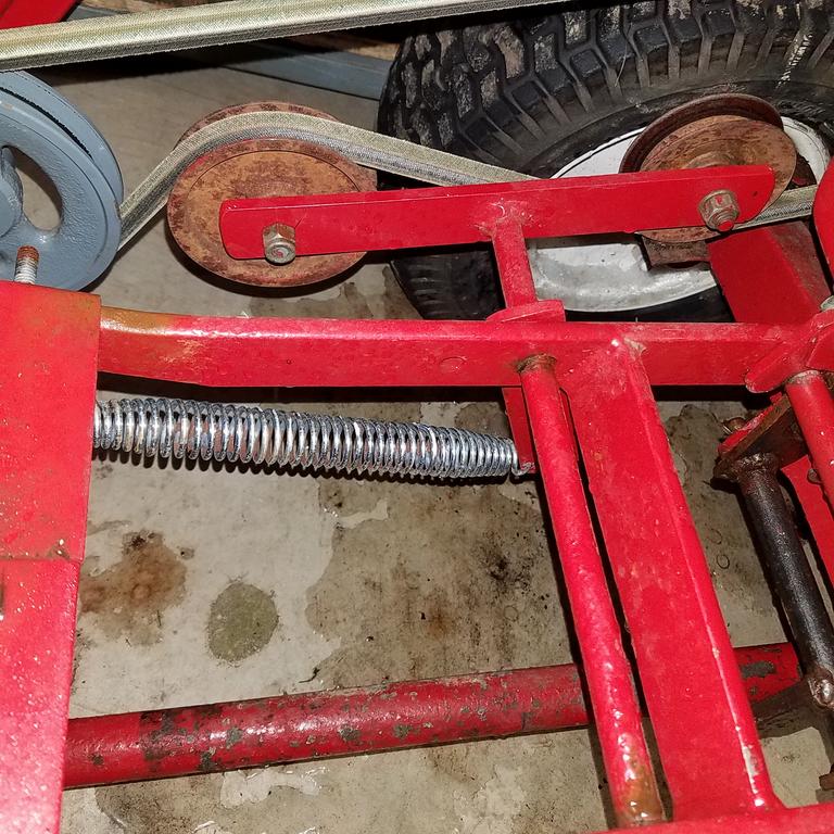

thehorse 221 #1 Posted January 20, 2019 Hello all... I was on my fifth and final driveway this morning trying to remove the slushy and frozen remainders of yesterday’s storm. I looked down when backing up and way my belt was coming apart badly but only had about 4-5 passes to go when the spring for the idler pullies broke. If I’m not mistaken the belt is a 5/8x69 vbelt and the spring seems to be about 6 1/2 inches long by about 5/8. Want to pick up parts today if possible at tractor supply. First I’d the belt correct and has anyone found a spring suitable there? thanks Share this post Link to post Share on other sites
moe1965 770 #2 Posted January 20, 2019 I got my spring at Lowe's a few years back in the aisle with springs and things nut and bolt isle. 1 Share this post Link to post Share on other sites
WVHillbilly520H 10,377 #3 Posted January 20, 2019 2 hours ago, thehorse said: Hello all... I was on my fifth and final driveway this morning trying to remove the slushy and frozen remainders of yesterday’s storm. I looked down when backing up and way my belt was coming apart badly but only had about 4-5 passes to go when the spring for the idler pullies broke. If I’m not mistaken the belt is a 5/8x69 vbelt and the spring seems to be about 6 1/2 inches long by about 5/8. Want to pick up parts today if possible at tractor supply. First I’d the belt correct and has anyone found a spring suitable there? thanks Yes the belt is 5/8"x69" and I did get my last couple at TSC, they also have springs there I'm sure if one is a bit long you can always shorten it. Share this post Link to post Share on other sites
