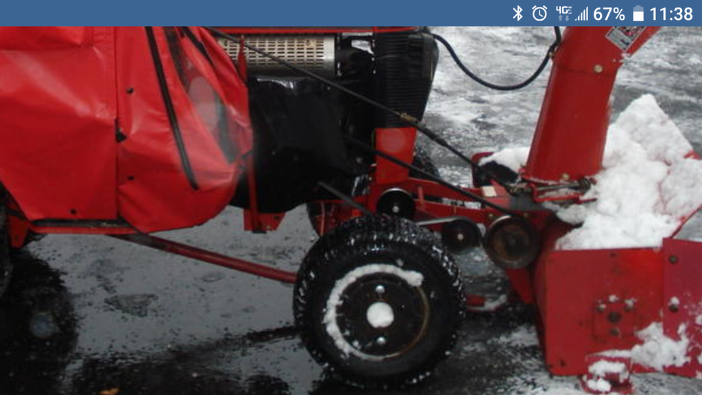

pabird 40 #1 Posted January 20, 2019 This blower attaches to the tach-o-matic right? Does it pivot on it also so it can be raised and lowered? If so what controls the pivoting action? My friend wants to hang one on his 310-8 and isn't sure he has all the hardware or an understanding of how it all works. I haven't been able to find a manual with enough detail. Share this post Link to post Share on other sites
WVHillbilly520H 10,376 #2 Posted January 20, 2019 Yes it fits into the front attach-a-matic, then you need the lift tube (approximately 3.5' long) and the "flag" that pins onto the center rockshaft 2 Share this post Link to post Share on other sites
