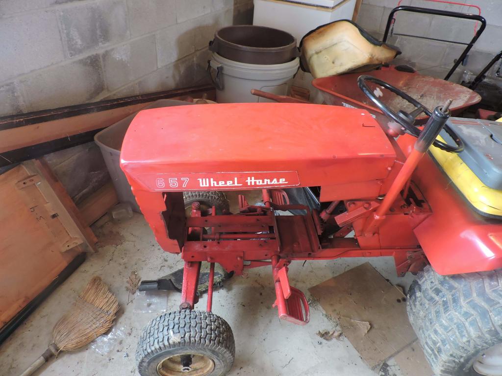

Bumper1990 4 #14 Posted January 31, 2019 2 minutes ago, ebinmaine said: That 657 is worth $75 all day everyday even without an engine. It could be a great little tractor with the right horizontal shaft engine mounted on to it. Pics would definitely help. I'm trying to upload them they don't seem to want to upload tho I'll keep trying it is in pretty nice shape needs the knobs and odds and ends stuff though. This may sound dumb but will any horizontal Tecumseh fit it within the respectable horsepower? Share this post Link to post Share on other sites

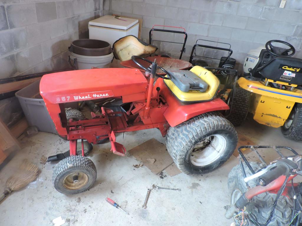

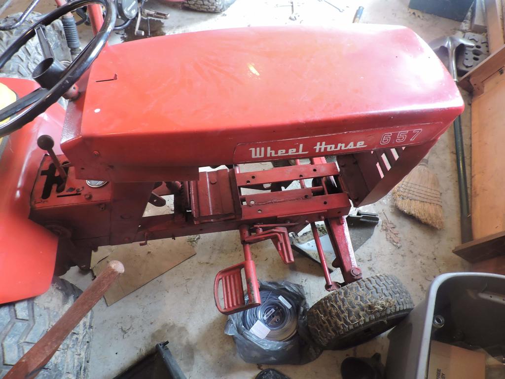

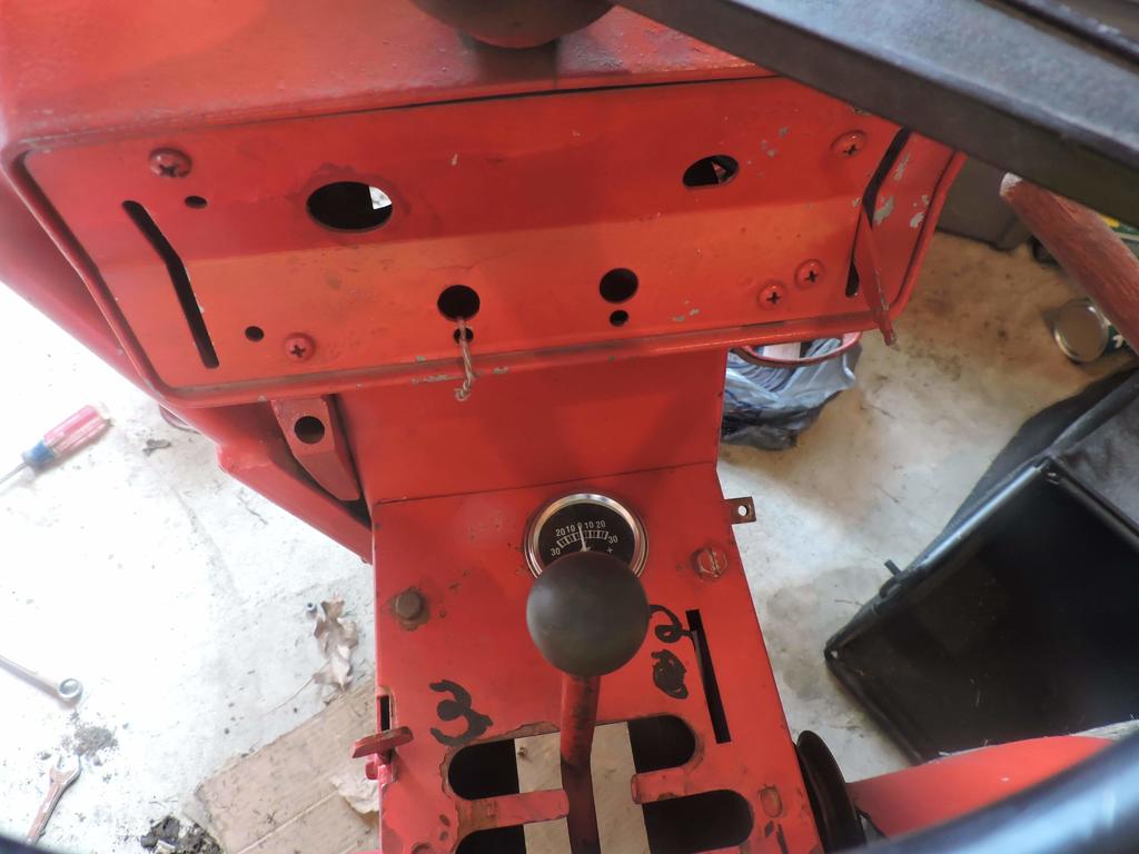

Bumper1990 4 #16 Posted January 31, 2019 Got pics up guys Share this post Link to post Share on other sites

953 nut 63,172 #20 Posted January 31, 2019 That is a nice looking 657, when you buy it be sure to ask about the belt guard, you will need it. This 1977 sales flyer shows the "B-81" as being a Garden Tractor with a horizontal crank engine. If it is not a '77 then it will be vertical. 1 Share this post Link to post Share on other sites

ebinmaine 75,916 #22 Posted January 31, 2019 6 minutes ago, Bumper1990 said: Got pics up guys That's not a bad-looking rig at all. Hard to tell exactly what you're going to need until you get going into it. One would hope that maybe a quick freshening up on the paint and some new seals and belts and stuff and you'd be up and running. Really never know until you tear into it. Has a later model Dash with the up and down slides. As opposed to the pull style cables. 2 minutes ago, Bumper1990 said: asking all you guys is it worth it? That's a question that ONLY YOU have the answer to. Me and Trina?? (She likes the little square hoods) Oh yeah.... Definitely worth it in our opinion. Share this post Link to post Share on other sites
