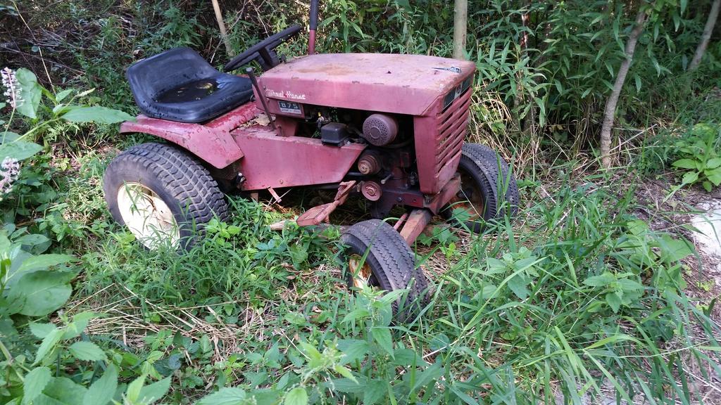

bottjernat1 2,196 #1 Posted January 16, 2019 Will the deck from my daughters 1969 charger automatic fit on my other daughters 875? without modifying it. I was just curious. My daughters 875 has sat for 2 years now. This spring im going to get her fired up again. Its never had a deck on it. If it wont can some post a picture of the right deck for the 975 so i know what im going to have to look for? Thanks and everyone have a good day! 1 Share this post Link to post Share on other sites
The Tuul Crib 7,347 #2 Posted January 16, 2019 There might be a difference in the tractors by way of the frames I believe the charger is a long frame and the 875 is a short frame . 1 Share this post Link to post Share on other sites
bottjernat1 2,196 #3 Posted January 16, 2019 3 minutes ago, The Tool Crib said: There might be a difference in the tractors by way of the frames I believe the charger is a long frame and the 875 is a short frame . I wasnt sure i thought that might be the case. that 875 my late dad gave all the grandkids a tractor and i have taken care of it to an extent she is the 2nd other horse sitting outside i plan on making room in the spring to get it inside. i put a fresh oil change in it when parked and stabilizer in the gas. it runs really good. that is the first year for the hydro transmission correct? I dont have anything for it a deck snow plow anything. i would like to get a deck on every horse i own(or my girls own) LOL. thanks tool crib 1 Share this post Link to post Share on other sites

Ed Kennell 45,029 #6 Posted January 16, 2019 (edited) No, you could not use a 3 blade center drive deck on a tractor designed for a 2 blade gear drive deck without major rebuilding of the 875. Including the installation of a PTO and a mule drive and possibly lengthening the frame. Yes, the 875 was the first WH with a hydro transmission. Edited January 16, 2019 by Ed Kennell 2 Share this post Link to post Share on other sites
The Tuul Crib 7,347 #8 Posted January 16, 2019 There's a horse in the jungle !! 1 Share this post Link to post Share on other sites
bottjernat1 2,196 #9 Posted January 17, 2019 18 hours ago, The Tool Crib said: There's a horse in the jungle !! it is now at my mother in laws. I saved it and brought it closer to home. it was at who i thought was a friends place. but they along with my adopted family stabbed me in the back and has taken over almost all of the equipment i saved that was my late dads. It hurts to see that the stuff is going to just rot or my sister will sell it to who ever. But i do have plenty to keep me busy the rest of my life. I am moving forward with my life. I didnt fight with them. I let it go. My late dad wouldnt have wanted me to fight! Karma with get them all! Share this post Link to post Share on other sites
