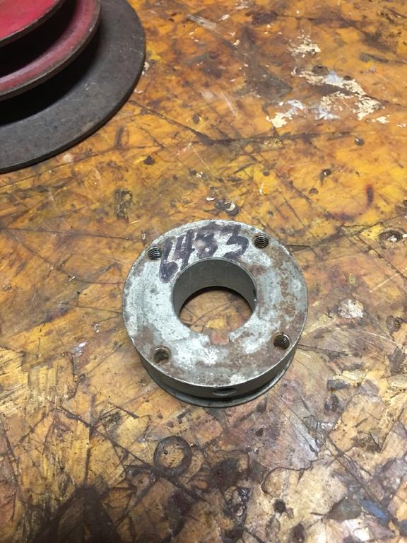

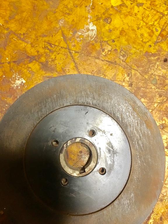

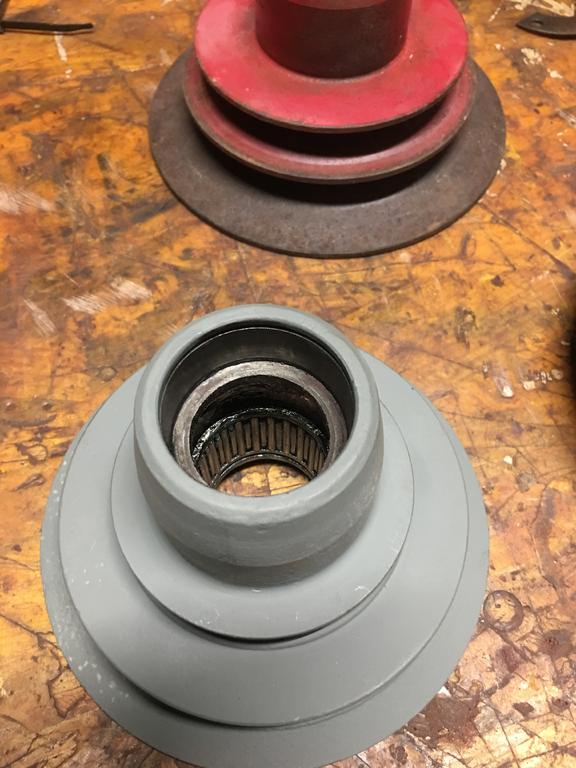

The Tuul Crib 7,340 #3 Posted January 15, 2019 The first pic is the correct pulley needed for this motor 6483. Which had a 10 horse to begin with.The second pic is the 7 inch clutch disk which the holes lineup perfectly with the pulley. The last pic is the correct bell and it is a 6 inch . Seems as though everything should fit properly . 1 Share this post Link to post Share on other sites
