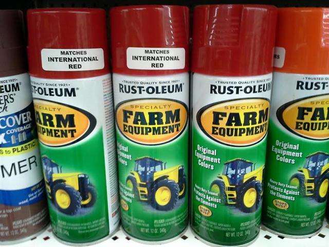

ebinmaine 77,327 #14 Posted January 15, 2019 6 minutes ago, The Tool Crib said: What brand of spray can and how long of cure time? Rust-Oleum 2X.... ONLY. At room temperature it dries to usable in a couple days but really does not fully cure for as much as a month. That's not much of an issue for a lot of builds because it takes as long or more to get one done. You may very well be aware but Trina is the one that does 99% of the spraying here at our location because she has better patience and control than I do. She really likes the way that stuff lays out and it's not prone to running... If... You spray it in light layers. 2 Share this post Link to post Share on other sites
gwood 16 #15 Posted January 15, 2019 10 hours ago, BHunter said: Hi. Welcome to RedSquare. I’ve been a car / tractor painter for over 30 yrs. I can help you with your questions. Bob Hi Bob Thanks so much for your willingness to help me on the painting process! Here is a couple of ones that will help me with my restoration. I did completely tear down my 42" WH side discharge mower deck and painted it totally with Rust-oleum Painter's Touch 2X Ultra cover paint and primer, Gloss After 1 year of mowing, that I painted under the deck is completely gone! Does folks use the same paint totally on the decks? I'd appreciate knowing what paint you use, what type of sprayer, do you always completely tear down the item your painting? I see a lot of discussion on rear wheel weights and I recently purchased a GT 1100 for parts and it had them on it, The # is 1307H1 and was mounted on the outside of the rims. What color paint do you use for the rims, black for some areas and the light gray on the GT 1142 hood and fenders, etc? Hope to hear from you! gwood Share this post Link to post Share on other sites

ebinmaine 77,327 #18 Posted January 15, 2019 6 minutes ago, The Tool Crib said: I think on this build that I'm doing now I'm going to tractor supply in buying a couple quarts of the regal red and the catalyst or hardener to put in it. And possibly a clear on top to make it a little shiny . I think that would give you the best bang for the buck so to speak. I think it's important to note as a point of information that the reason we use spray cans is for convenience. I do now have a compressor but I still do not have a spraying setup. We are not super concerned with that being one of our purchases because we are not trying to restore these tractors to showroom condition. Ours are all workers and will likely remain that way so the durability of paint for us is of less concern. Share this post Link to post Share on other sites
bottjernat1 2,196 #19 Posted January 15, 2019 (edited) I used rustoleum international red for my motor. a body shop used the same on my rj58 years ago. turned out pretty good. im not sure what white they used. but when i go to redo another i will use this white im thinking Edited January 15, 2019 by bottjernat1 Share this post Link to post Share on other sites
ebinmaine 77,327 #20 Posted January 15, 2019 1 minute ago, bottjernat1 said: I used rustoleum international red for my motor. a body shop used the same on my rj58 years ago. turned out pretty good. im not sure what white they used. but when i go to redo another i will use this white im thinking That one would be pretty close. In the 2 X Series we use Navajo white. On my Cinnamon Horse c-160 the engine, Wheels, Dash, and Hood stripe are already or will all be that color 1 Share this post Link to post Share on other sites

bottjernat1 2,196 #22 Posted January 15, 2019 9 minutes ago, The Tool Crib said: Have to agree with you there! It is a lot easier to use spray cans. I did that on my 855 and it didn't look half bad! my rj is show room ready she was mostly done by a body shop. but the motor i did. i put 2 coats of primer 2 coats of paint and 2 coats of clear. i now have everything to do painting myself i am just working on other peoples crap so i havent made time to tare down a horse and see what i can do. i am very proud of my rj alot time and money wen into it. i am glad my late dad got to see it before he passed away. He was super proud of it. i got it complete in 2015. it shines like a new car. i was impressed with the ol rattle can job i did on the motor. but my late dad and i restored many tractors this way. we did a hole 3010 john deere when i was a kid. it turned out ok. LOL! i agree tho a spray gun is a much better way to go. Share this post Link to post Share on other sites
