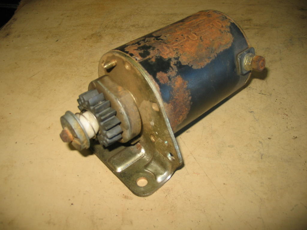

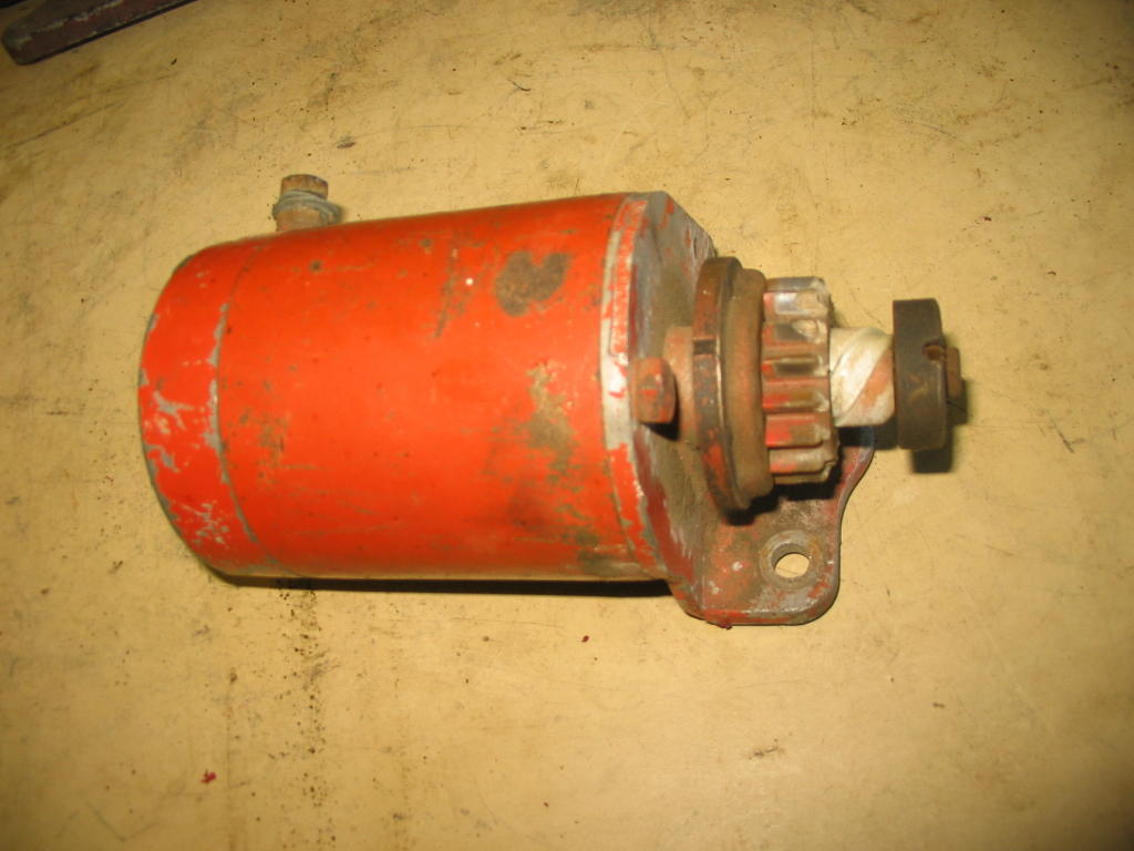

daveoman1966 3,841 #4 Posted January 14, 2019 I have two useable starters from Briggs vertical engines. $15 each, plus ship from zip 16443. Bendix gear on the black one is better. Share this post Link to post Share on other sites

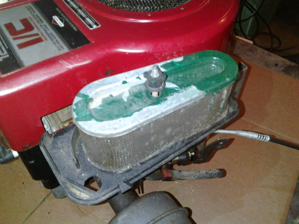

wildman 205 #5 Posted January 14, 2019 11 hours ago, ohiofarmer said: I found out more about this engine. It is a model 289707 Type 0154 01 and code 9503304E It is a 12.5 horse IC engine with a cast iron sleeve The Air cleaner base is cracked and is NLA the part number is 696129 https://www.partstree.com/parts/briggs-and-stratton/parts/696129/ It also needs a starter. The starter power cable broke off the starter. A whole starter should not be that difficult to come by from a blown engine. Take a picture of the air cleaner base and post it odds are i have it Share this post Link to post Share on other sites
ohiofarmer 3,372 #7 Posted January 15, 2019 Here it is. I also posted it on Nick's build thread Share this post Link to post Share on other sites
wildman 205 #8 Posted January 15, 2019 I have that one it is setting on the bench Share this post Link to post Share on other sites
ohiofarmer 3,372 #9 Posted January 15, 2019 (edited) That should work out well. The engine is going to Carelton , MI. How much do you want for the part? Edited January 15, 2019 by ohiofarmer Share this post Link to post Share on other sites
wildman 205 #10 Posted January 15, 2019 I told him it was his for the cost of shipping 1 Share this post Link to post Share on other sites
