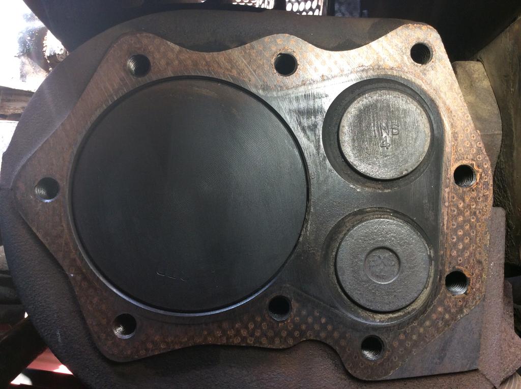

Blackhood Bill 728 #30 Posted January 14, 2019 Ok, after doing some reading on ACR, I also read, on my tractor forum, what about valve lash being to tight? Would this disable the ACR? Since I don't know anything about repairs that was or could have been made to this Kohler K321, I guess I should read the service manual and just kinda check everything. I have also cleaned off the top of the surface area where gasket sits and the top of the valves and no it does NOT look to have been sleeved. 1 Share this post Link to post Share on other sites
oldredrider 2,553 #31 Posted January 14, 2019 A sleeve would be obvious. You could visually see it...about 1/16" in cylinder. Share this post Link to post Share on other sites

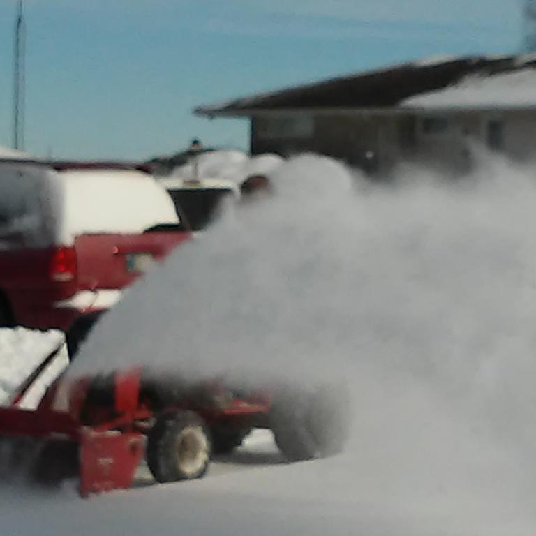

Blackhood Bill 728 #36 Posted January 17, 2019 Thanks to all my friends here THANK YOU IM BACK UP AND RUNNING AND READY FOR THE SNOW. The C-145 even sounds better now! I'm am so thankful I found this forum. Hope to meet you all in the future! 1 1 1 Share this post Link to post Share on other sites

Blackhood Bill 728 #38 Posted January 20, 2019 After blowing spark plug out of head, replacing head, replacing spark plugs and, I finally got some seat time and the satisfaction of knowing the is back up and running strong as ever. 1 2 Share this post Link to post Share on other sites
