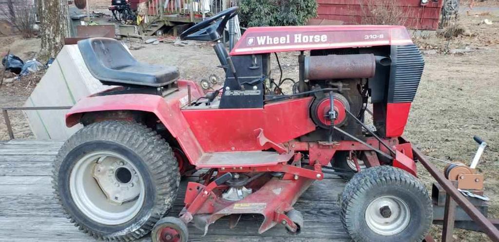

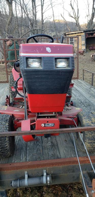

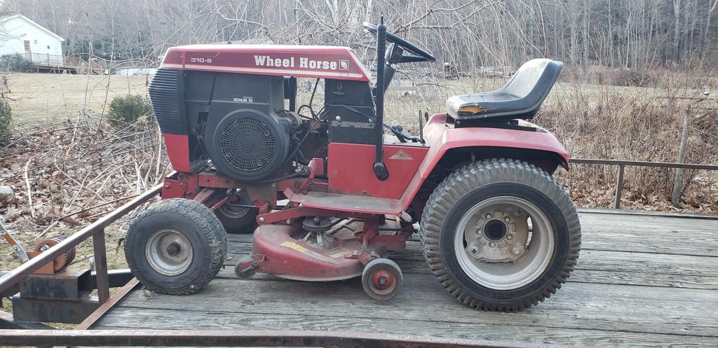

WHGuy413 2,841 #1 Posted January 13, 2019 A friend of mine had been after me for over a year to buy his 310-8. He called me to tell me to just come take it cause he was sick of moving it around. Nice straight tins and the paints in good shape. Needs a little bit but should run. Not bad for the price of free. 6 8 Share this post Link to post Share on other sites

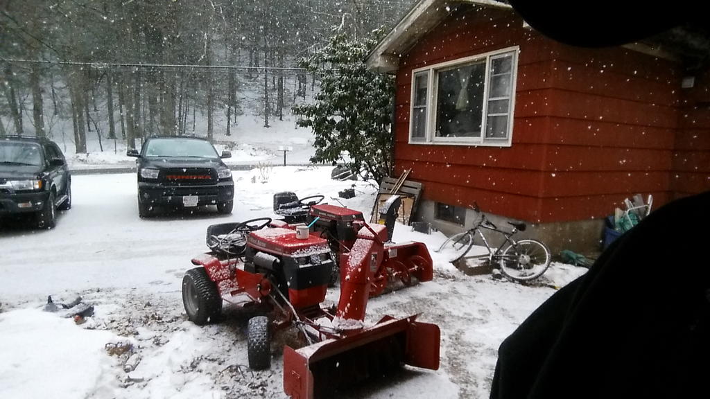

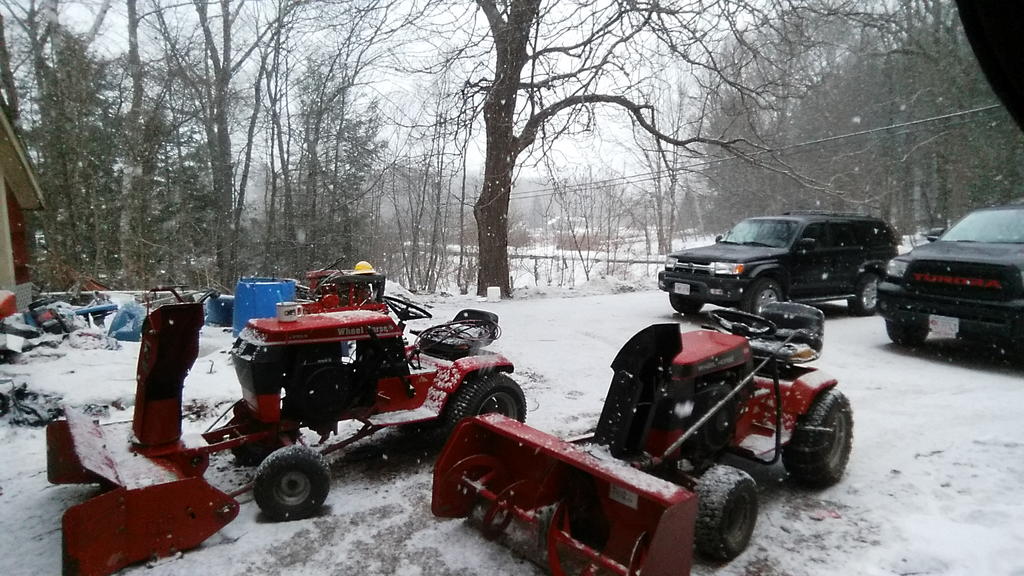

WHGuy413 2,841 #14 Posted January 27, 2019 The brother in law finally saw the 310-8 heard it run and drove it and loved it. Still trying to figure out the snow thrower. Who woulda thought it would since it came off a vertical shaft that it would spin backwards. Dad and I are competing to figure out how to make it work right. And yes before anyone says anything that is a John Deere mug on the hood of the 310 lol. My daughter made me hot chocolate and brought it out. And i love all old iron when it comes to big tractors. 3 Share this post Link to post Share on other sites
The Tuul Crib 7,340 #15 Posted January 28, 2019 How much was it again ? Free you say? Can you aford it .! 1 Share this post Link to post Share on other sites
WHGuy413 2,841 #16 Posted January 28, 2019 25 minutes ago, The Tool Crib said: How much was it again ? Free you say? Can you aford it .! I made a deal with my brother in law that he could have the tractor for what ever I put into it. So far I'm into for 16.99. It needed a new choke cable. Forgot I had a old junk 310 out back. Choke cable was still working perfectly so I pulled that. He will get it for a fairly cheap price. The snow thrower came from my dad. He found it in the scrap pile at work. 1 1 Share this post Link to post Share on other sites
953 nut 62,639 #17 Posted January 28, 2019 (edited) 13 hours ago, WHGuy413 said: Still trying to figure out the snow thrower. Who woulda thought it would since it came off a vertical shaft that it would spin backwards. Dad and I are competing to figure out how to make it work right. If you run a slightly longer belt and have it do a figure eight at the longest point it should get it spinning in the correct direction. Edited January 28, 2019 by 953 nut fat finger Share this post Link to post Share on other sites
WHGuy413 2,841 #18 Posted January 28, 2019 11 minutes ago, 953 nut said: If you run a slightly longer belt and have it do a figure eight at the longest point it should get it spinning in the correct direction. Yeah but my only concern is then the belt will be rubbing against itself on the pass. Trying to figure out a idler that keeps them apart enough but not pull them out of the pulleys. Share this post Link to post Share on other sites
