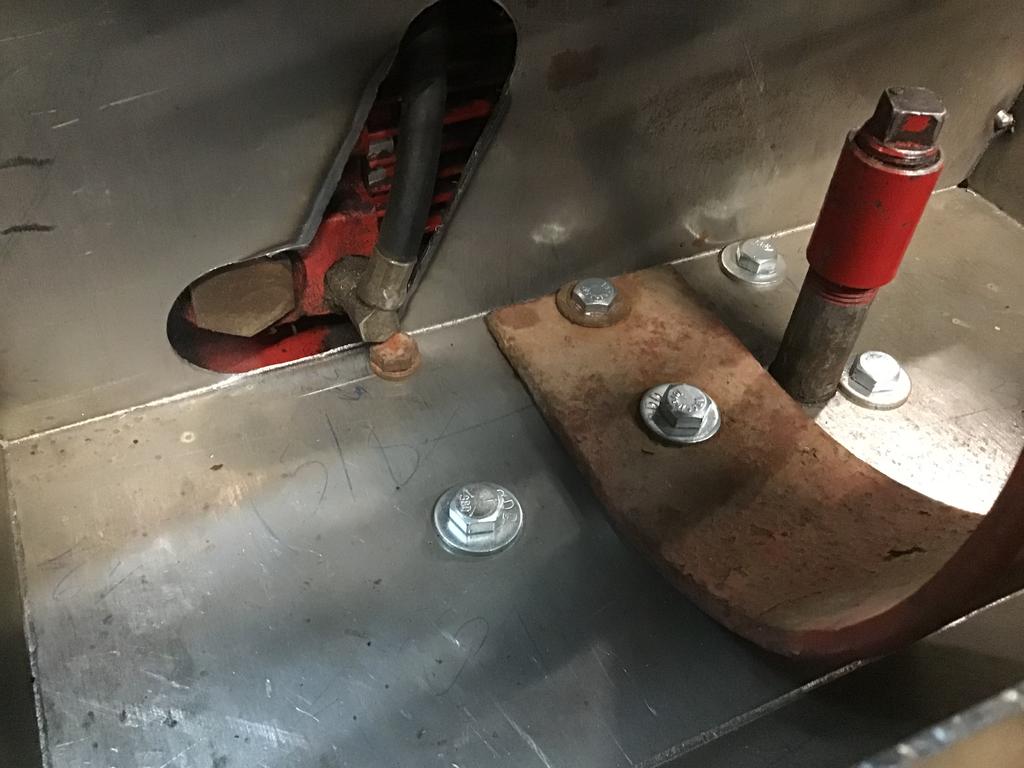

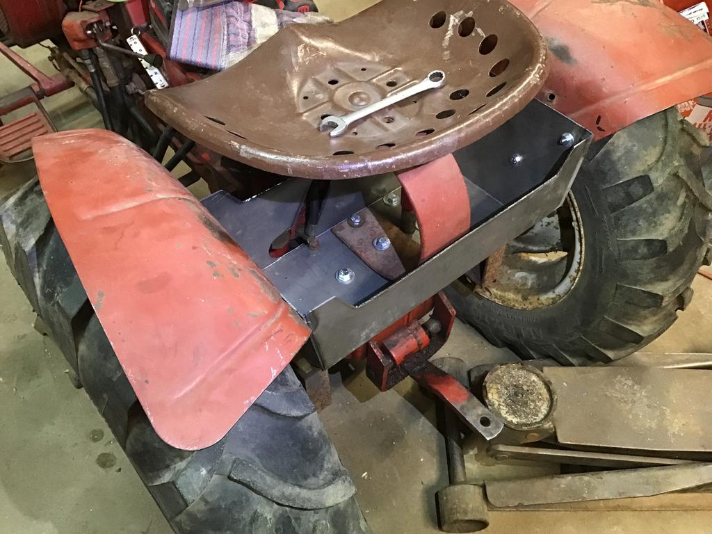

Pullstart 68,675 #1 Posted January 13, 2019 I just realized that I will need to remove the rear hydro line on Frank to do final assembly some day. Due to the seat adapter I made, the 1-1/2” bolt won’t clear the fitting until it’s tight. Now, this line is well above the fluid level, but I assume the pump holds fluid too? How much Tran fluid should I expect to loose when I pull the hose? Drops, or a significant amount? Share this post Link to post Share on other sites

Pullstart 68,675 #8 Posted January 13, 2019 13 minutes ago, gwest_ca said: How are you going to remove the hose? Is it a magic push-on connection? Garry 4 minutes ago, pfrederi said: Open end wrench working down from the top in front of the tool box 1/12th of a turn at a time.... I should be be able to get to it from inside my new tool box, with the seat removed fairly easy. 2 Share this post Link to post Share on other sites

Pullstart 68,675 #10 Posted January 13, 2019 2 minutes ago, 953 nut said: Knowing there will be a little leakage you can just fill the area with rags prior to breaking the fitting loose. Could you use a stud and nut in place of the 1 1/2" bolt to overcome the interference? I still need to get the spacer bolted in, and I’ve a feeling the thickness of it is causing my hiccup. A stud is a great Idea, but I’m not sure if it’ll help me. I do however plan to change the fluid before my build is finished up. I might drain the system first, then do the assembly, then fill it up. Share this post Link to post Share on other sites

roadapples 6,986 #12 Posted January 13, 2019 (edited) When you disassemble to paint, I would notch that hole into a slot so you only need to loosen the bolt slightly instead of removing. And maybe use a larger washer.... Edited January 13, 2019 by roadapples Speeling 1 Share this post Link to post Share on other sites

Pullstart 68,675 #14 Posted January 13, 2019 6 hours ago, roadapples said: When you disassemble to paint, I would notch that hole into a slot so you only need to loosen the bolt slightly instead of removing. And maybe use a larger washer.... That’s a great idea! After all, these holes used to hold down sheet metal and now a 3/4” thick block has been machined to take the sheet metal’s place. I could probably plug the hole and silicone a bolt head in place for all it matters, but a slotted hole might work out! 1 1 Share this post Link to post Share on other sites
