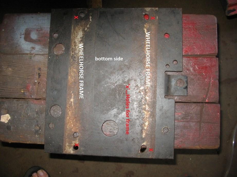

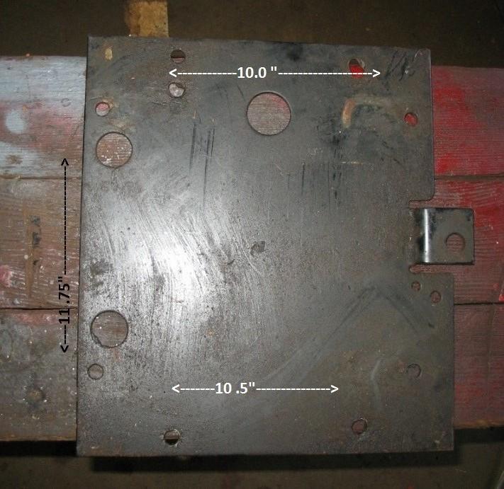

Here are the dimensions of the 520H engine plate...
  • Like 3
rj24
ok thanks it that tab bent up or down
daveoman1966
In the top p[ic. tab is UP.  The 2nd pic is the flip side, so tab is DOWN.

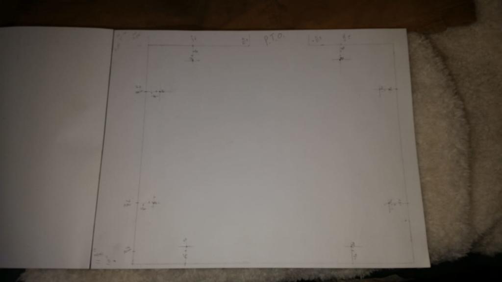

ok thanks whats the hole from the center of the frame  to the outer end of the plate the top and bottom
rj24
here's what I got so far
