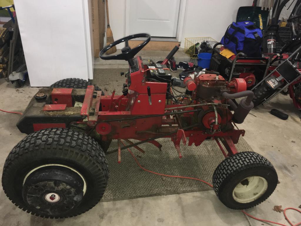

JerryB 12 #3 Posted January 10, 2019 Hey thanks a lot. I’ve got a 78’ c81 and a 78 B100. I’ve got the C81 apart. My dad just bought a new sandblaster. And it worked out real nice taken off rust and old paint. I’ll try to upload some before and after. 2 Share this post Link to post Share on other sites

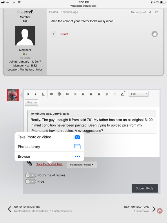

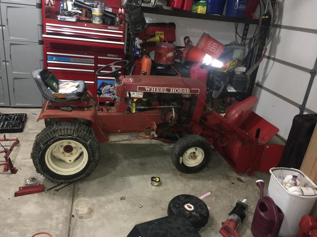

JerryB 12 #5 Posted January 10, 2019 Really. The guy I bought it from said 78’. My father has also an all original B100 in mint condition never been painted. Been trying to upload pics from my iPhone and having troubles. A ny suggestions? Share this post Link to post Share on other sites

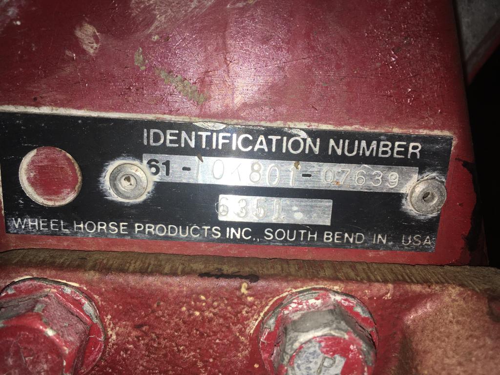

JerryB 12 #6 Posted January 10, 2019 I’m gonna get a few pics of tractor vin. And research year. Share this post Link to post Share on other sites

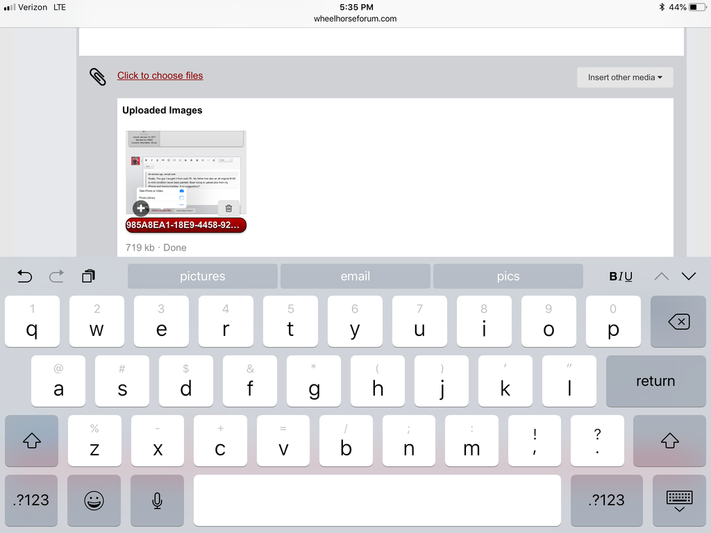

Pullstart 66,692 #8 Posted January 10, 2019 40 minutes ago, JerryB said: Really. The guy I bought it from said 78’. My father has also an all original B100 in mint condition never been painted. Been trying to upload pics from my iPhone and having troubles. A ny suggestions? If you can find “click to choose files” do that, then select “photo library” then click what pictures you want, then done. They’ll pop into the uploaded images then you can submit your post... Share this post Link to post Share on other sites
JerryB 12 #10 Posted January 10, 2019 Got it thanks a lot. Do you know the year. Of the B100 1 Share this post Link to post Share on other sites

rmaynard 16,293 #12 Posted January 11, 2019 61-10K801 is a 1976. The Julian date (6351) indicates that your B-100 came off the assembly line on the 351st day of 1976, December 16. 2 Share this post Link to post Share on other sites

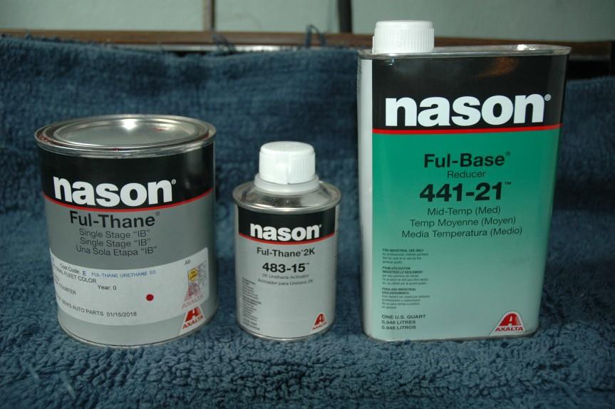

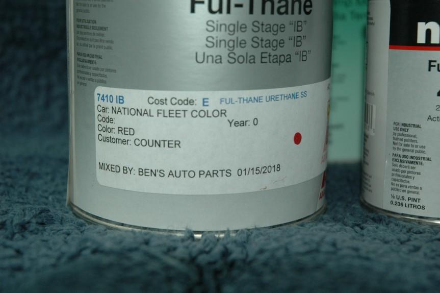

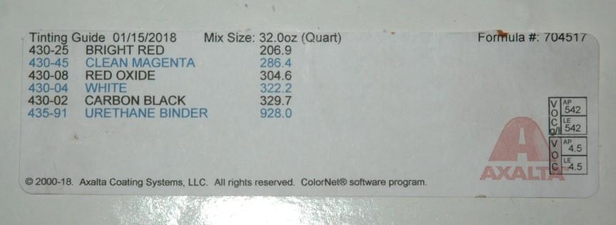

jebbear 386 #14 Posted January 11, 2019 1 hour ago, c-series don said: So I believe that the consensus here on Red Square is that what color red you choose is your Wheel Horse red! For my , this is what I just used on my 1966 Model 856 and I am extremely happy with the results, very close to my original color as near as I can tell. International Harvester IH-50 1 Share this post Link to post Share on other sites
