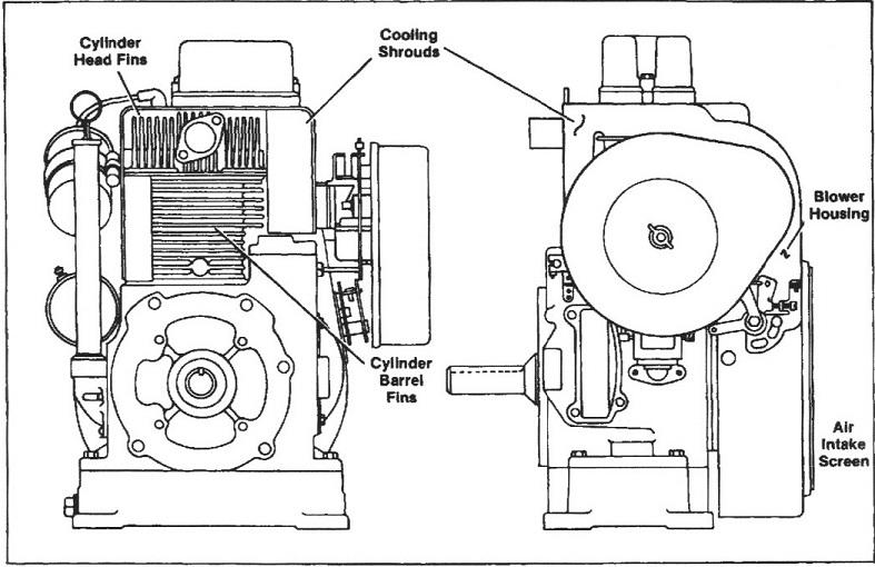

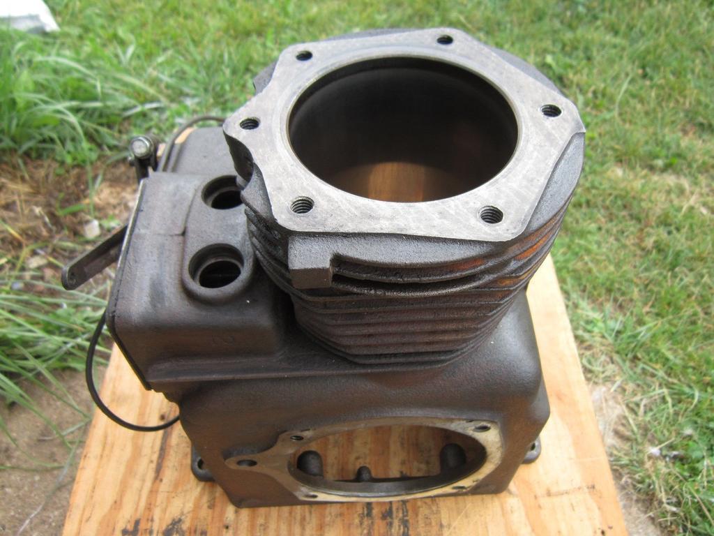

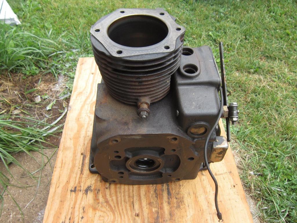

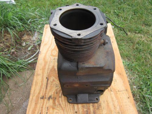

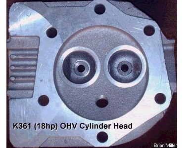

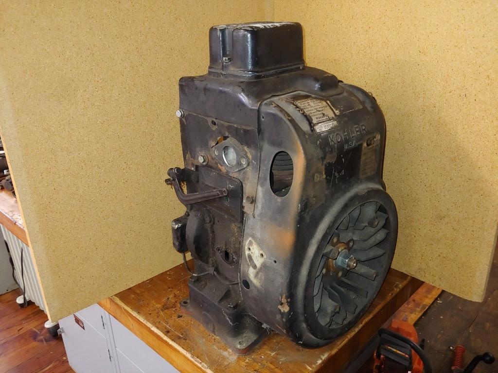

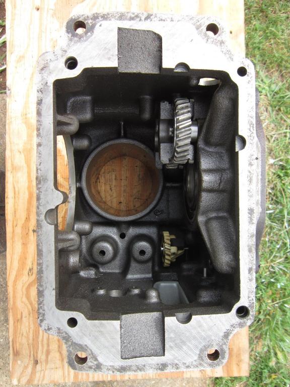

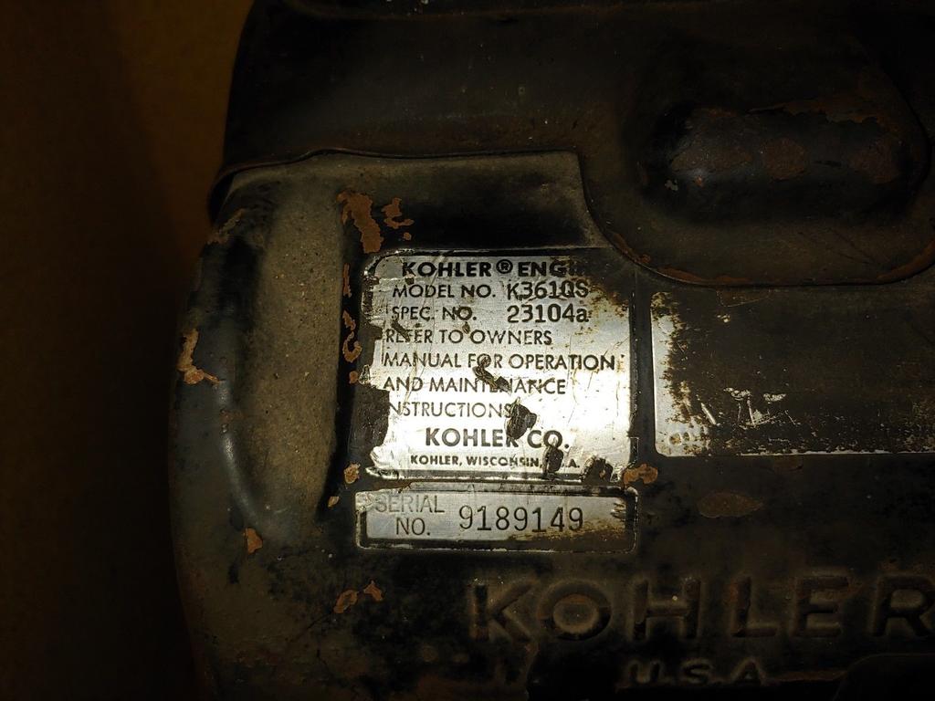

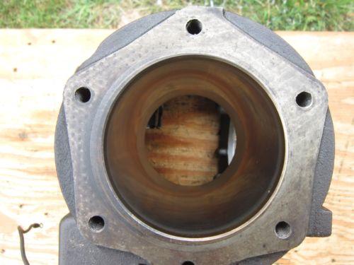

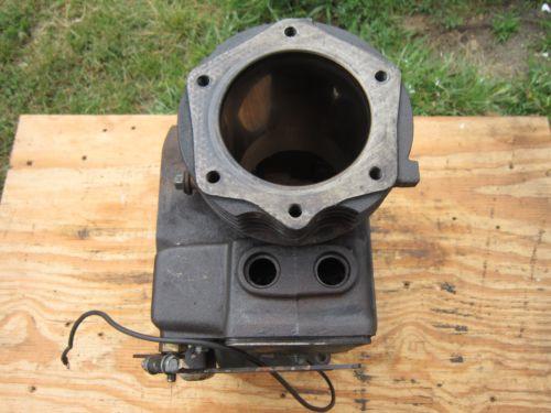

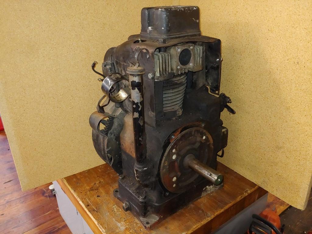

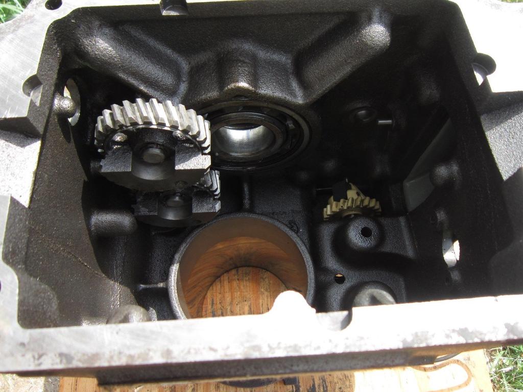

ztnoo 2,302 #9 Posted January 8, 2019 (edited) The look of a K361 OHV is very unique visually compared the all the other valve-in-block K series engines. You could actually tell the difference from 50-75' away if the engine is exposed at all. The K361 shares the same bore and stroke dimensions with the K341 (3.750" x 3.250") = 35.90 cu. in. (588cc) The compression ratios however, vary a great deal: 7.3:1 (K341) to 9.2:1 (K361) K341 is a 10 bolt head, while the K361 is a 6 bolt head. The valve sizes vary marginally as well: K341; Intake: 1-3/8", Exhaust: 1-3/8" / K361; Intake: 1-7/16", Exhaust: 1-13/32". Engine code number can identify each clearly also. Code (71) = Model of Engine (K341); Code (23) = Model of Engine (K361). K361 head: They both have rod dippers and splash lube. The 2 HP difference comes from the OHV and cam. The rockers on the K361 are oiled by the splash and vapor of the common K Series bottom. They supposedly were only made in 1979-1980. While they are rare, its generally believed to be because they had issues enough that they quit production. Not enough oil gets to the rockers, and valve seats come out. "K361's lack of oil to the rockers and valves is because of a design flaw in the location of the crankcase breather. The top of the engine builds pressure therefore keeping the oil from reaching the top in sufficient quantities. It is a simple fix to get the oil up to the rockers. Block off the factory crankcase breather and install one in the aluminum valve cover on top of the engine. You will have to cut the factory valve cover to insert a breather. Once the top of the engine can breathe it will oil fine. Think of any other engine with overhead valves and where the crankcase breather is. Kohler really dropped the ball on this one." * http://gardentractortalk.com/forums/topic/16803-kohler-k361-any-good/ There is actually one off a Power King for sale at that well known auction site. Pics from the listing: https://www.google.com/url?sa=t&rct=j&q=&esrc=s&source=web&cd=1&ved=2ahUKEwjwiJfj8N7fAhUELK0KHfjbCc4QFjAAegQIBxAC&url=http%3A%2F%2Fkohlerengines.com%2Fengines%2Fonlinecatalog%2Fpdf%2Ftp_1288.pdf&usg=AOvVaw1p06NV2wXpPPfkzsoVdnz_ Addendum: K361 block pics: Edited January 9, 2019 by ztnoo 3 2 1 Share this post Link to post Share on other sites
