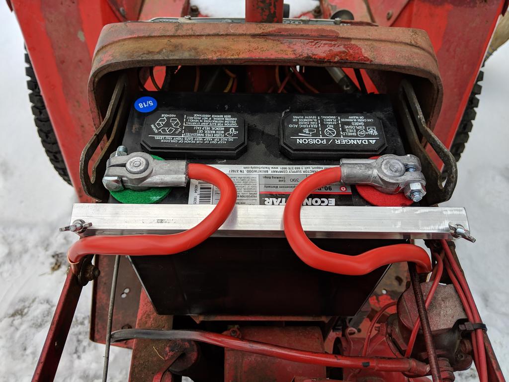

WildmanC120 613 #1 Posted January 4, 2019 I picked this up a few weeks ago as you all know. I have not touched it since. Even though we got some snow last night, it was a decent day here at almost 40 degrees. Got myself a battery as the old one was a tiny atv battery and no good. Also made some new cables to match the battery. Ignore the red negative cable as that's all they had in stock. I'll put some black heat shrink on it later but it works for now. I also made that battery hold down clamp as the stock one was missing. Replaced the muffler too as it was full of holes. Engine runs pretty well although it is down on power and smokes pretty good. Ill either replace it with a 16hp or rebuild this one and maybe add a cam and a long rod setup. We will see what happens but it runs for now so it will allow me to work on the trans. As for the trans as you can see it goes forward ok. Seems to have good power going forward. Was unable to really test it as the ground is covered in snow. Reverse...that's another issue. Reverse is pretty gutless and does not work very well. I cannot tell how much oil is in the trans as its really hard to see on the dipstick, but there is oil in it and and it will drip off the bottom so I know there is at least dipstick level in it. The hydro lift works OK so I don't think I have serious issues. I'll probably start by draining the trans, replace filter and fill with new ATF. 1971 Wheel Horse GT14 5 Share this post Link to post Share on other sites
