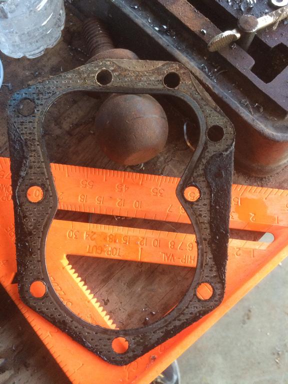

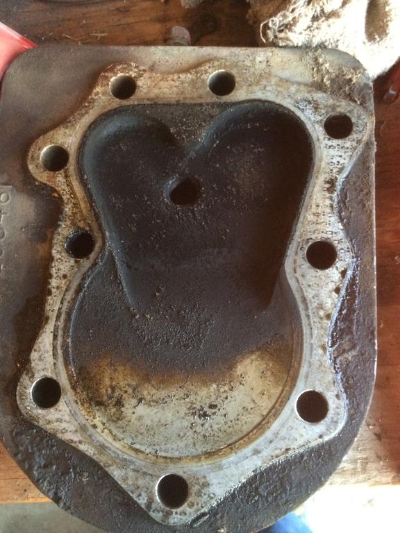

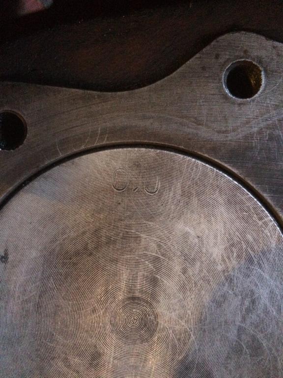

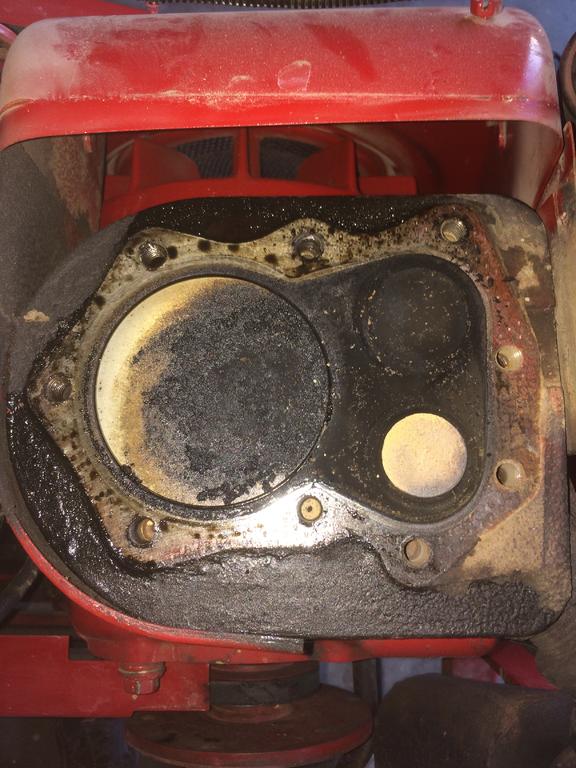

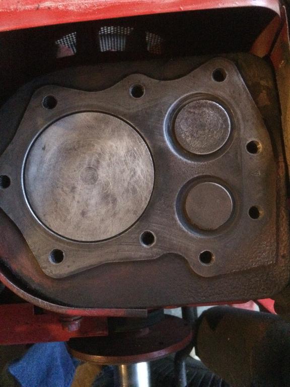

Jojoca 49 #1 Posted January 3, 2019 I finally pulled the head on my 1054. It appears to have been bored .10 over in its 50 plus years of life. It didn’t clean up too bad. The cylinder had absolutely no scratches in it. 2 Share this post Link to post Share on other sites
WHX?? 54,512 #3 Posted January 3, 2019 Looks pretty good buddy.. cleaned up real nice. Valve side of piston looks good from here. How's the bore/valves/seats look? Any smoke before you popped the head? 1 Share this post Link to post Share on other sites
The Tuul Crib 7,340 #4 Posted January 3, 2019 Looks like it may have burned some ethanol blend gas with all the carbon left behind . 1 Share this post Link to post Share on other sites
oliver2-44 11,198 #5 Posted January 3, 2019 (edited) If you have the tools now would be a good time to mic the cylinder bore top and bottom. Others may jump in here and help me, I’ve see pictures of carbon pattern and explinations of causes. If memory serves me carbon on 1/2 and not the other half of the piston could indicate some blow-by from out of roundness. Or it could just be ethanol gas as mentioned above Edited January 3, 2019 by oliver2-44 1 Share this post Link to post Share on other sites
Jojoca 49 #6 Posted January 3, 2019 I took a piece of 220gritand opened the valves and closed it till it made contact with paper and I worked it back and forth to help clean the carbon the best I could off off the valve and seats. I really want to try a mirror finish on the head to see if it will preform better I will also face the head gasket area with instructions I’ve been reading about. 1 Share this post Link to post Share on other sites
lynnmor 8,547 #7 Posted January 3, 2019 That exhaust valve was running plenty hot. I would pull the valves and do a proper valve grind, I have no idea what you meant about using sandpaper. Share this post Link to post Share on other sites

Jojoca 49 #9 Posted January 3, 2019 11 hours ago, WHX21 said: Looks pretty good buddy.. cleaned up real nice. Valve side of piston looks good from here. How's the bore/valves/seats look? Any smoke before you popped the head? It did smoke some but with the 20 or so hours I’ve ran it, it has never used oil. I’ve ran either seafoam or marvel mystery oil in the gas since I built the tractor last year. It actually ran pretty good but I noticed the head was a little wet on the pto side from the head gasket so I decided to pull it to change the gasket. I’ll try to get a spring compressor and pull carb off so I can pull the valves to clean them too. Share this post Link to post Share on other sites

Jojoca 49 #13 Posted January 4, 2019 (edited) Intake valve right within specs of 8 to 10 thousands and exhaust was at 13 and should of been between 18 and 20. With carb off I’m not seeing hardly any carbon in the intake. I sized them both correctly and milled down the head to take the warp out of it. got it all back together ready to start it until I busted a small wire off under regulator and decided to call it quits till tomorrow evening. I didn’t end up taking the valves out because I have no lapping compound so see you she runs tomorrow evening. Damn I just can’t get enough enjoyment from these tough old bastards! 😎. When I’m not working on them or with them I’m fulfilling my time on red square learning something more everyday Edited January 4, 2019 by Jojoca To add to it 3 1 Share this post Link to post Share on other sites
squonk 45,372 #15 Posted January 4, 2019 Probably some vale guide wear with that carbon build up also. Share this post Link to post Share on other sites
