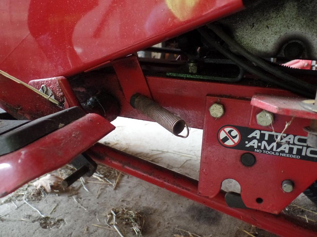

minotaur57 7 #6 Posted January 1, 2019 On 12/31/2018 at 7:21 AM, The Tool Crib said: Sounds like a spring issue check where the rod connects to see if spring is there. Could this be the spring we are talking about? 314-8 Share this post Link to post Share on other sites
The Tuul Crib 7,340 #7 Posted January 1, 2019 14 minutes ago, minotaur57 said: Could this be the spring we are talking about? 314-8 Not sure on that one . The one I'm thinking of is on the left side back by the brake Share this post Link to post Share on other sites

gwest_ca-(File Mod) 11,932 #9 Posted January 1, 2019 Number 48 is the spring for the pedal return. It hooks into arm #18. https://www.partstree.com/parts/toro/mowers-lawn-garden-tractor/21-14k801-314-8-toro-314-8-garden-tractor-1985/clutch-brake-and-speed-control-linkage/ The other end of the spring hooks into a web or brace above the left axle housing - all part of the transmission casting. This is not necessarily your tractor model. The tractor data decal should be under the left side of the seat on the rear fender pan. If it is not there post all the numbers off the engine decal including the serial number. The C-120 is a 1974-1977 model. The 314-8 is a 1985, 1993-2001 model. Garry Share this post Link to post Share on other sites
