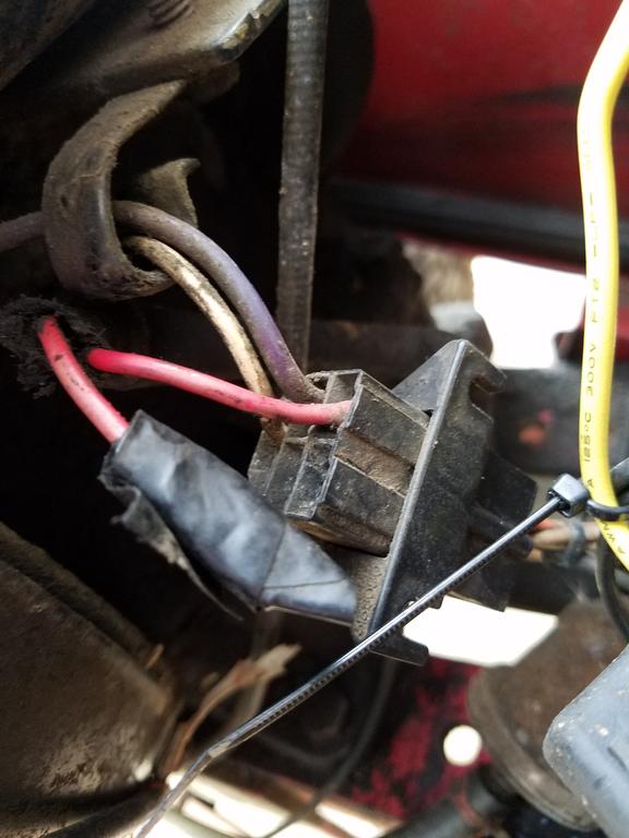

midpack 1,073 #4 Posted December 30, 2018 I swapped an M12 into a 1980 C-175. I used the whole wiring harness and key switch. I used the light panel to set up the safety switches. Biggest problem I had was with the oil level safety must not work properly (PO had a weird wire from the solenoid to the key plug he was using as a getaround) I ended up bypassing it at the harness connection. You know how to use a voltmeter? I got a lot of help from my light probe too Share this post Link to post Share on other sites

midpack 1,073 #6 Posted December 30, 2018 I'll have to take a look, it's been a couple years... lol Either made a jumper wire, or i might have just pulled that wire from the plug connector. Ill see if I can grab a pic for you later today 1 Share this post Link to post Share on other sites
midpack 1,073 #7 Posted December 30, 2018 The 2 red wires went to the oil switch on mine. I just pulled one wire out and taped it off . The pic shows the engine side of the connector Share this post Link to post Share on other sites
