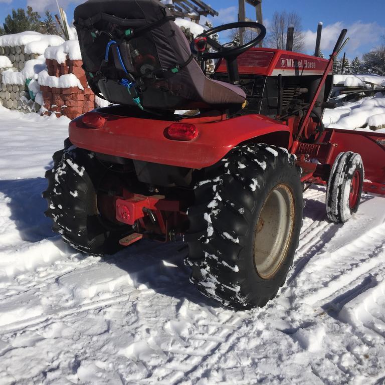

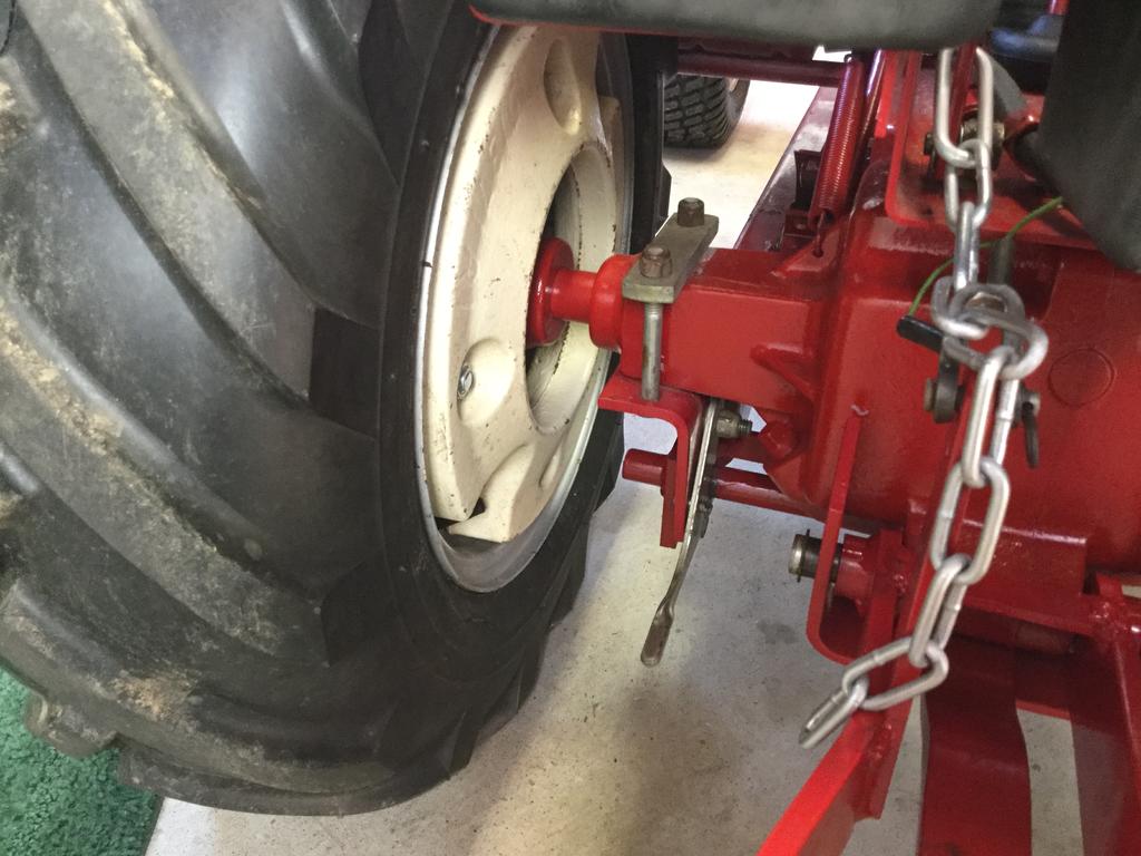

richmondred01 2,307 #1 Posted December 23, 2018 Added 52 pounds of weight to the inside of the wheels. It slipped a few times last snow and I’m thinking this will help. 7 5 Share this post Link to post Share on other sites
Lee1977 7,190 #2 Posted December 23, 2018 How much weight total in each wheel? Share this post Link to post Share on other sites
richmondred01 2,307 #3 Posted December 23, 2018 66 pounds per wheel. 132 total. Ill see how it does. I can always add an additional 50 pounds or so to the clevis hitch Share this post Link to post Share on other sites

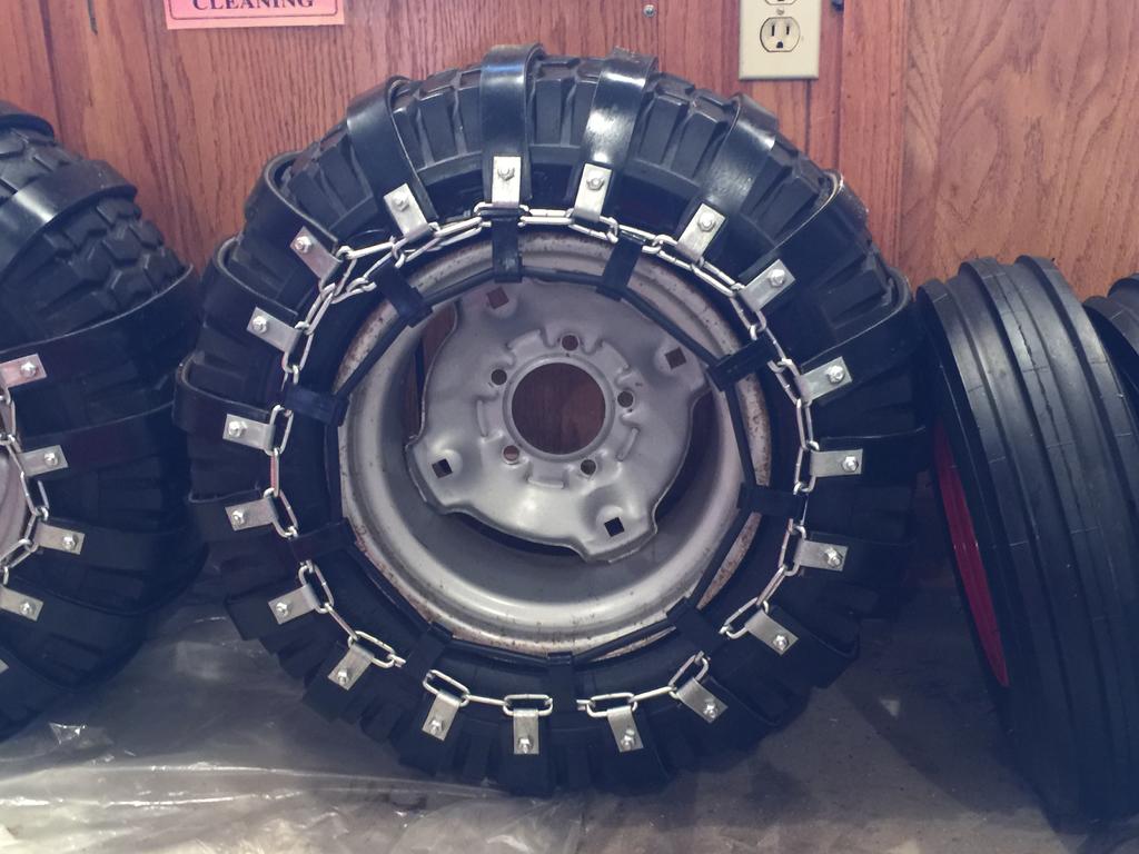

GlenPettit 1,717 #9 Posted December 24, 2018 (edited) Lug tires don't really need chains if you're careful and have lots of weight, I've added 200# per rear tire and have no problems, = just great traction. Don't forget if you add a lot of weight on the rear axle, add some to the front for steering control, (when adding # to the rear, you're lightening the front slightly). To de-rust chain, put it in a quart of white vinegar in a bucket with a quart of water (50-50%) let sit 1-2 days (in basement), then put chain in a bucket with old oil. Good Luck, Glen Another thought is Rubber Tire Chains I use them and have been very happy with the results, my first choice is Lug tire without chains, I have a long asphalt drive with slight hills. Google Amazon and look for Rubber Tire Chains, but add extra rubber cross links for a much smoother ride. Not the best on smooth ice. A product called "RIMGUARD" is what the professionals use, will not rust nor hurt the enviroment, wherever Farmers go is who has it. Filled tire prices can be all over the place so shop around, I pay about $30 for rears, $20 for fronts, total, using good tires/rims and/or tubes is smart to reduce leaks. Done right they won't leak. Regular Window Anti-Freeze can break-down chemically over the years, (the alcohol in it is what changes) . RIM-GUARD will last for decades and is completely organic (google it). Edited December 27, 2018 by GlenPettit 3 1 Share this post Link to post Share on other sites
