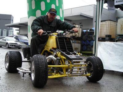

Tractorhead 9,217 #27 Posted December 23, 2018 Hi Eric, I use just use the simple phasechecker screwdriver for test purposes. Clamp the clip on sparkplug, put screwdriver tip in sparkplugcap and crank. If it illuminates, there was a spark - that simple. if engine will not start, change sparkplug and check the Timing. If it will not illuminates, measuring the coil, if it has a resistance. On each machine with petrol Engine i own i firstly change the Sparkplug and filters and Oil first. That's my main issue. When i calculated a tester, i can buy a lot of Sparkplugs instead. With this method i have best and quickest experiences. cleaning a sparkplug, hum yes- can be done, but you will never be sure if sparkplug works under thermal issues right. pressure? yes this can be simulated, but not Thermal issues. My Waterloo i got about 20year 's back On Racetracks with my Quadbike. I driven Short track and MX freestyle with it. To improove the Ignition, i got a free programmable ignition system by Ignitech. i try to find best ignition timing and labda on a dyno with a oxygen sensor in exhaust. but dyno was only a short term issue instead Racing. The Engine get never the same thermal burden as in Racing. On the Dyno, the Engine shows impressive results. The engine seems it looses only sometimes Power in Racing condition, if i pull throttle fully when engine gots warm. It was so frustrating, on training everything seems right, but in real Racing conditions i sometimes got lots of trouble. Only sometimes loss power in Full throttle passages. After i had some troubleshooting with change ignition, setup different ignitionsetups, clean and setting up carb, change and setup on acceleration pump, even a complete Enginehead rework, checking Valves Valvesetting and some other stuff, The last issue was the Sparkplug. I can not Imagine, that a simple Sparkplug can made this trouble, so i changed it and lateron i never had this issue on this Engine while Racing. It wastes me lot of energy to find out, what was happen, even Sparkplug allway's looks pretty and Service on Sparkplug was allway's in time. All Values on Sparkplug was right- heat value, type, face of Sparkplug, but i have several Sparkplugs they loosing their reliability in short periodes while Racing. Yes, i know, a tractor is not a Racing Engine, but my experiences Show's me others. So i simply shorten the periodes to change sparkplugs and things running nice and smoothly and even my lap times improoves. After this experiences i don't wasting time, to check and clean a Sparkplug, i just exchange it. Merry Christmas to you Just my 2 cent 1 Share this post Link to post Share on other sites
