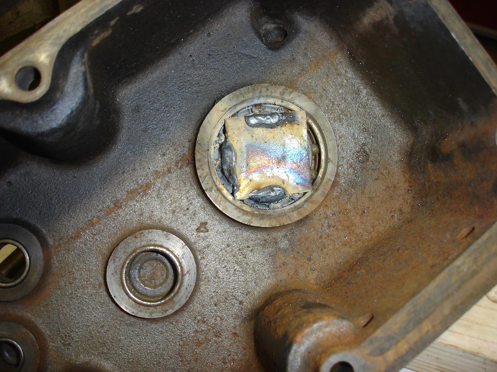

Marv 992 #8 Posted December 22, 2018 Here is a drastic way in that it destroys the bearing. If it is already bad it doesn't matter. With the plate welded on you can drive the bearing from the axle side. Marv 2 Share this post Link to post Share on other sites

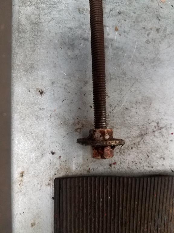

Shynon 7,492 #9 Posted December 23, 2018 (edited) I use a piece of threaded rod with a washer bolted on the end, with the outer bearing removed insert the washer end down the axle tube. Insert the washer in the gap behind the bearing and hammer on the end of the threaded rod sticking out the axle tube. Edited December 23, 2018 by Shynon 4 Share this post Link to post Share on other sites

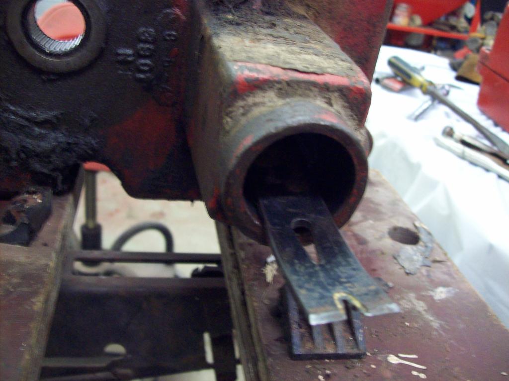

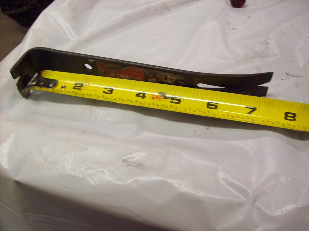

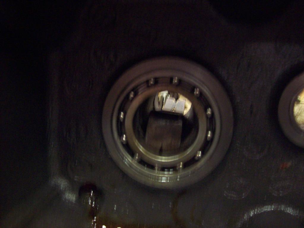

953 nut 62,639 #10 Posted December 24, 2018 (edited) On 12/22/2018 at 6:18 AM, 953 nut said: I have had good results using a small pry bar ( five of six inches long). Insert the tool from the outside of the case with the bent end behind the bearing, use a screw driver handle to hold it in place. Once it is secure give a light tap with a hammer on the end that is protruding from the axle hole. Rotate it an repeat, usually takes two or three taps and the bearing is out. While I was in the shop this afternoon I took some pictures so you can see how the small pry bar works. the one I use is 7"long. Insert the pry bar into the axle opening with the bent end inside and behind the 1533 bearing. I use a screw driver to hold the pry bar down in the groove behind the bearing, left it out so you could see the pry bar. Give the portion of the bar that protrudes from the axle opening a light blow then rotate it 90* and give it another light blow. I have had some come out with one hit, some take two or three, but you are not hitting it hard. Hope this helps. Edited December 24, 2018 by 953 nut 2 1 Share this post Link to post Share on other sites
