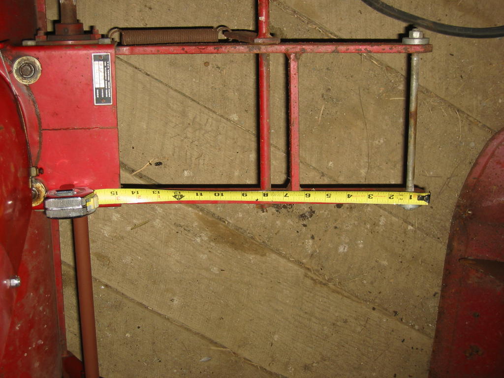

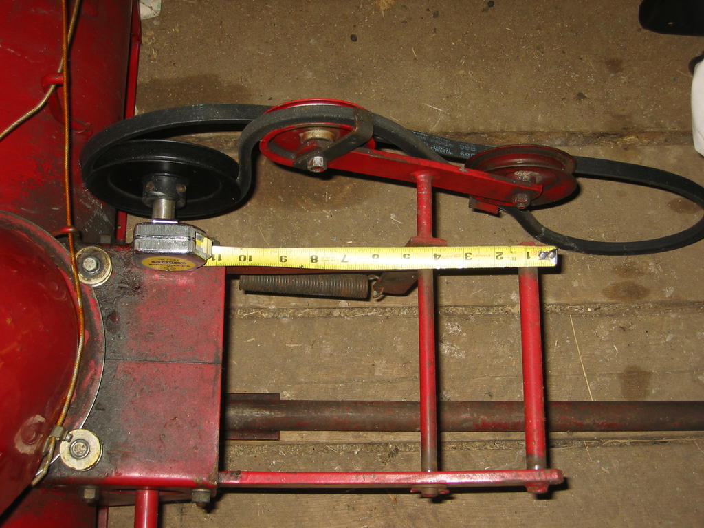

pfrederi 19,952 #2 Posted December 19, 2018 Biggest difference is the mounting frame. The older style was longer as it was bolted through the tractor frame. Easiest way would be to pick up a new frame and use it. It will mount tot eh blower body no problem. Or you could try shortening your frame and welding in a new cross piece for the tachmatic. but the rectangular cross piece in the old style may be in the way.. First picture is older frame mount second is for tachmatic 1 2 Share this post Link to post Share on other sites

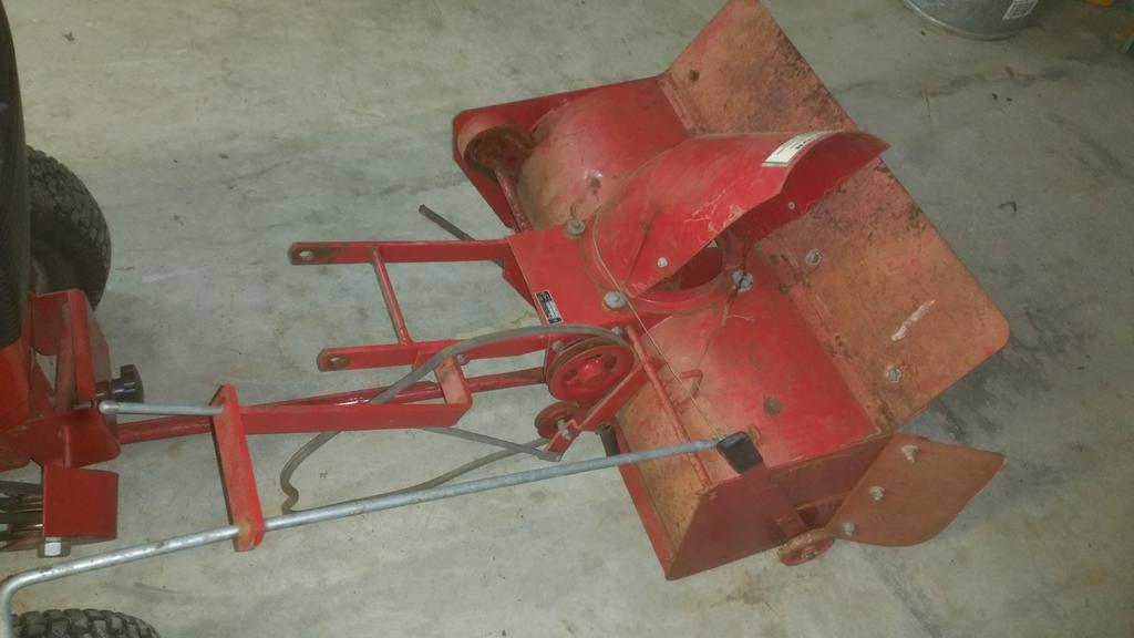

Ed Kennell 45,029 #3 Posted December 19, 2018 I mounted one on a C-160. I used the 3/8" long bolt and the existing holes in the tractor frame not using the tach-a-matic.. I did have to trim a corner off the tach-matic to get it to clear the flat bar on the blower frame. 2 1 Share this post Link to post Share on other sites

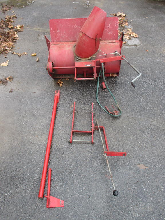

Ed Kennell 45,029 #5 Posted December 22, 2018 Is this your blower? 1 Share this post Link to post Share on other sites
Ed Kennell 45,029 #7 Posted December 22, 2018 Sorry, this is not the blower I installed on the C-160. You can try reversing the drive pulley, but it appears you may need to lengthen the drive shaft. You will also need to alter the belt tensioning pulley. 1 Share this post Link to post Share on other sites
