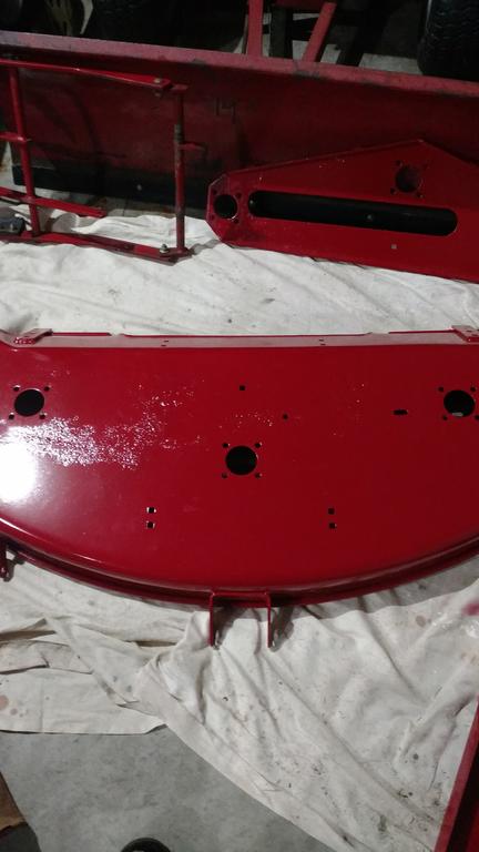

608KEB 812 #1 Posted December 13, 2018 (edited) I'm putting together my 48" mower deck. I was looking for a few opinions on a idea I have. I wanted to try a 30 year caulk between the deck and the support plate. Caulk around the outside edge and the spindle openings. Has anyone tried this with success? If you look at the deck. You can see all the pitting that is underneath the support plate. The deck was bead blasted and painted with a gun. Edited December 15, 2018 by 608KEB Share this post Link to post Share on other sites

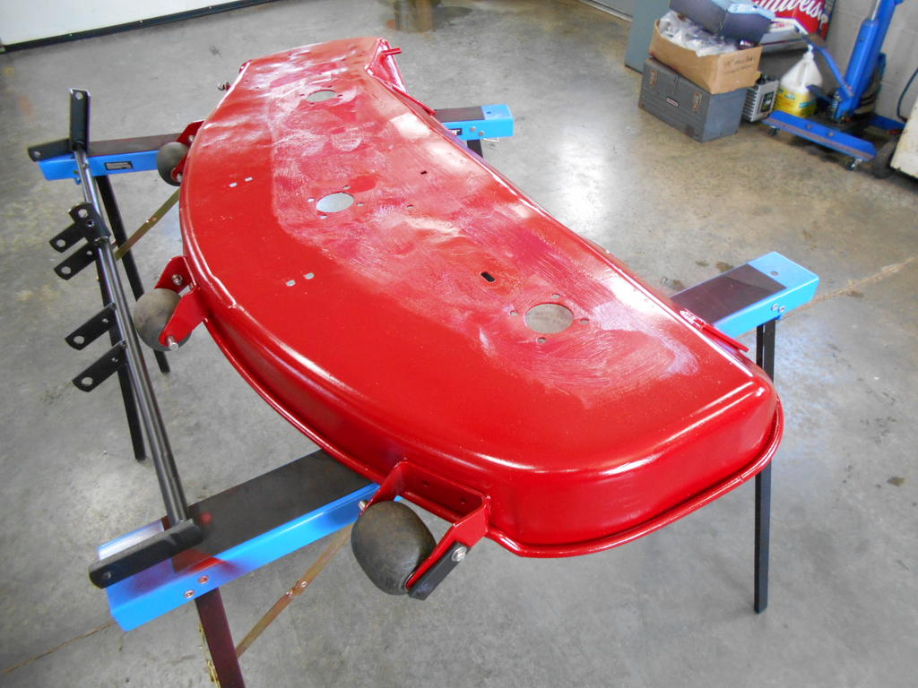

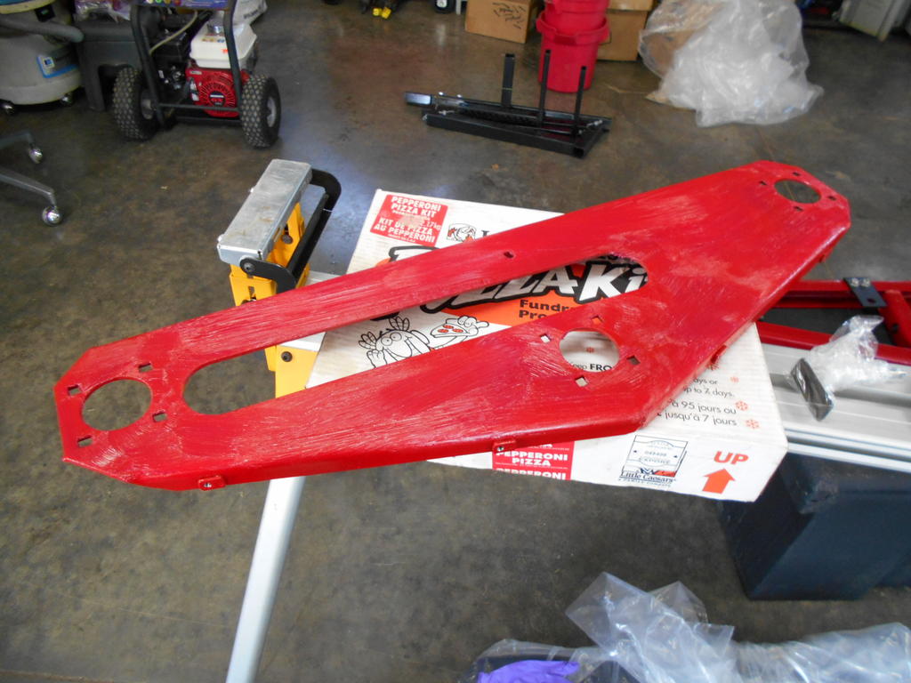

608KEB 812 #5 Posted December 13, 2018 I'm going to try silicone caulk. I'll post a couple pictures. It should flex somewhat. 1 Share this post Link to post Share on other sites
