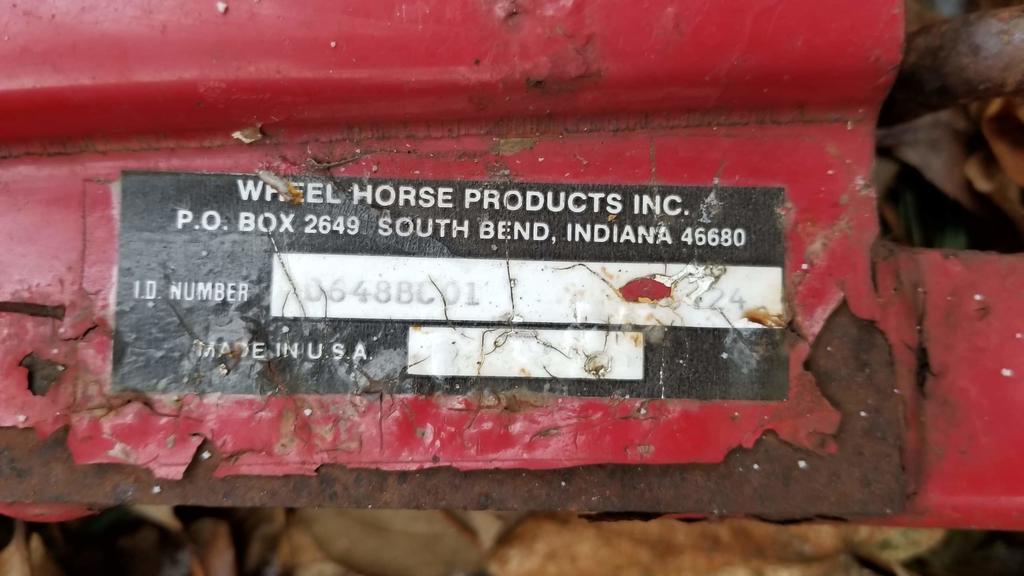

Mike harris 5 #1 Posted December 11, 2018 With these numbers can anyone please tell me if this is a long frame plow. Searching hard for a plow I find them then am not sure what is what. Thank you in advance. Share this post Link to post Share on other sites
oldredrider 2,553 #2 Posted December 11, 2018 That's a 48" plow that WILL fit your C-100. The "BC" in the model # is the clue. Fits both B and C models. 1 Share this post Link to post Share on other sites
Mike harris 5 #3 Posted December 11, 2018 Thank you. I honestly did not see the"B". Thought it was another 8. Love wheel horses just dont have enough experience with them yet. 1 Share this post Link to post Share on other sites

Ed Kennell 45,029 #5 Posted December 11, 2018 Hey Mike, If the rear half of the frame rails are parallel, it is a long frame, if it is Vee shaped from the front to the rear axle, it is a short frame. 3 Share this post Link to post Share on other sites
