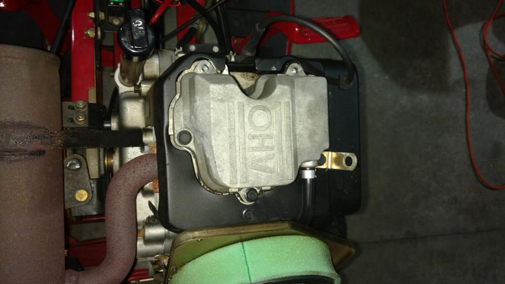

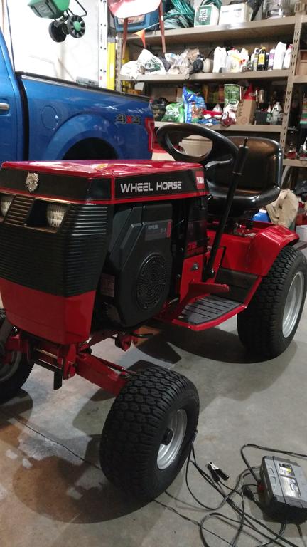

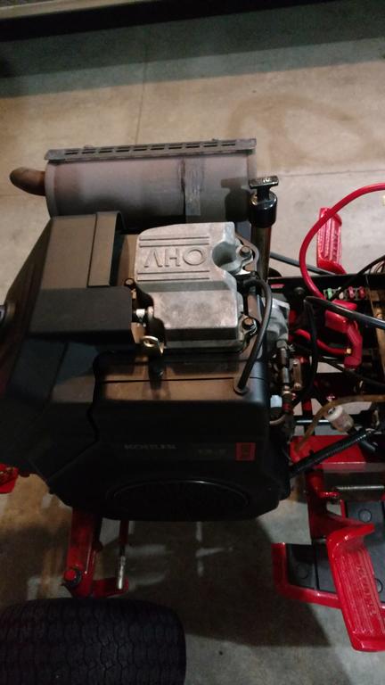

608KEB 797 #1 Posted December 7, 2018 I'm looking at my Dad's 99 312-8 for some reason the compression valve is sticking. I have to remove the spark plug to release the pressure. Then it will start. Where is the compression valve on this tractor? I know very little about a OHV motor. Share this post Link to post Share on other sites
WHX?? 52,896 #2 Posted December 7, 2018 I would start by popping off the valve cover and checking the tappet clearances. Should be done every so often anyway. Specs should be in the manual. Not an expert on this motor but I don't think there is a comp. release on these. I do know a fine looking when I see one tho! I would love to put one of those engines in a 520 chassis. 2 Share this post Link to post Share on other sites

608KEB 797 #5 Posted December 8, 2018 22 hours ago, WHX21 said: I would start by popping off the valve cover and checking the tappet clearances. Should be done every so often anyway. Specs should be in the manual. Not an expert on this motor but I don't think there is a comp. release on these. I do know a fine looking when I see one tho! I would love to put one of those engines in a 520 chassis. You'd put one of those Kohler Command engines in a 520-H chassis? I had to pick the 312-8 up in Gailon Ohio. About a year ago. Low hour machine. But a few minor issues now. My Dad is 82. He can fix things. But this was a little beyond what he could do. Share this post Link to post Share on other sites

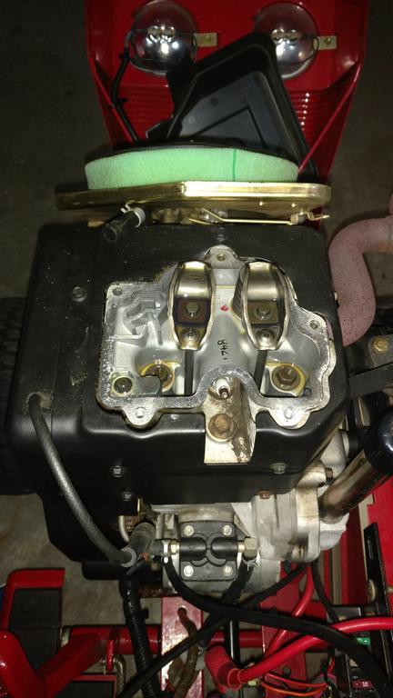

608KEB 797 #6 Posted December 9, 2018 (edited) I have the valve cover off. What's next? Remove the rocker arms that are on top of the valves? I downloaded the engine manual. Intake should be set at .0030. Exhaust should be set at .0035. I'm assuming the exhaust valve is the one near the muffler. Edited December 9, 2018 by 608KEB Share this post Link to post Share on other sites
lynnmor 8,076 #7 Posted December 9, 2018 Apparently you have hydraulic lifters, no adjustment is required. Share this post Link to post Share on other sites

rmaynard 16,576 #13 Posted December 9, 2018 Before going to a lot of trouble, just test the ACR. Since you have the valve cover off and can see the valve stems & rockers, rotate the engine until it is about to enter the compression stroke. You will notice that the exhaust valve will open and close slightly as the compression stroke begins. If it doesn't, then you can safely assume that there is something amiss with the ACR. 2 1 Share this post Link to post Share on other sites
608KEB 797 #14 Posted December 9, 2018 (edited) On 12/9/2018 at 7:20 AM, rmaynard said: Before going to a lot of trouble, just test the ACR. Since you have the valve cover off and can see the valve stems & rockers, rotate the engine until it is about to enter the compression stroke. You will notice that the exhaust valve will open and close slightly as the compression stroke begins. If it doesn't, then you can safely assume that there is something amiss with the ACR. It looks like the exhaust valve is moving fully up and down. If the ACR is not working. Does this mean I have to disassemble the engine? Silly question, but thats what it looks like. Edited December 11, 2018 by 608KEB Share this post Link to post Share on other sites
rmaynard 16,576 #15 Posted December 9, 2018 The exhaust valve should move fully up and down on the exhaust stroke. However, we are talking about only the compression stroke where it should open and close just slightly at the beginning of the stroke. Yes, the engine will have to be at least partially disassembled to repair an ACR. Share this post Link to post Share on other sites

rmaynard 16,576 #17 Posted December 9, 2018 1 minute ago, 608KEB said: I apologise for my lack of knowledge. Where should I look? The intake valve? Exhaust valve. What you have is a 4-stroke engine. Every complete revolution is a "stroke". First stroke is intake. Intake valve opens, exhaust valve is closed, the piston goes down and gas/air mix is pulled in. Next stroke is compression. Both intake and exhaust valves are fully closed and the piston starts moving up compressing the gas/air mix. If you have an ACR, this stroke is where the exhaust valve opens slightly at the beginning of the stroke, then closes quickly as the piston goes up, compressing the mix. Third stroke is where the spark ignites the fuel/air mix and forces the piston back down. Fourth stroke is exhaust where the exhaust valve opens and the rising piston forces the burned exhaust gases out. Then the cycle starts all over again. As soon as the engine reaches between 600-700 rpm, the ACR mechanism disengages, full compression is realized, and the engine runs. 1 Share this post Link to post Share on other sites

608KEB 797 #21 Posted December 10, 2018 10 hours ago, rmaynard said: The exhaust valve should move fully up and down on the exhaust stroke. However, we are talking about only the compression stroke where it should open and close just slightly at the beginning of the stroke. Yes, the engine will have to be at least partially disassembled to repair an ACR. The ACR is not working. I will have to take motor apart to get to it. 1 Share this post Link to post Share on other sites
