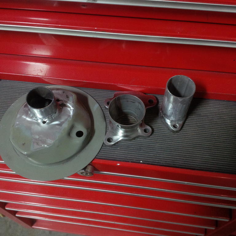

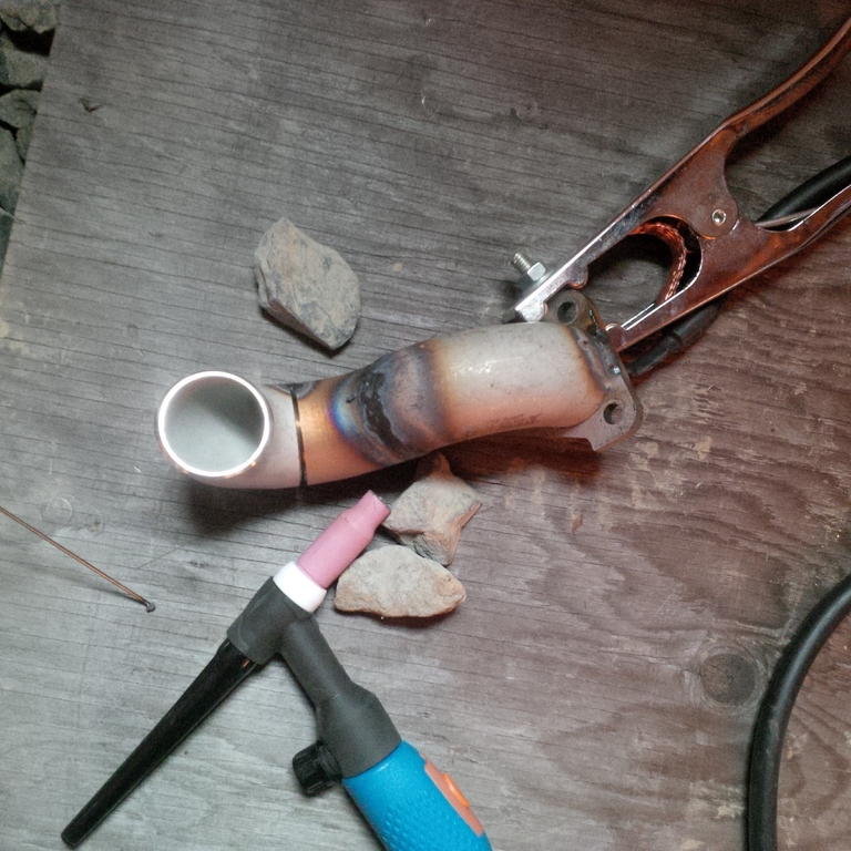

fast88pu 3,377 #26 Posted December 30, 2018 I started to tig weld up the exhaust manifold today till I ran out of gas lol. 2 Share this post Link to post Share on other sites

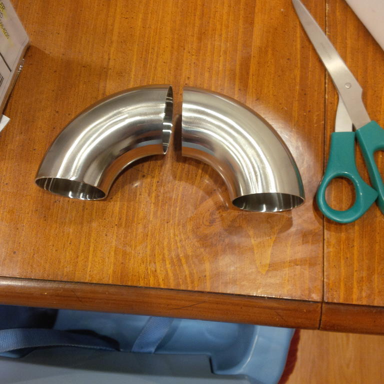

Sarge 3,471 #29 Posted December 31, 2018 What metal tubing? Looks like you need to build a back purge setup - I use a CGA 580 tee fitting on the tank, two flow meters and run about 3-5cfm for the purge line. Just converted a spare 25' long gas hose to work with 1/8"NPT fittings, a small ball valve to turn it off/on and a copper tube in 1/4" to supply gas into hollow objects to prevent sugaring/crystallization on the back side of the weld - made a huge difference. I have guys bring motorcycle pipes over and stainless parts that need the purge to prevent the stainless from sugaring and turning to garbage once heated, glad I finally got it done and use it a lot more often than expected. Helps a lot with aluminum parts as well around here. Interesting to see what we're building here, lol. Sarge 1 Share this post Link to post Share on other sites
fast88pu 3,377 #30 Posted December 31, 2018 5 minutes ago, Sarge said: What metal tubing? Looks like you need to build a back purge setup - I use a CGA 580 tee fitting on the tank, two flow meters and run about 3-5cfm for the purge line. Just converted a spare 25' long gas hose to work with 1/8"NPT fittings, a small ball valve to turn it off/on and a copper tube in 1/4" to supply gas into hollow objects to prevent sugaring/crystallization on the back side of the weld - made a huge difference. I have guys bring motorcycle pipes over and stainless parts that need the purge to prevent the stainless from sugaring and turning to garbage once heated, glad I finally got it done and use it a lot more often than expected. Helps a lot with aluminum parts as well around here. Interesting to see what we're building here, lol. Sarge What's a good starting flow for gas? Share this post Link to post Share on other sites
Sarge 3,471 #31 Posted January 1, 2019 All gas settings go by torch size, nozzle and whether you're using a gas lens or the standard tips with just the holes in them. On some of my gas lens (Furick) setups due to the size (14) they require right at 30cfm to the torch. Purging goes by the volume size of the part to be welded and fit-up tolerances. Remember, argon is heavier than air so it's wise to feed the argon downhill into a hollow part. Also, on some tubing you are better off closing up both ends, feeding the gas into the lowest portion on one side and make a slit to vent any back pressure and oxygen out the other end at the highest point. Using these practices removes the contaminated air inside the part, especially the oxygen. Stainless parts get really picky about gas coverage, that's why you see the trend towards some truly huge gas lens nozzles to better distribute the argon across the entire heat zone - this also prevents embrittlement and discoloration issues. It also helps to increase pre-flow at times, some machines have an adjustment for it (my Dynasty uses a hidden menu) but on machines that are not equipped that way you can just cycle the gas solenoid by tapping the pedal/rotary control to start the gas cycle. If you haven't used or seen them, Michael Furick makes some of the best gas lens setups on the market. They are not cheap, but the gas coverage plume design works far better than anyone else's making right now. He has his available in lab grade boron silicate glass or ceramic. Most are made for strictly DC work due to the screen design inside and all parts are available as wear items. He does have some glass units that can work on AC as well. https://furickcup.com/ Best torches and parts I've found for the money are the CK Worldwide brand. I run a FL-1525 torch most of the time or one of their 17 series air cooled flex heads, very durable and both have withstood close to 200 amps being pushed through them to the point I couldn't stand to the hold onto the thing. The Flex-Loc torch design is one of the best inventions that the tig process has had in a very long time, now others are trying to copy it with their own versions. The SuperFlex cables are amazingly supple yet very tough - I don't even run a protective cover on mine and they drug around the shop through all the sharp debris with no damage. http://www.ckworldwide.com/ This is the torch I use the most - that knob can lock the head into any position you want, at any angle - http://www.ckworldwide.com/130-150-amps-flex-loc™.html https://youtu.be/6coVTVgpqLA I can get some pics of the purge setup if you like. Sarge Share this post Link to post Share on other sites

fast88pu 3,377 #35 Posted January 13, 2019 Made up more flanges friday and more pieces too 1 Share this post Link to post Share on other sites

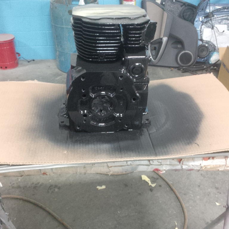

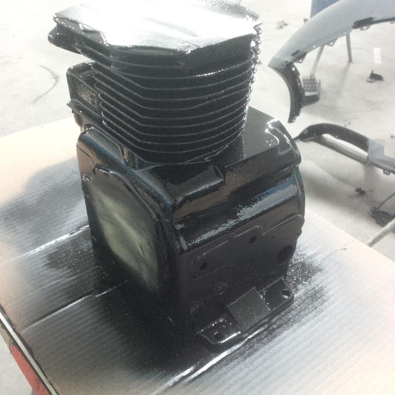

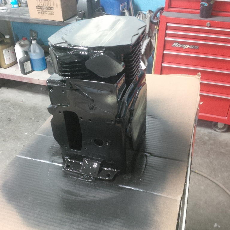

fast88pu 3,377 #37 Posted January 29, 2019 Some paint 2 Share this post Link to post Share on other sites

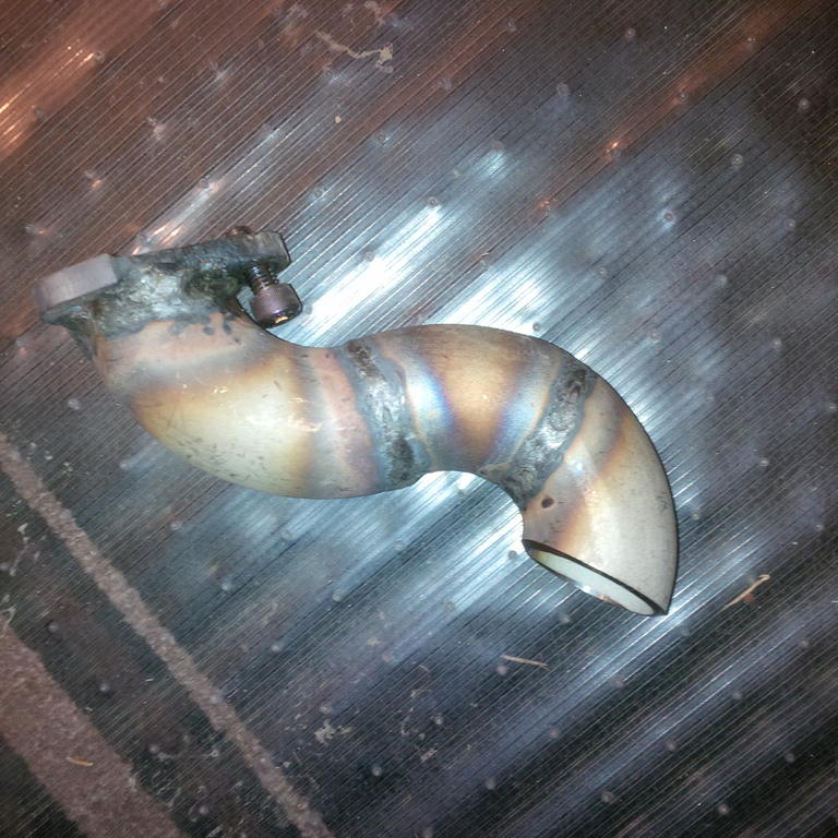

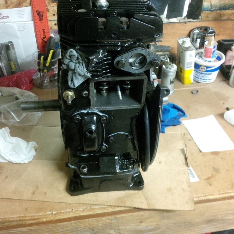

fast88pu 3,377 #39 Posted February 10, 2019 Almost complete now. 4 Share this post Link to post Share on other sites
