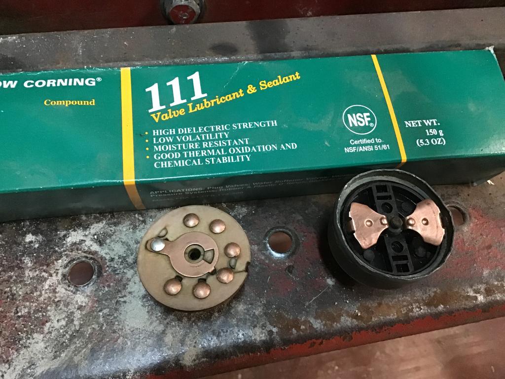

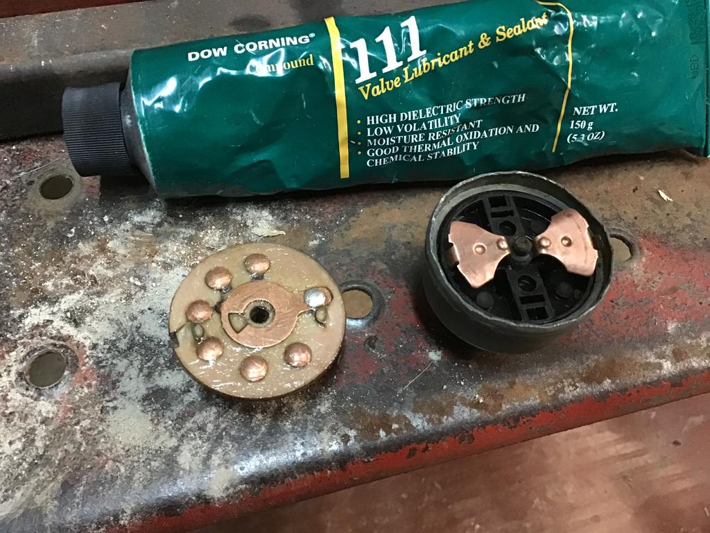

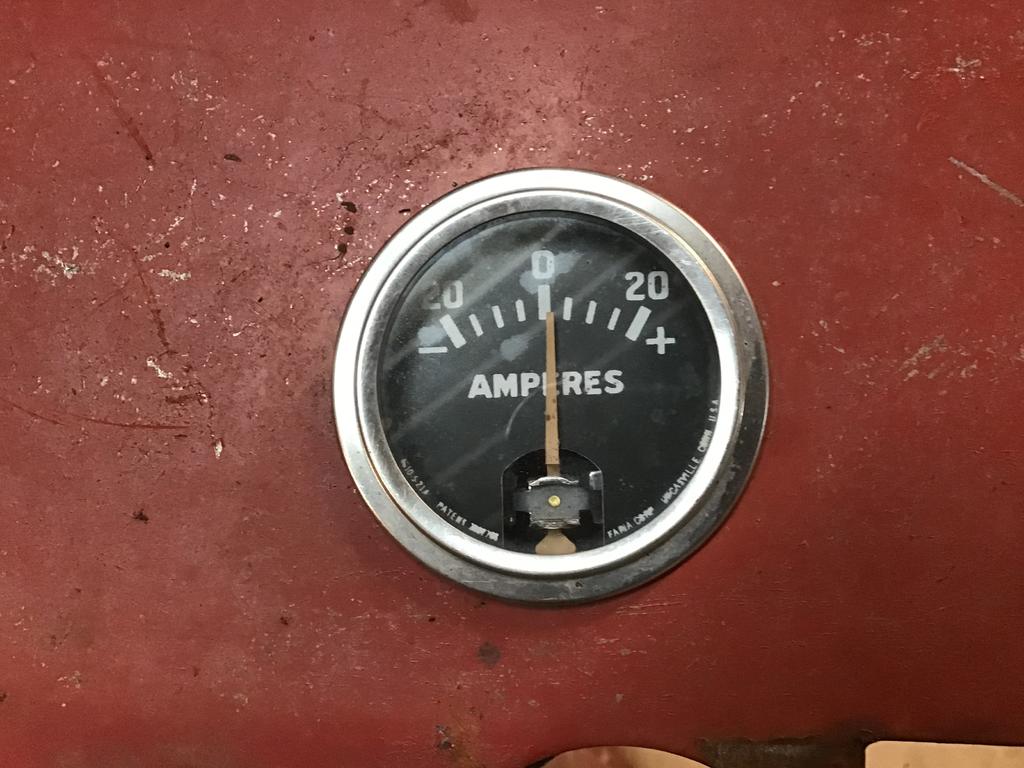

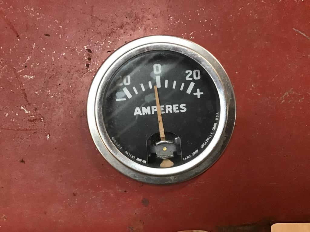

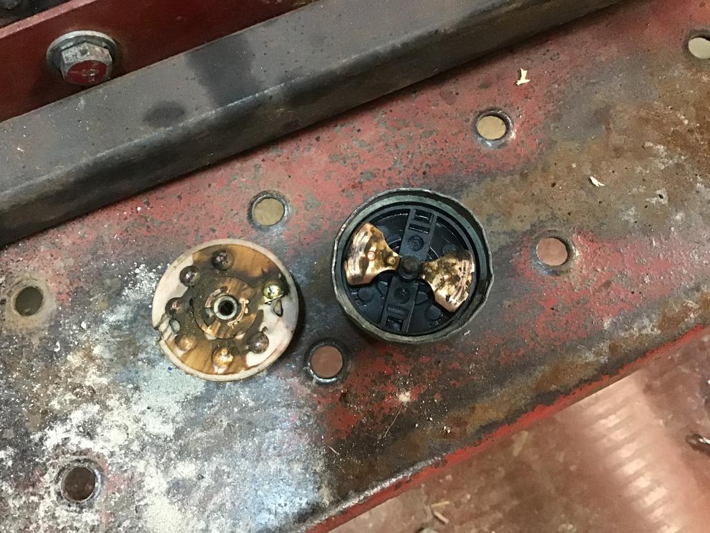

Pullstart 68,790 #1 Posted December 5, 2018 (edited) I thought for reference, I’d toss this in the electrical section. I was having issues loosing power at the coil in the run position, but it had power in the start position. I used some channel locks and pulled apart the swedge flange and this is what I found. some brake clean and a wire brush cleaned the brass parts up well! a little dielectric grease applied and using the ammeter, I was able to prove that I had power to the coil once again! ignition off ignition on, engine off. You can see a draw from the coil. After peening the flange back down, I was able to run Frank for a short while! then it would not start again... and this is where I forgot to take pictures, but I pulled it apart again and found a ton of debris from the plastic tumbler had come off and contaminated the grease. I pulled the plastic and found more springs and decent balls. I’m just going to say that after cleaning all the junk out, grease the springs, put greased detent ball bearings on the springs, and re-assemble with the aluminum casting up nd the components underneath. It keeps it all aligned much better. Then re-assemble the switch portion. Happy Frank! Edited December 5, 2018 by pullstart Auto correct.... auto wrong’d 7 4 2 Share this post Link to post Share on other sites

Lane Ranger 11,750 #4 Posted December 5, 2018 Not all are able to be saved. The internal rivets come apart, the plastic does fail, parts wear down . But a good primer on rebuilding a switch. 1 1 Share this post Link to post Share on other sites
