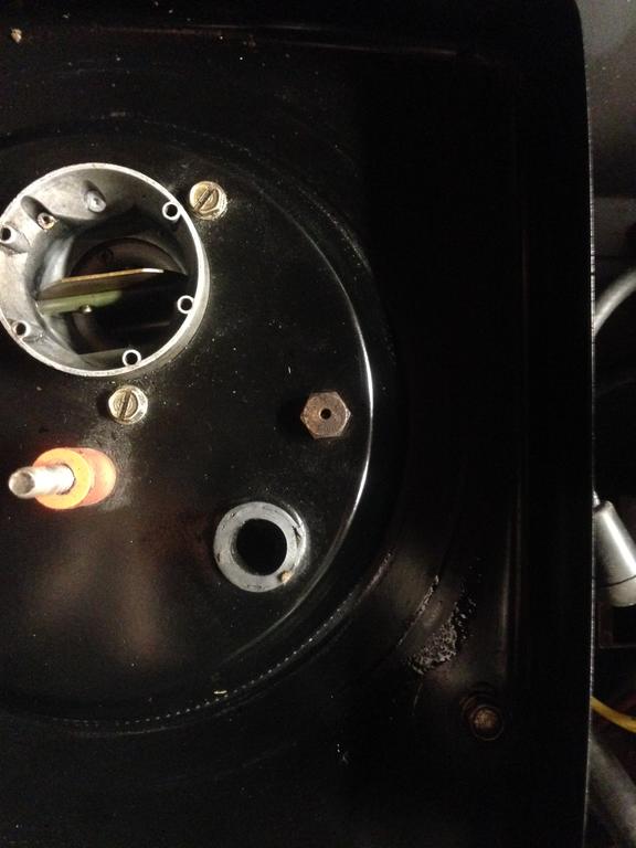

What is this supposed to be connected to?
formariz
On my 520H I have this brass fitting in the air cleaner.It has a barbed end on the other side. Saw it in service manual with a small hose attached to it, but it does not tell me what to attach it to. I cant see where to connect it to. :confusion-confused:

I think it goes to the air filter for some kind of sensor

A 5/32" vacuum hose is connected to a switch mounted behind the instrument panel next to the battery.  When the air filter becomes restricted with dirt, the vacuum increases and the switch turns the warning light on.  Often the switch has the hose connection broken off.  Restore the system or cap the fitting to prevent dirt from being drawn inside.  Switches are available here, currently the website is being updated.  I have repaired switches with a custom made aluminum adapter.

Thank you. Will be looking for switch momentarily.
WHX??
On all three of my 520's none ever worked and I doubt they ever will as I regularly service the filters. Two have the hose nipple broken off so Lynn is correct. Even tried to epoxy them back on but the switch was shot. I can see the thinking behind them tho the way those Onan's inhale air and grass clippings.

I only had the warning light one time on one tractor.  The paper filter was clogged with fine dust that got thru the pre-filter.  I too, service the air filters often and was surprised that air flow was restricted so much on a filter that didn't look too bad.  Only by holding the filter up to a light and comparing to a new one was the extent of dirt loading apparent.
